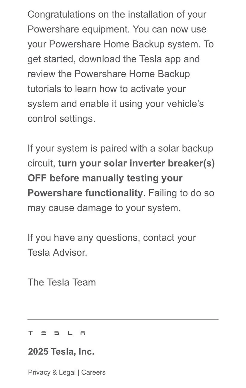

Update, just got this email and I see it in the truck options even though gateway install was about 7 months ago but haven’t had the guts to try it yet.

I got the same email today. I had it installed about 9 months ago by Tesla Energy and it worked. Then I got non-Tesla solar installed and no longer worked and no longer showed up in the Cybertruck. But now it is in the app and back in my truck. Chicken also to try as I am going out of town tomorrow. Do you still have the “go off grid” in the app? If so, where do you see it? Also when you added with the QR code what showed up in the app? Thx

I didn’t get anything in the app until I plugged in the truck to charge it, then I got a tutorial link and now I see it under Control's
