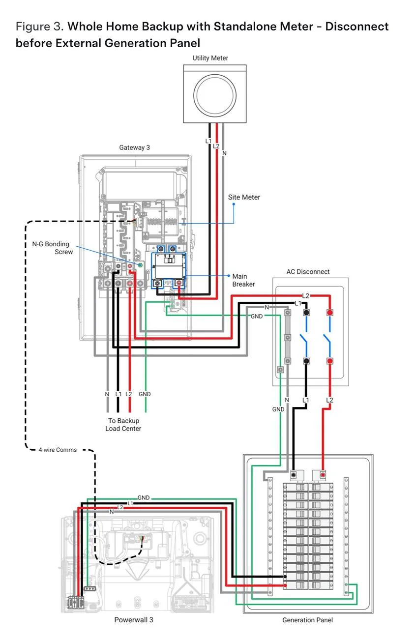

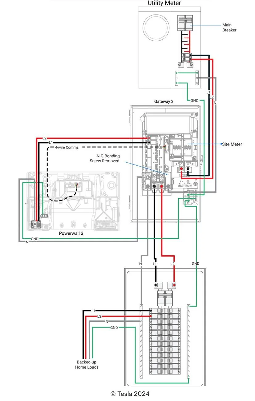

It should be possible to connect via a subpanel on the feed through lugs. Either for generation or to feed your existing house panel.
Unless the issue is a local code requirement (Maryland doesn't allow full house off Powershsre, for instance)
Gateway 3, but basically the same thing as 3V.
https://energylibrary.tesla.com/doc...UID-D100084C-11F5-4EA0-BC1F-53EF5F367AD9.html
Tesla Cybertruck PowerShare Gateway Not Compatible with Solar yet!? SmartSelect_20241228_073832_Firefox
Tesla Cybertruck PowerShare Gateway Not Compatible with Solar yet!? SmartSelect_20241228_073350_Firefox
