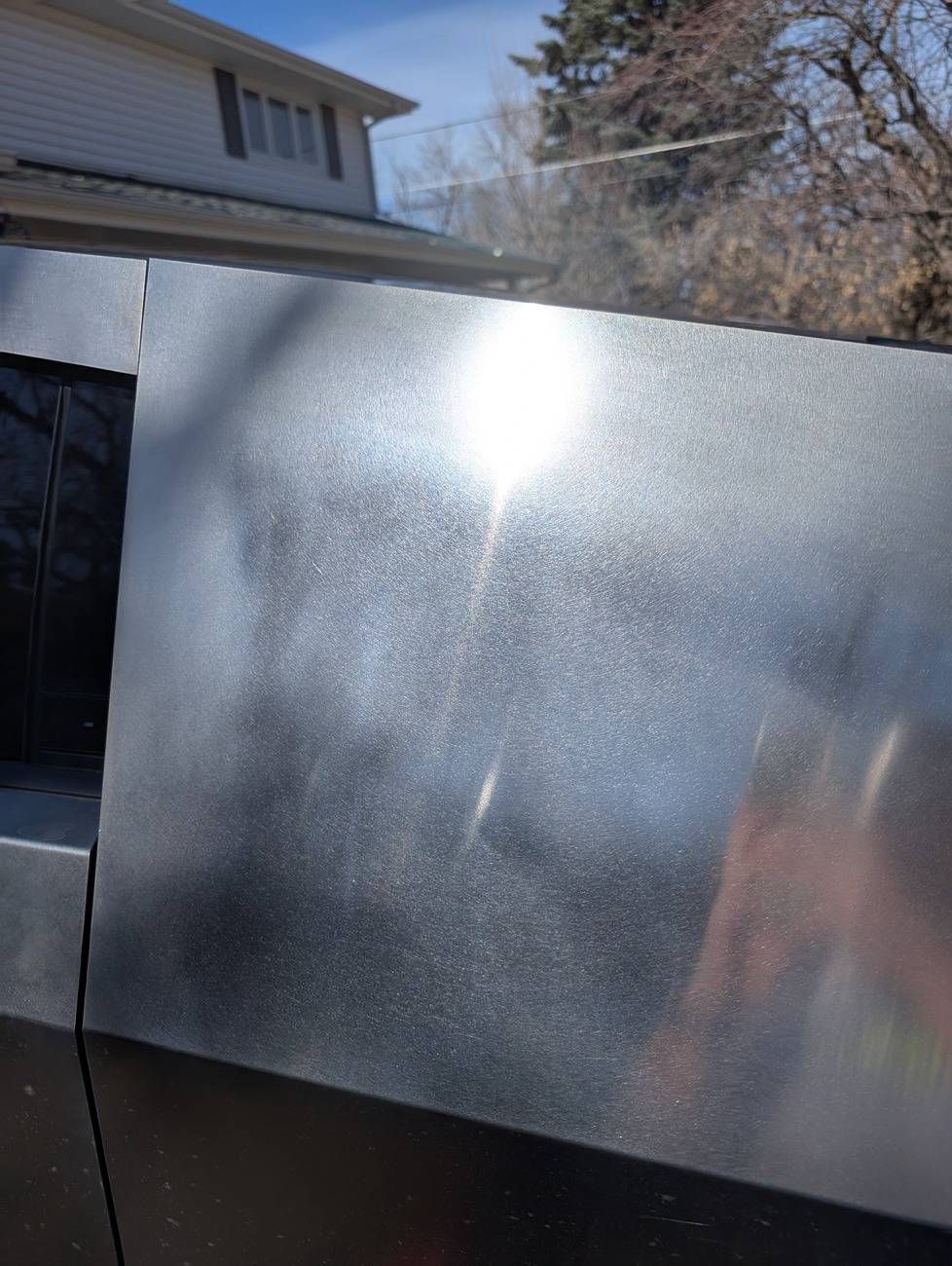

Not perfect but better than it was
The fact that a little Maguires scratch remover worked on Cybersteel shows just how hard it is to make a deep scratch on it. Especially if the implement being used is just a key. But you can take almost anything out easily with the right abrasive pads. I use these in 320 and 800 grit :
Festool 150mm (6") Vlies Abrasives - Lee Valley Tools
If I managed to get a really deep scratch I would use 100 grit to start, but that would be unusual and I've never needed that.
These also work really well and give a beautiful luster that just glows:
Grit Abrasives D150 S400 PL/15 Platin
Use the 400 and/or 500 grits. These are a foam backed fast cutting silicon carbide abrasive (harder and more uniform than aluminum oxide abrasives) that are very finely graded for a uniform appearance (without the big obvious 5mm diameter circular scratches of the factory finish). Don't go finer than 500 grit unless you want to start getting into a polished mirror finish.
The 400-500 grit Platin pads leave a beautifully even satin luster.
Whatever you use, the results will be best if you use dust extraction on the tool to keep the work area clean of loose abrasives. Cleanliness is important for an even appearance. Tesla instructs to wipe the surface with isopropyl alcohol-soaked rag between passes.
A good strategy for very light scratches as in the above video would be to do one or two passes with the 320 grit vlies (another word for "fleece") and then move to the 400 grit Platin and call it good. But it really depends upon the look you like the most. The number of passes with the 320 grit (or even the 100 grit) should be determined by how deep any surface imperfections are.

Get some "White Diamond" metal polish to remove it if your still seeing marks. Sucks, but, maybe you can identify her through social media in your area.
I don't recommend that for two reasons:
1) The abrasives are too fine, shinier spots will be left wherever you polish it.
2) It has a built-in sealant. The even sheen of the Cybertruck is easier to maintain without contaminants on the surface.
The metal likes to be exposed to the air and water. Just abrade the finish you want and then maintain it with regular soap and water washing and rinsing. It's not fragile at all, but it does look best if you keep oils and other contaminants washed off.

A masked they/them decided to try and key a swastika into the drivers side sail of my Cybertruck. I didn't notice until I went to wash the truck and was able to go back and find the sentry footage. Thankfully the steel is hard enough that it barely scratched it. I was able to buff it out. What is wrong with people?
Looks better!
