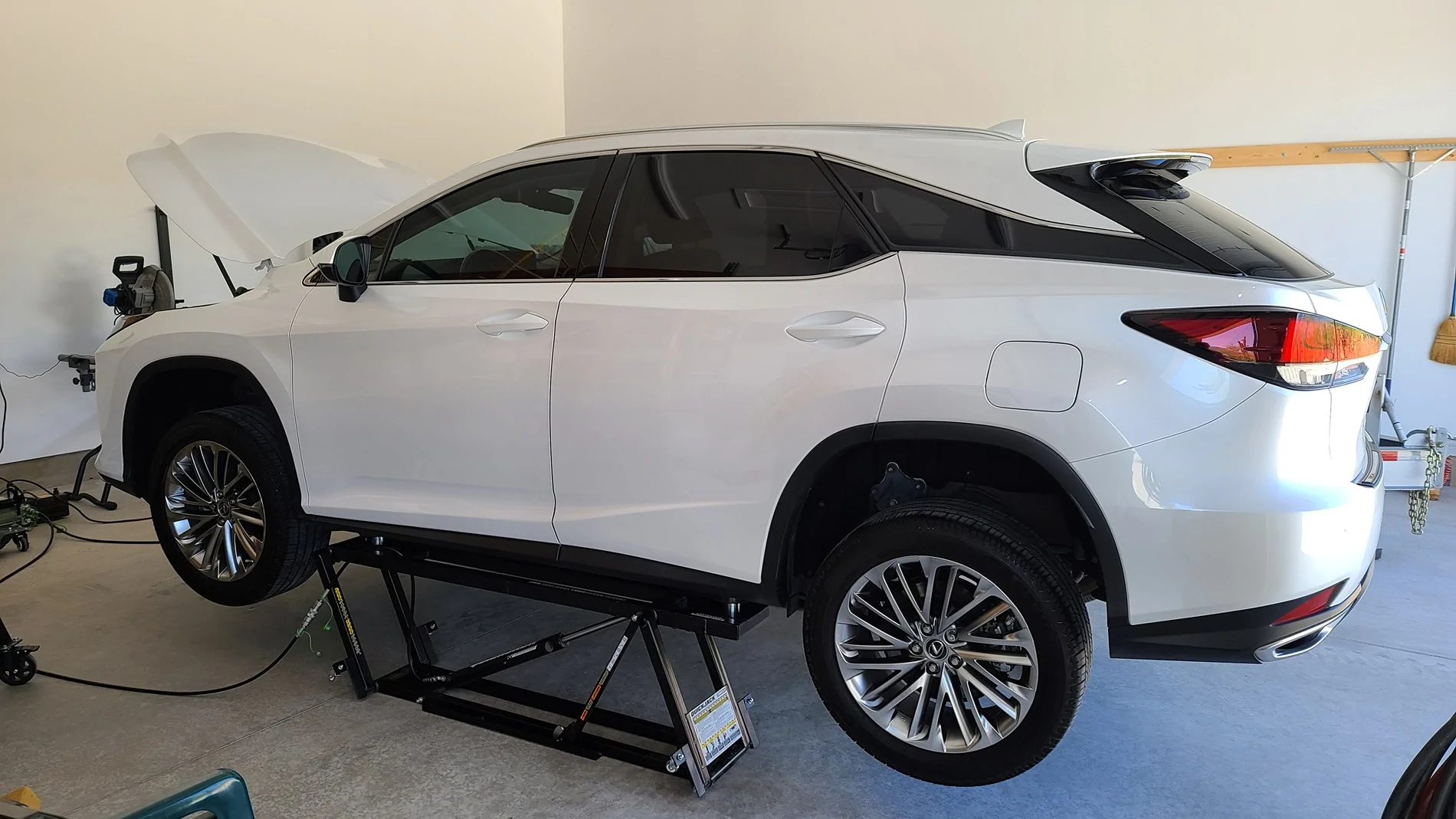

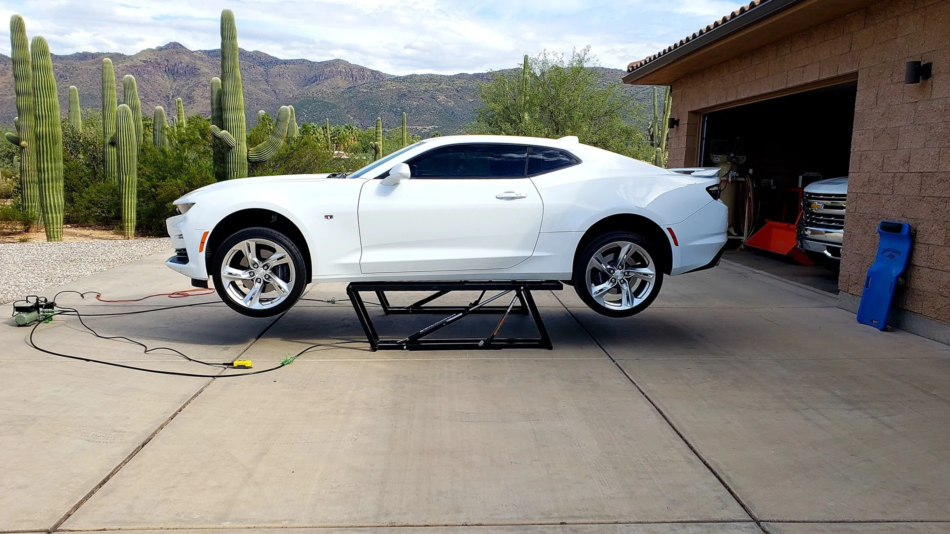

I had the 7000 lbs extra long version. I needed them for a Camaro 2021 2SS since I didn't want to buy super long drive up ramps for oil changes. I thought I would use them on my full size Silverado as well but I had to make special lift stands for safety. Those Silverados have some sort of grease on the frames that is really slippery. Also, Quickjacks rotate up instead of scissoring straight up so your wheels will drag when lifting. Finally these things are heavy and difficult to move under the vehicle. They need to be perfectly parallel to each other so they don't slip on you vehicle when lifting. I ended up making a wheel kit to make them more usable. I made a video on YouTube showing what I did, just look up Neal Conrardy to see it. The 7000 lbs extra long version wasn't long enough for the Cybertruck. I sold mine and would buy a regular lift if you have the room.
