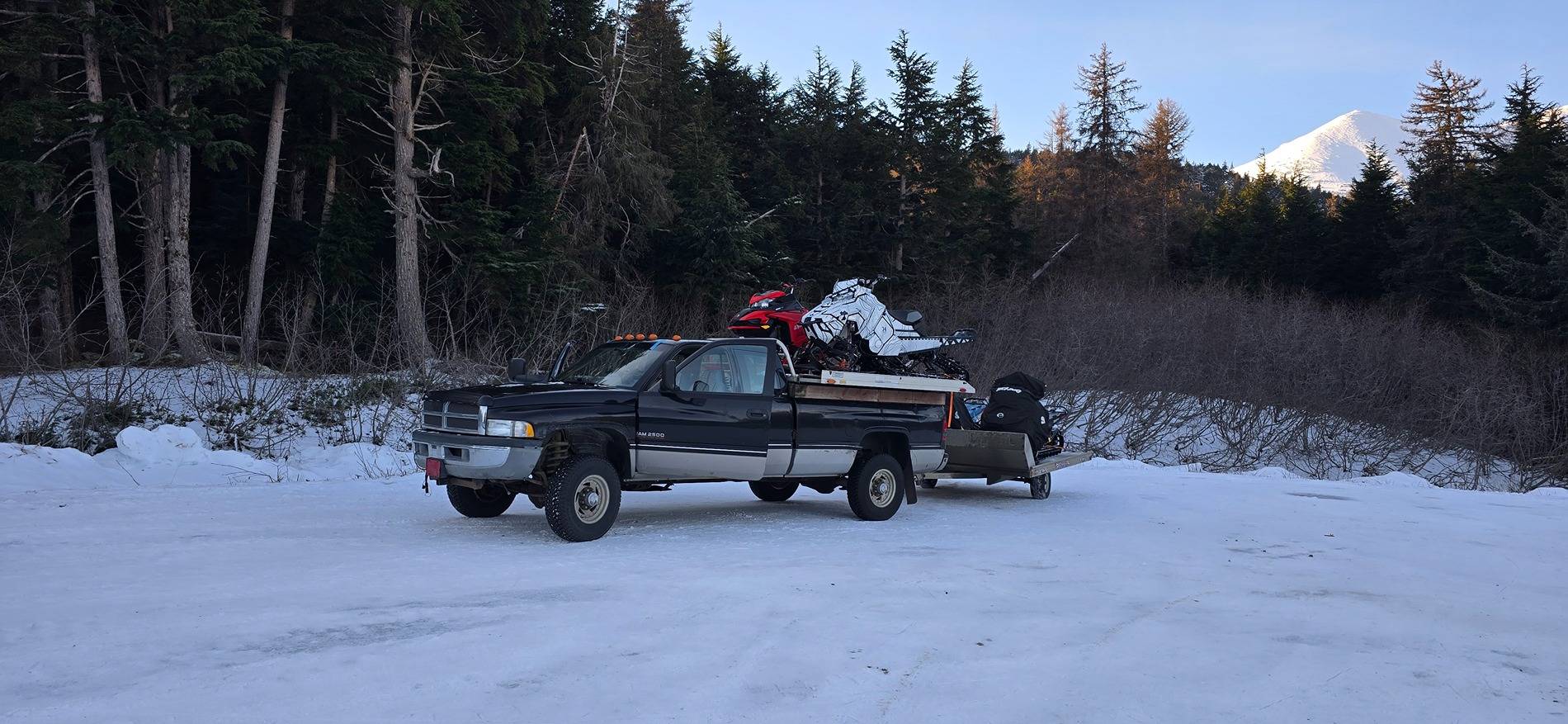

Interestingly enough- my dodge does fine with 1000 plus lbs on top. I also have a setup for my RZR1000 that weighs 1600 lbs. No issue whatsoever. Given the Cybertruck is one of the most stiffness suspensions I've ever had and the cg is so low on it, I wouldn't expect any issues putting 1600 lbs on it in that manner. I was pretty stoked to see this as I was considering building one myself that bolted up in the bed. This one is much better as you still can use the tonneau... :)
