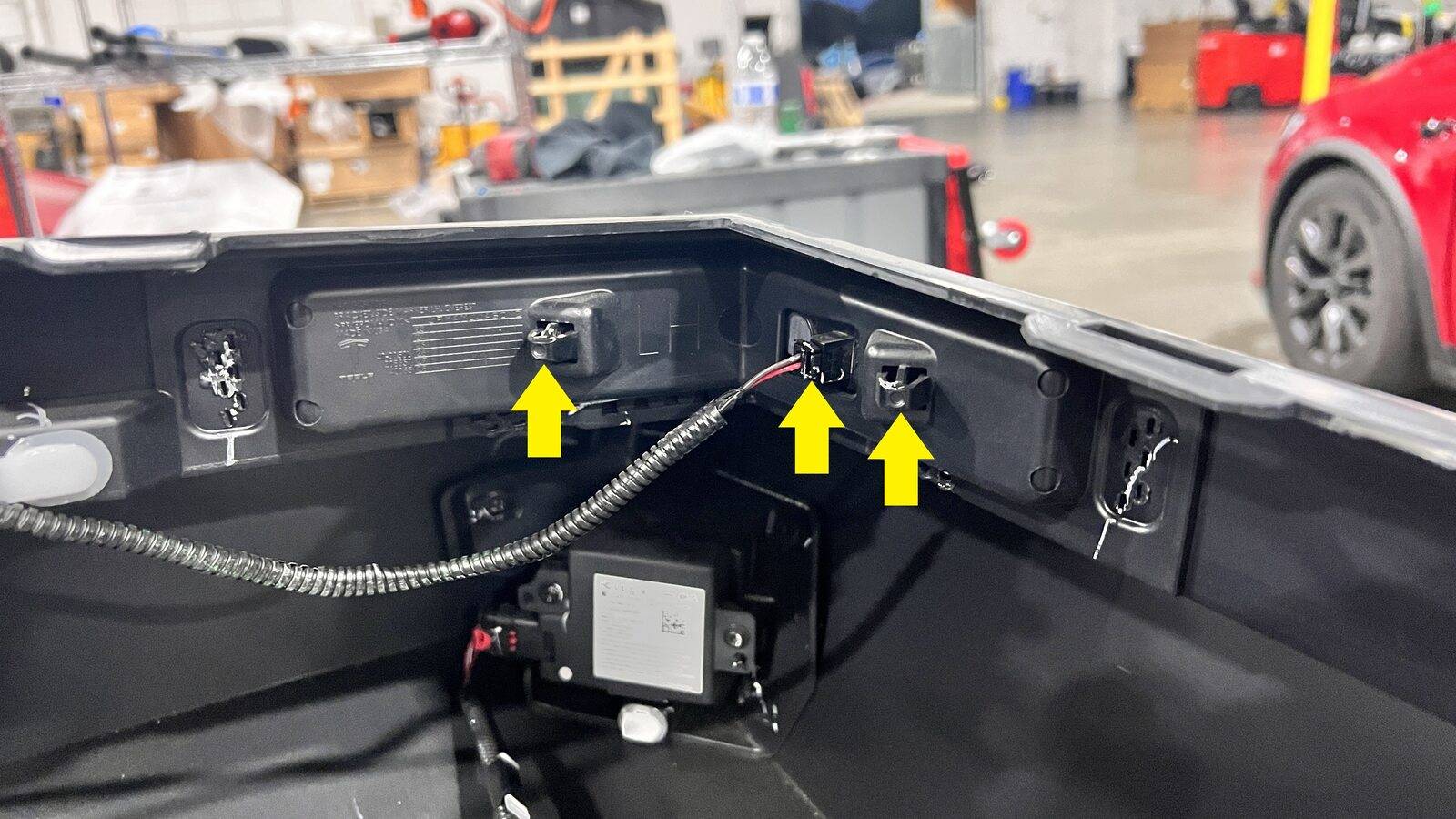

I just noticed this morning that our passenger rear parking light is not working. Is anyone else having this issue? I can’t seem to find a post on the forum in reference to this issue. Just got the CT in November of last year. Is this something mobile service can fix? should this throw a code in the system? If so where do I look?

Find where the light attaches. Throw a multimeter on the plug and see if there is voltage. If there is, it’s the light and yes mobile can fix that. If there is no voltage then it will need to be traced out and the SC will probably need it as it can be anything from a bad wire, a bad harness, bad ECU or anything in between.

So update… with the parking lights turned on the light does not come on. Then if I tap the light with my fingers a little forcefully the light blinks with each tap of my fingers. Loose connection??
