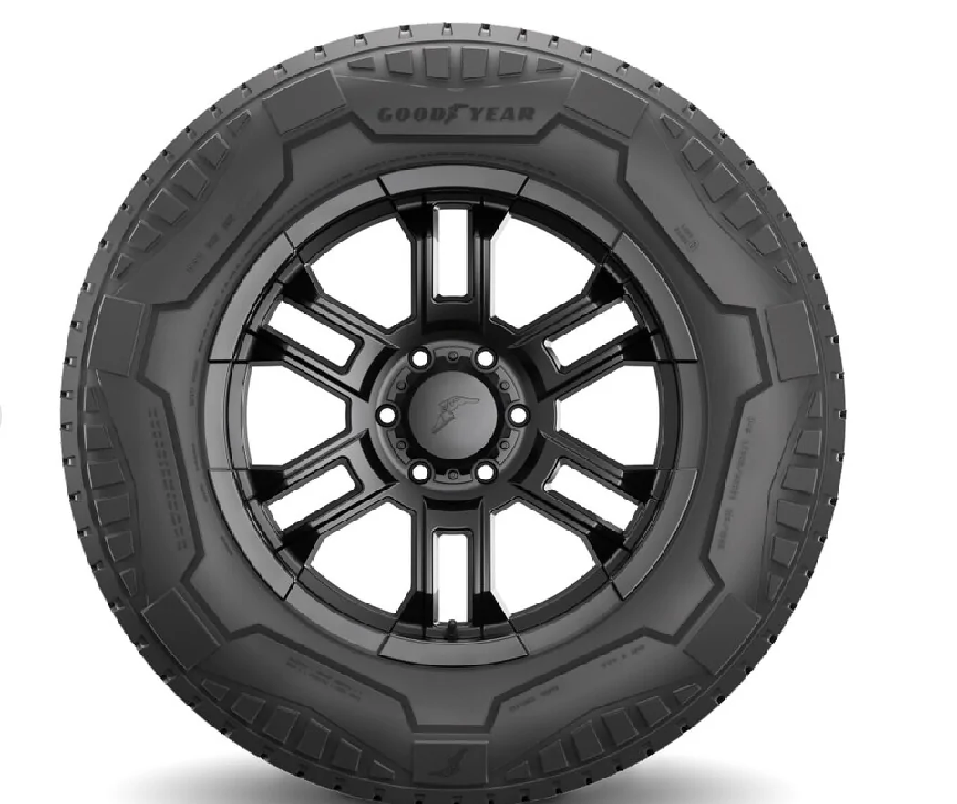

Has anyone had the foam lining the inside of their OEM Goodyear Tires come off and ball up inside the tire? One tire already did this, and if the current ride I'm experiencing at highway speeds is any indication, I now have an second that has done the same. I'll call Goodyear today. Unfortunately the closest Goodyear store is 45 minutes away.

Goodyear Tire center found a second foam lining that had delaminated. They were prepared to replace two tires at a prorated cost which wasn't much(I think they quoted something like $70 each for the 2 tires).
Ended up taking my truck in to Telsa for something unrelated, and they replaced both tires under warranty stating that they are working with Goodyear on the issue of the foam delaminating. The service tech had a name for it, that is escaping me, but it seems that Tesla is aware of the issue and willing to work with customers. If you have the Wrangler Territory RTs, the tire that has the side wall designed to match the Cyber Wheel Cover, and your truck has developed a vibration at highway speeds, this very well could be your problem. With the new tires, my truck rides like it's brand new again.
