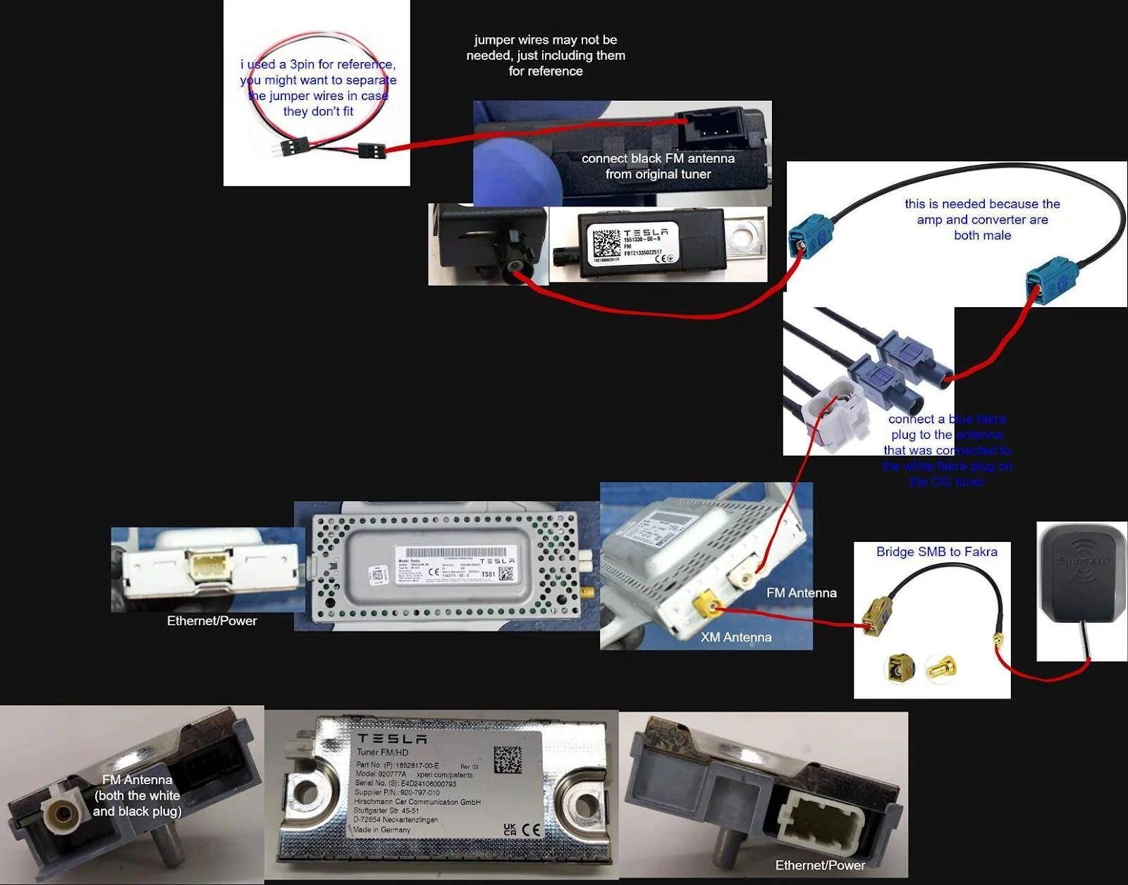

Cool writeup and thanks for including those pictures.
For those wondering about the reasons Tesla excluded this, we can only guess as others have pointed out the S/X have it.
My guess is that Tesla is moving away from legacy features like this and Homelink which also isn't available on the CT as a hardware option.

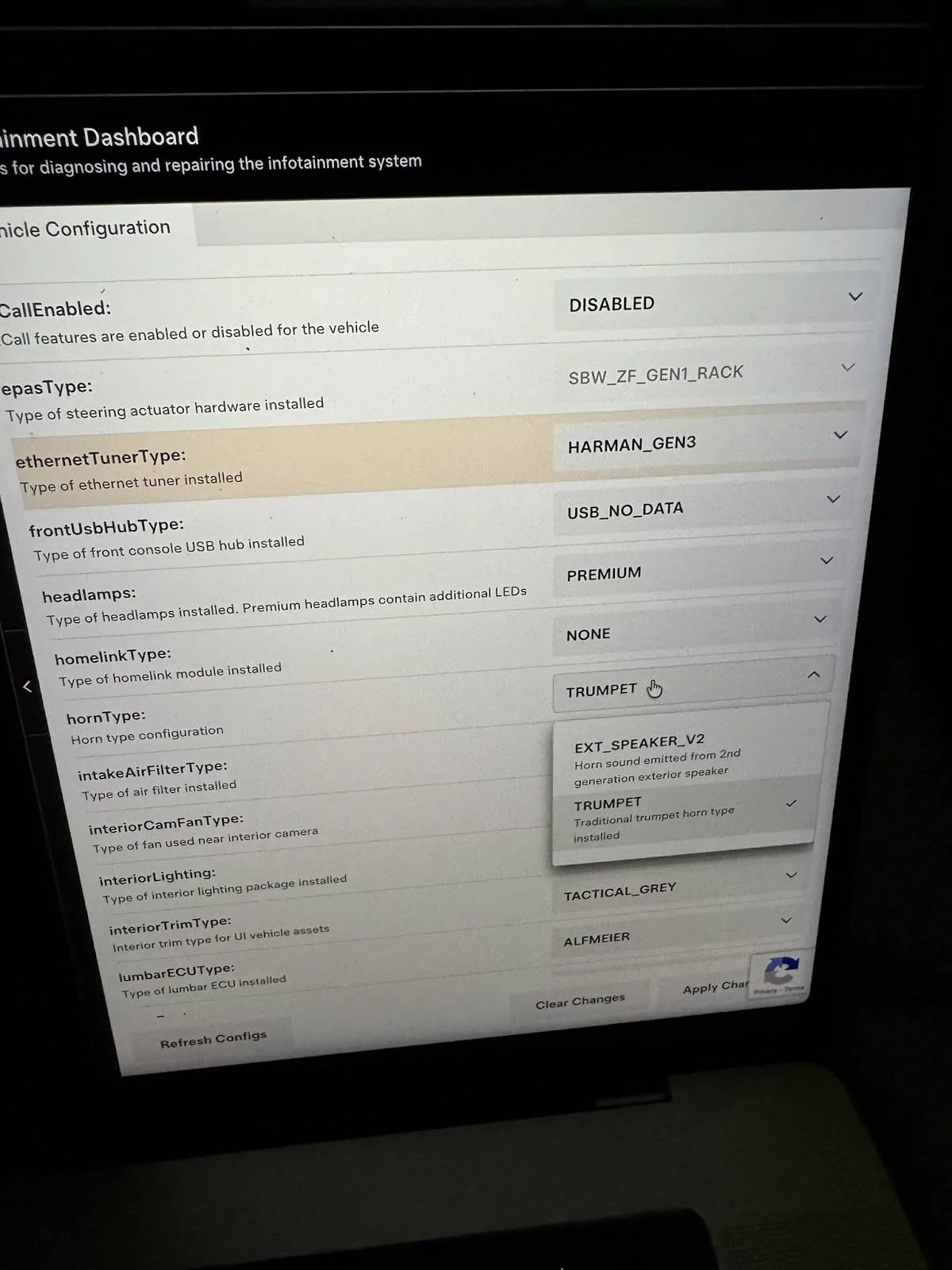

Off topic but I see the Toolbox picture appears to allow you to change back to the original horn. :p
