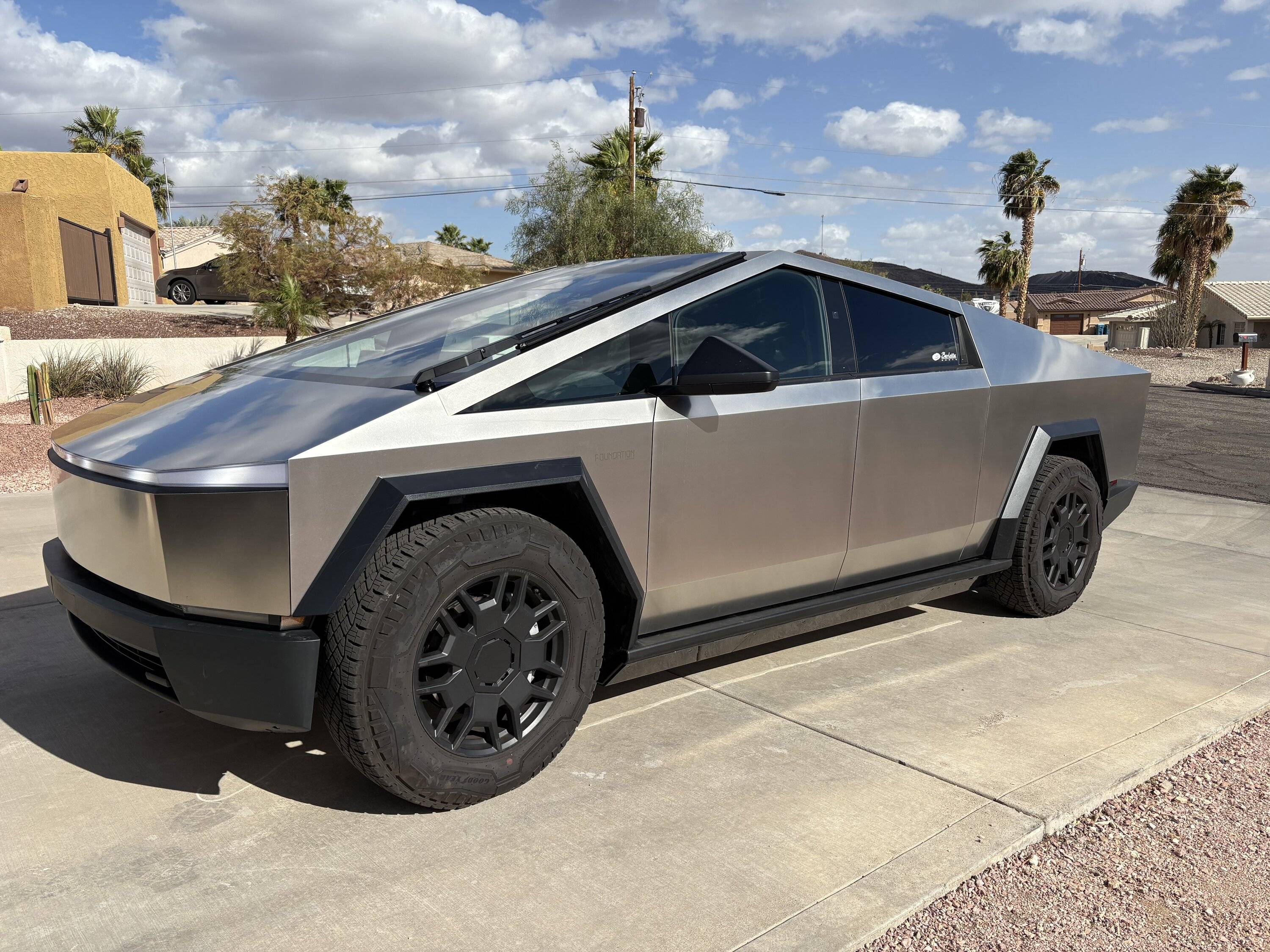

Here is my review of the CyberTruckCo Rock Sliders and some notes:
Tesla Cybertruck Review of CyberTruckCo Rock Sliders IMG_6691

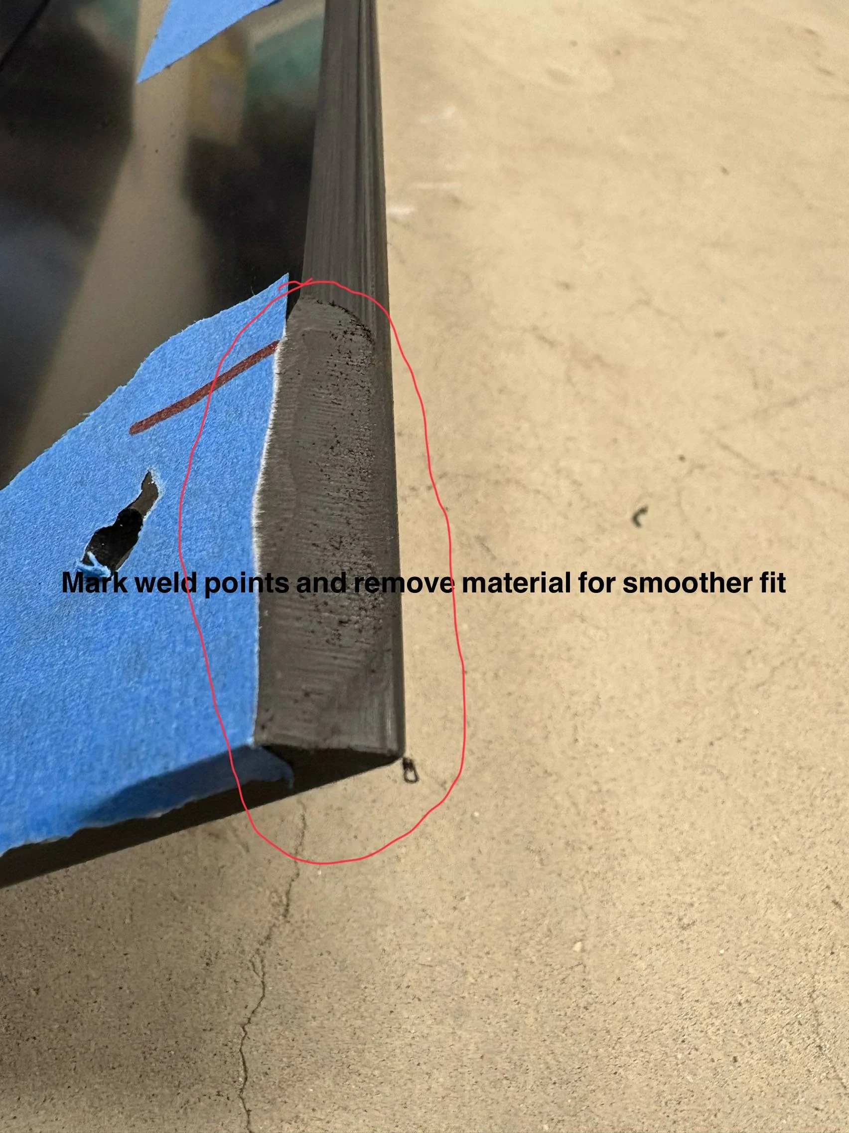

First, after removing the old pieces and cleaning the floor of debris, I would lay out the sliders on each side and test fit the poly panels (also, count ALL hardware-I was short 8 small screws for the poly panels).
Tesla Cybertruck Review of CyberTruckCo Rock Sliders IMG_6687
In my opinion, tesl fitting is important for a smooth fit. The issue I ran into was with the poly panel pushed up to line up the top screw holes, the welds hit the bevel on the panel making it very difficult to install the necessary short screws.
I solved this by marking the weld spots on the poly panel and removing material on the back side.
Tesla Cybertruck Review of CyberTruckCo Rock Sliders IMG_6690

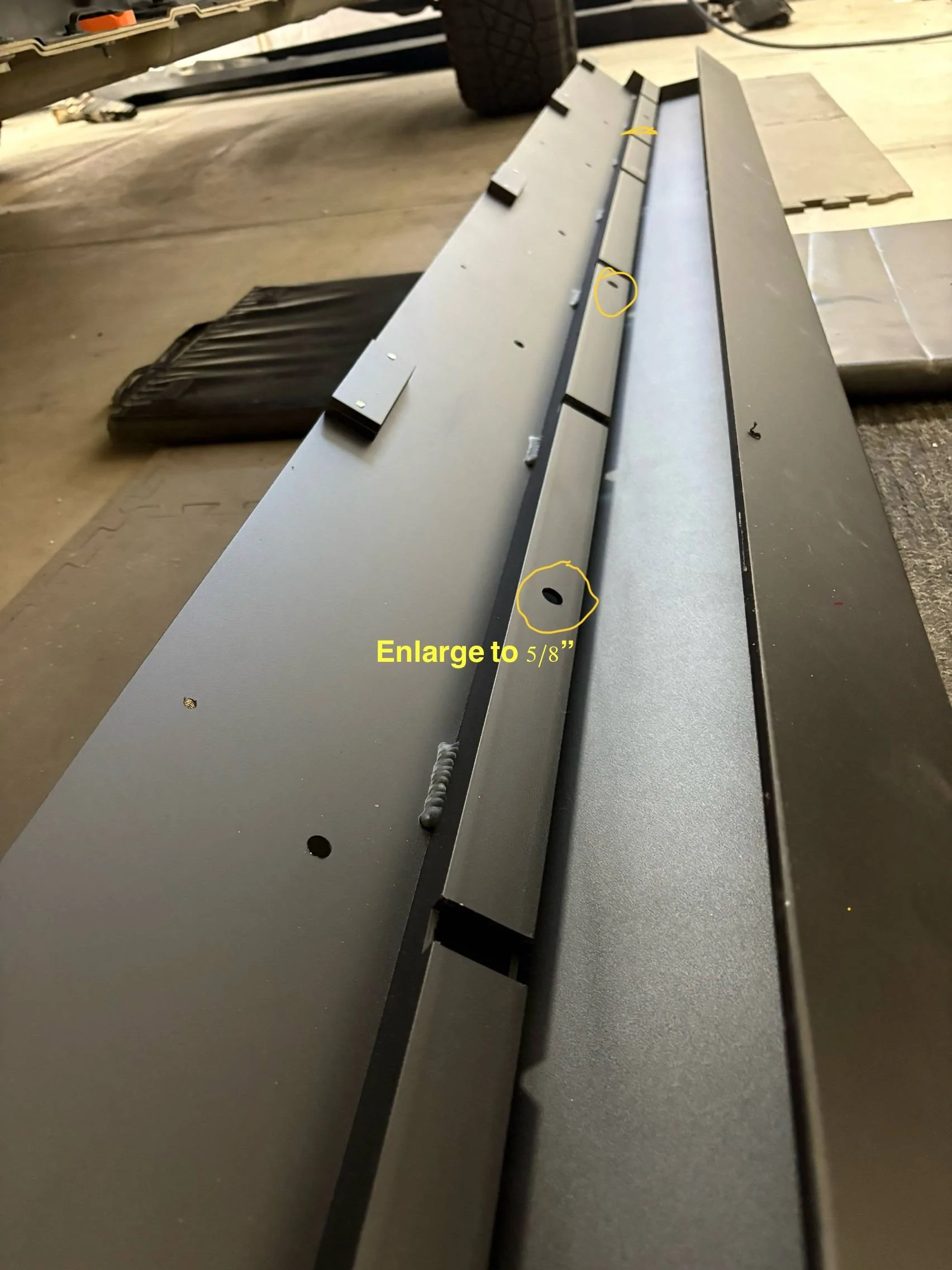

Prior to installing the rock slider I would enlarge the three holes in the square tube to 5/8”.
I ran into an issue with my truck on the initial test fit. All 5 of the 8mm screws would line up and easily screw in but the long 6mm screws would not.
After a lot of messing with, I determined that the original holes are too small to allow the 6mm screws to start straight and after enlarging all three to 5/8” then everything went fine.
Tesla Cybertruck Review of CyberTruckCo Rock Sliders IMG_6689

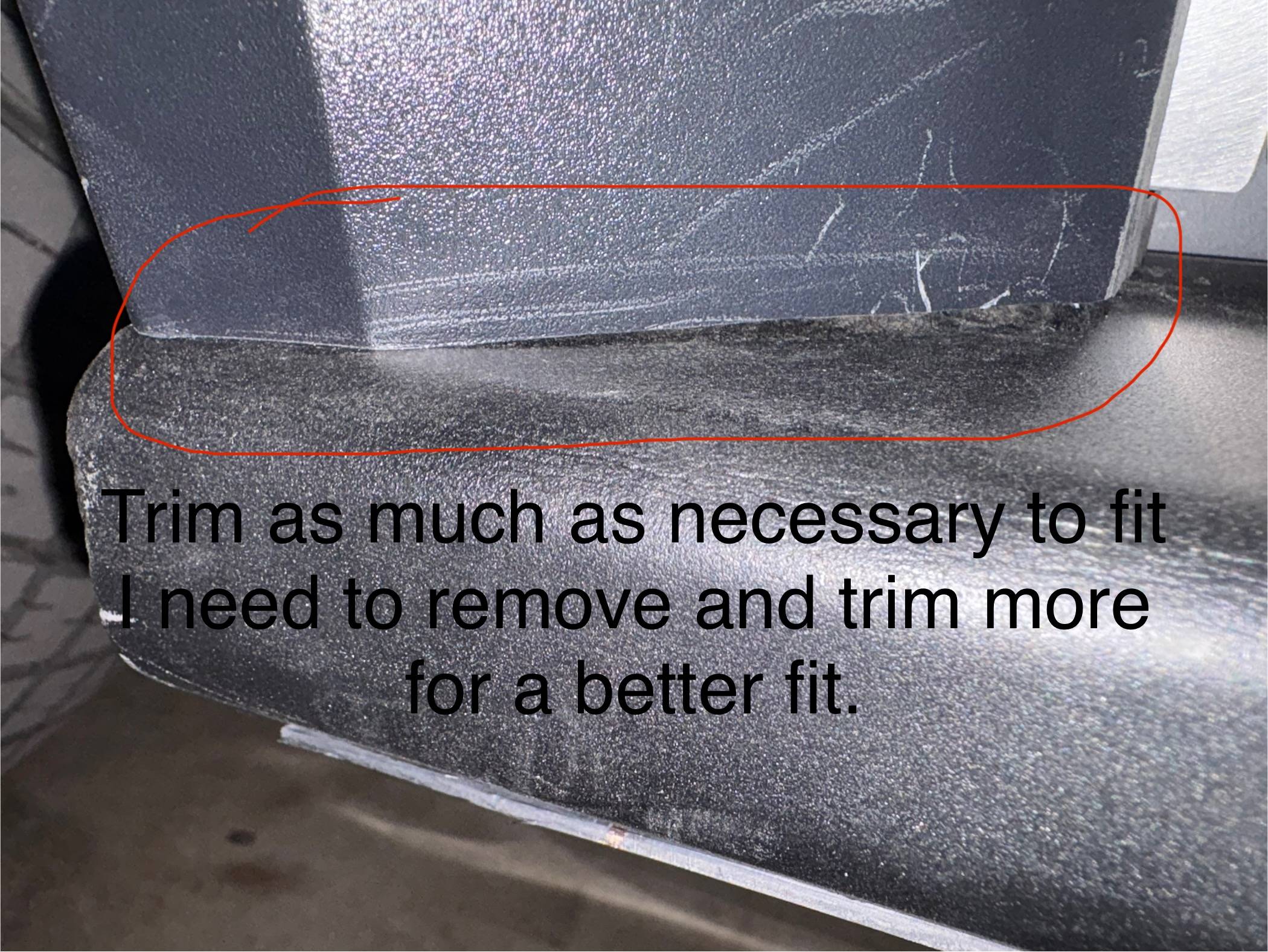

Finally, install the poly panels. If you trimmed the panels they go on easily while laying on your back ? and the panels will fit flush with the slider.
Tesla Cybertruck Review of CyberTruckCo Rock Sliders IMG_6686
The last step is to cut the fender liner, tuck it in and install the fender flair.
This was my last hurdle.
The rear fender flairs fit perfectly.
The front, not so much.
I had to remove both of the front flairs and trim to allow them to fit back on.
Tesla Cybertruck Review of CyberTruckCo Rock Sliders IMG_6694

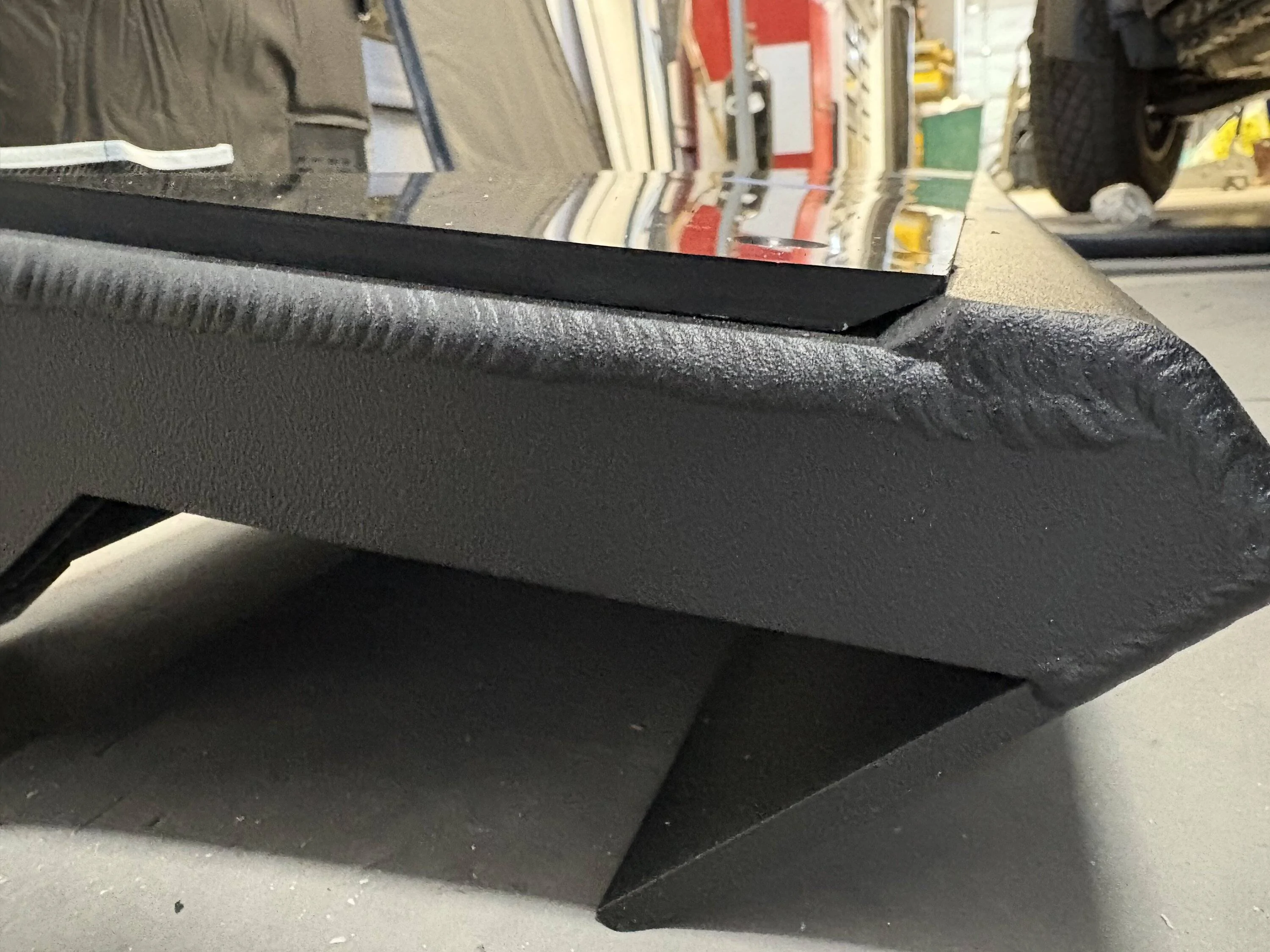

Damn. I should have waited for these. I think they look more complete than my t-sportline version which is also integrated with xpel armor. Doesn’t go all the way to the wheel arch though. Pardon the 4th of July magnets. This thing is basically just a canvas for my kids.
Tesla Cybertruck Review of CyberTruckCo Rock Sliders IMG_3892
