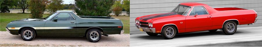

Heard the statement another type class of vehicle.
We had these other class of vehicles awhile back..
Tesla Cybertruck Sandy Munro Talks Cybertruck Icon Status, Manufacturing Cost, Safety on HyperChange OTHER TRUCKS
I think Munro is more referring to the unique manufacturing processes and externalised load bearing aspects of the CT. Traditional pickup trucks have their body panels stamped out from a large press. This includes cab on chassis as well as the unibody styles shown here. The benefits to stamping out carbon steel panels are that the material is cheap, and strong but flexible enough to allow some complexity in the panel design.
Because the CT design involves hardened, relatively thick stainless steel it cannot be stamped out in the traditional manner. This requires new manufacturing techniques involving the folding of the panels forming the exoskeleton. Also the exoskeleton is load bearing unlike cab on chassis style trucks. Unibody pickups probably spread the load into the rear sides of the vehicle, extending into the cab via the thickened B pillar.
Though if you look at the unibody style vehicles above you can see that the front fender does not provide any load bearing at all. The thick B pillar that joins the cab to the bed is also compromised for styling (and arguably practicality) purposes. A straight line from the top of the cab to the end of the bed would be strongest, if that outer panel needed tocarry a lot of load. But I think you will find in the unibody pickup trucks most of the load bearing is in the underbody of the vehicle and minimal load is transferred to the outer body.
In contrast the CT has thick hardened stainless steel, in a triangle shape for the key purpose of load bearing. Naturally some load will be carried by the underbody as well, it is after all carrying some very heavy batteries.
Munro also expects these CT design elements to be ultimately copied by other vehicle manufacturers, because it provides excellent strength to weight ratio at minimal cost.
I think these factors led Munro to state that the CT is in a class of its own and that would be the 'Exoskeleton' class.

I suppose when u think about like that, it could get its own class. Where the outer panels are also load bearing. As apposed to a typical unibody where the internal structure takes the loads and the outer body panels are thin stamped coverings basically.
