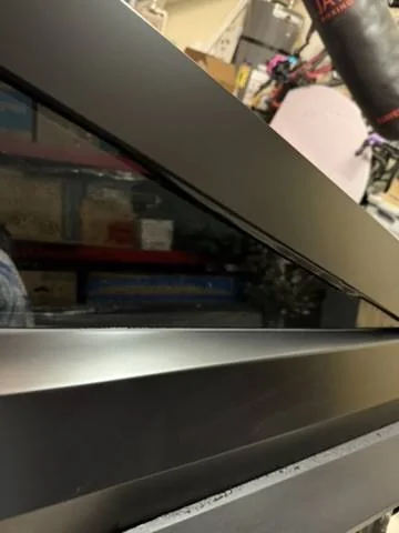

What's the best solution when the edges start coming up? (other than the obvious "push it back up into place")
