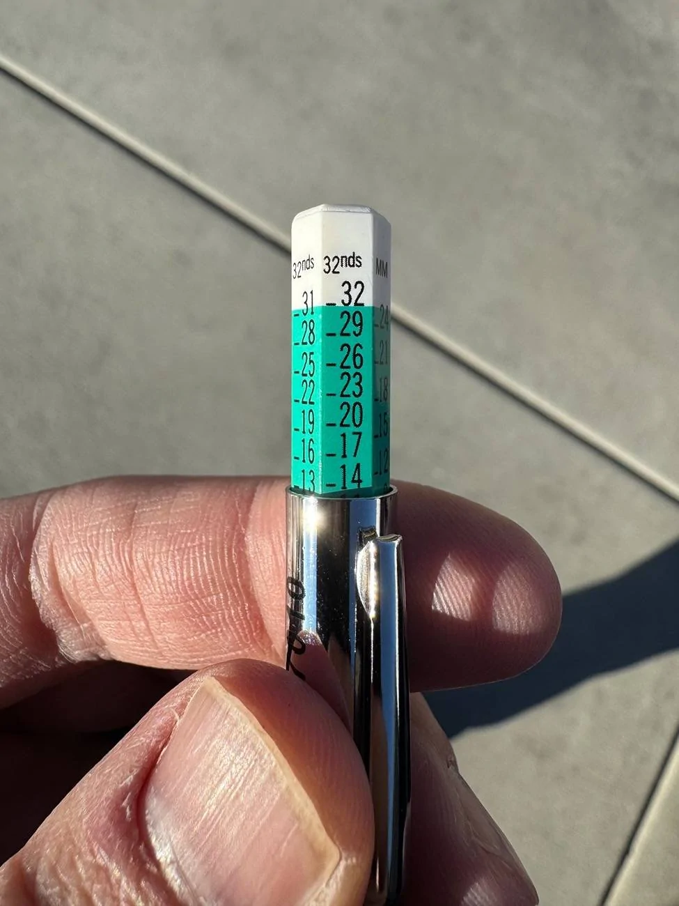

Would you be willing to take a tread depth measurement when you take delivery or shortly after that? I recently picked up the spare tire kit and that tire had 13/32nds new. I’m curious if the new rides with AT have the same.

Also to answer the tread depth question my OEM AT tires measured at about 10/32nds tread depth.
