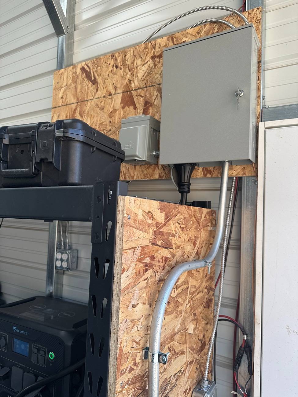

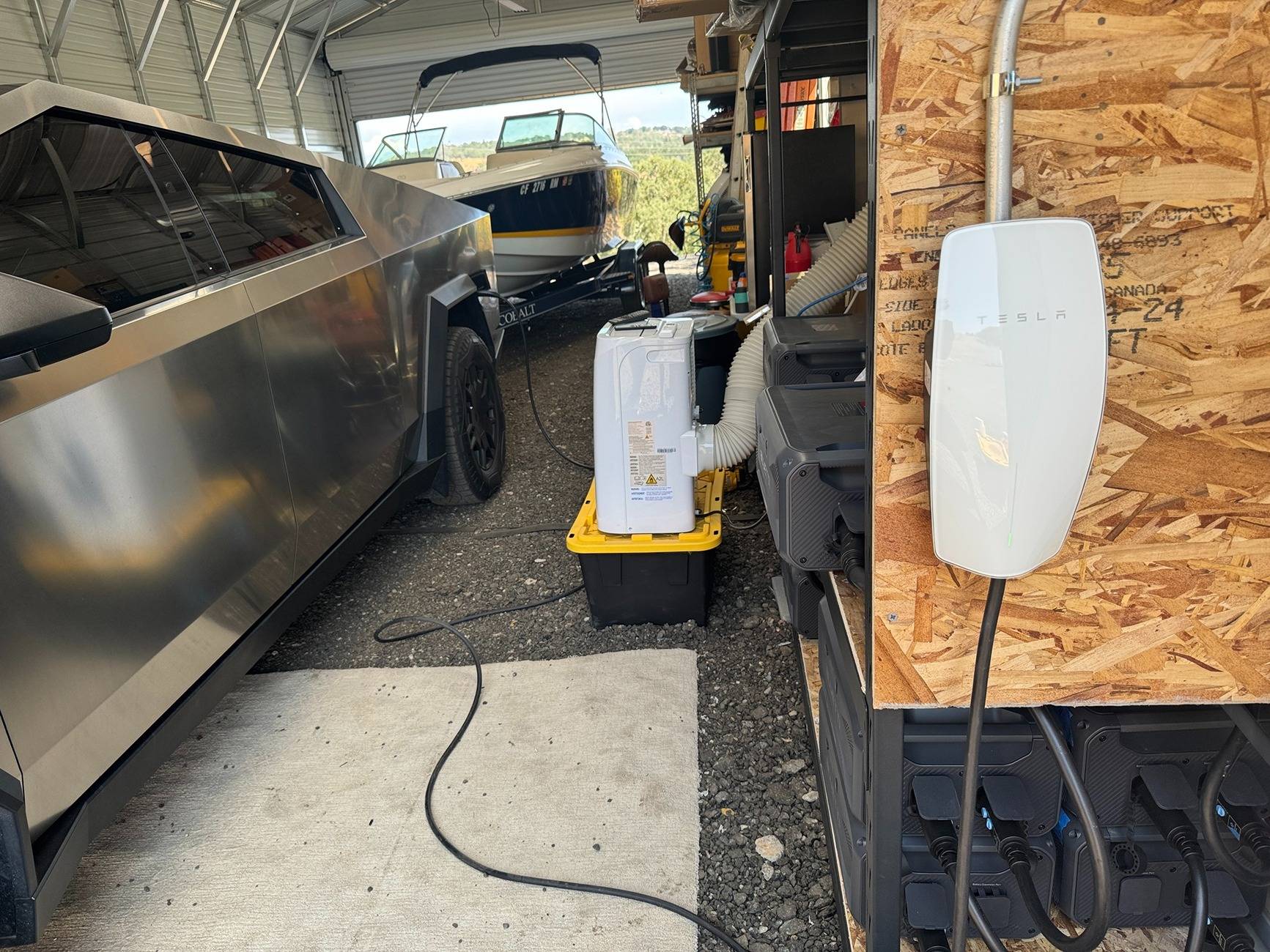

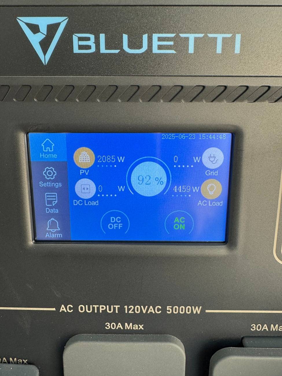

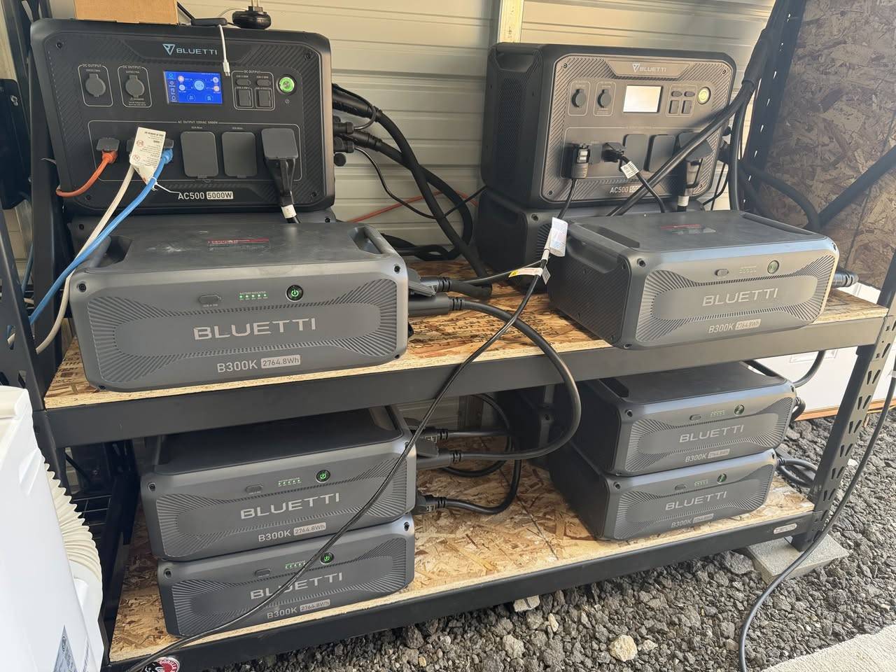

I charge daily from a totally off grid solar generation setup.
I can get about 30KWH a day out of the system.
Components are mostly all Bluetti.
2 X AC500 running in split phase (10KW output max)
12 X B300K batteries
12 x 455w roof mounted solar panels
This is wired through a Bluetti connection panel and I have a Tesla wall charger hard wired.
Realistic charge rate holds @ 9KWH
