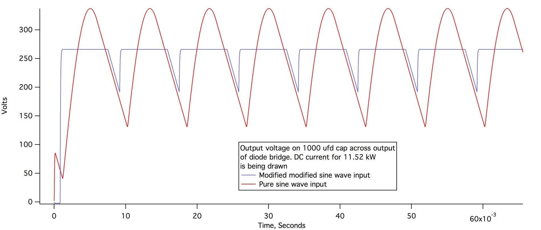

Tesla Cybertruck Generator Charging Ripple
First a comment on the huge ripple. The fact of the matter is that if you are going to be discharging a capacitor at a rate corresponding to 11.5 kW then it is going to discharge pretty fast unless the capacitor is huge. 1000 ufd capacitors rated at 500V are certainly available but they aren't cheap. The fact is that 10,000 W is 10,000 joules/sec and a 1000 ufd cap at 400V only holds 90. The glaring thing about the voltage curved is that from the POV of ripple the modified sine wave produces a much better result. And while we have demonstrated that phase lock with the primary waveform is clearly possible it should be clear that sync to the the 120 Hz line in the rectified waveform would be even simpler. So there is no problem with sync and the rectified modified sinewave is purer DC it seems that there would be absolutely no problem with charging a Telsa from a modified sinewave inverter. But no one has asked about that. The question is as to whether it can be done from a generator. It clearly can be done from a pure sine wave invertrer equipped generator and it clearly can be done from a conventional generator. It looks as if it can be done from a generator equipped with a modified sine inverter too but I have never seen or heard of such a beast.

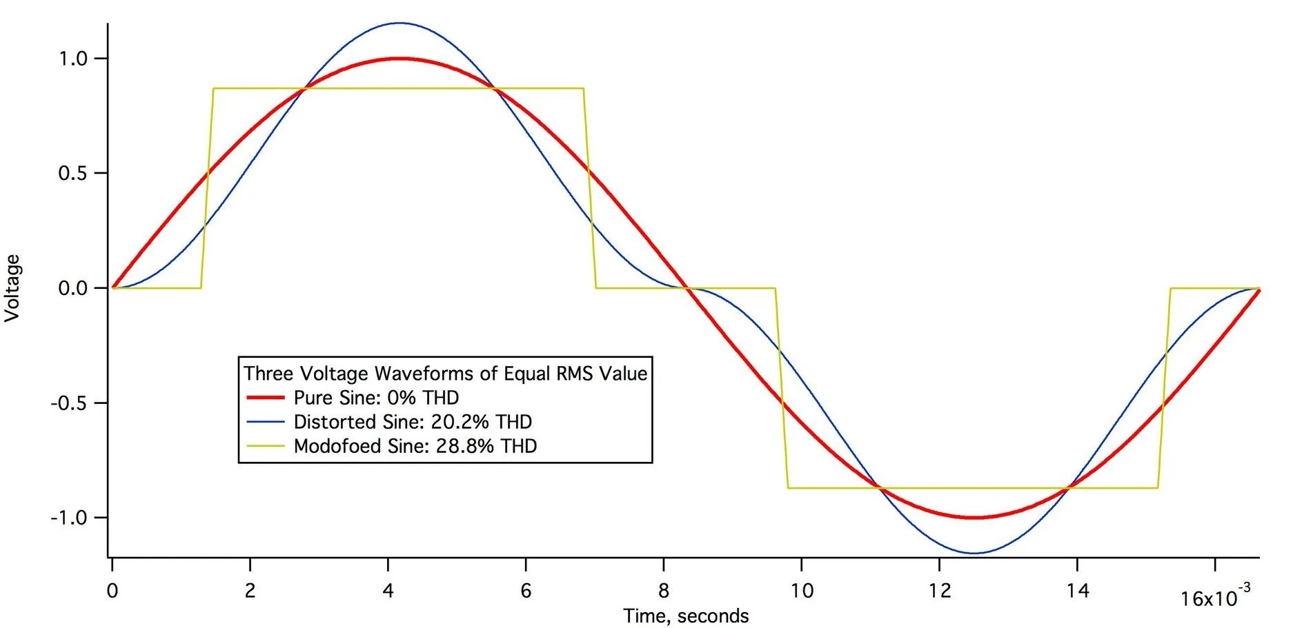

The remainder of this post is more technical detail showing why Bill906's assumptions are probably wrong.
The first converter (or bridge) in the Tesla charger uses transistors.
Probably not. That rumor was started when someone looked at the packaging and saw the extra pins. That does not make the things in the package transistors. And even if they were there is no reason why they should be gated other than on other than as diodes. The rumor that the front end bridge devices were transistors led to the conclusion that the device was a two way device. Were that so these devices would have to be transistors. As the charger is not presently two way there is no reason for those devices to do anything other than rectify.
That makes that part of the charger an active converter. The reason that converter is an active converter is most likely for harmonic mitigation. Because of this I find it unlikely the Tesla charger will work with voltage waveforms other than ones that closely resemble sine waves.
Harmonic mitigation is done elsewhere. Several sources which include schematics and reverse engineering attempts make it pretty certain what the architecture of the charger is. It is apparently a passive bridge (diodes or transistors configured as diodes) rectifier followed by a second bridge inverter operating at something like 50 kHz. The inverter output goes to a transformer where the AC voltage is stepped up and the stepped up AC is then rectified and sent to the battery. Given this the sensible place to do "power factor correction" is in the gating to the inverter stage. The desired current draw waveform is stored in the machine and it is generated locked to the incoming voltage. It is compared to the current being drawn by this bridge and an error signal developed. That error is fed to a PWM gating waveform generator. If the charger is drawing too much current at a particular time in the cycle the pulse width is narrowed. If it is not drawing enough it is widened. Note that one can also control the magnitude of the current drawn by controlling the scaling of the reference waveform.
The output of the modulator (bridge) is a series of bipolar (AC) pulses of varying widths that is passed to a transformer where the voltage is stepped up to a level suitable for the battery. That pulse train is rectified (in a third bridge) to provide DC for the battery.
I need to make it clear that this is probably the way the circuit works given what we know about its architecture and the way many a switching power supply works but I don't have enough detail to say that this IS what it does. It's just probably what it does. The inverter bridge has to be gated (it has to be active) to do its function. Given that, it is the logical place to do "power factor" correction and, given that why would they want to complicate things by gating the incoming bridge too?
The front end probably is not active but even were it so what would be the problem with highly distorted inputs? Your argument is jejune.
If you use a cheap generator that creates a squarewave or modified square wave I doubt the Tesla charger will work.
There are no generators that create square wave or modified square wave and even if there were they would probably work. For perspective here's a picture of three voltage waveforms each of which has the same rms voltage (0.707 volt). The heavy red curve is a pure sine wave - 0% THD. The blue curve is a distorted waveform with 20% THD and the stepping curve is modified sinewave with THD 29%. Why do we think a rectifier, active or passive, would have any trouble with any of these?
Tesla Cybertruck Generator Charging Waveforms
There are limitations, of course, as to how much waveform correction can be done by this method. Clearly you cannot draw current when the supply voltage is 0 as it is for about 1/3 of the modified sin inverter's cycle. Keep in mind that an OEM is not obligated to deliver better than a 7% THD waveform to a generator. He is obligated to draw a current waveform that has less than 7% THD when supplied a voltage waveform with THD < 7% which is the worst a utility is allowed to supply 95% of the time. This is all for the protection of the utility, btw. Harmonic currents are often reverse sequence and the big killer is that triplen harmonics add up in the 0 sequence (on the neutral) to the point that it now has to be sized as large as the phase conductors.
