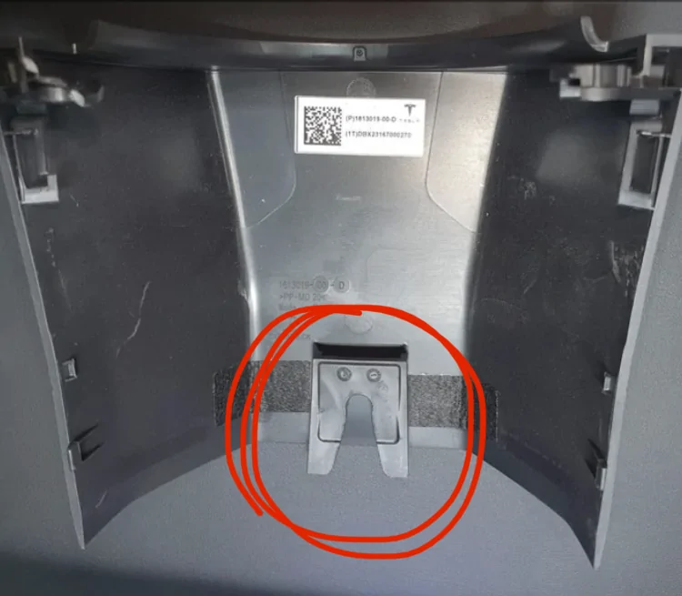

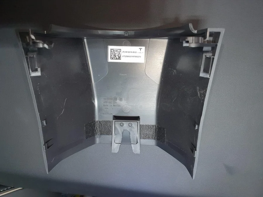

Shouldn’t need to remove the shroud completely. Just try to add some closed cell foam to it since they tend to creak and make sounds especially over bumps
