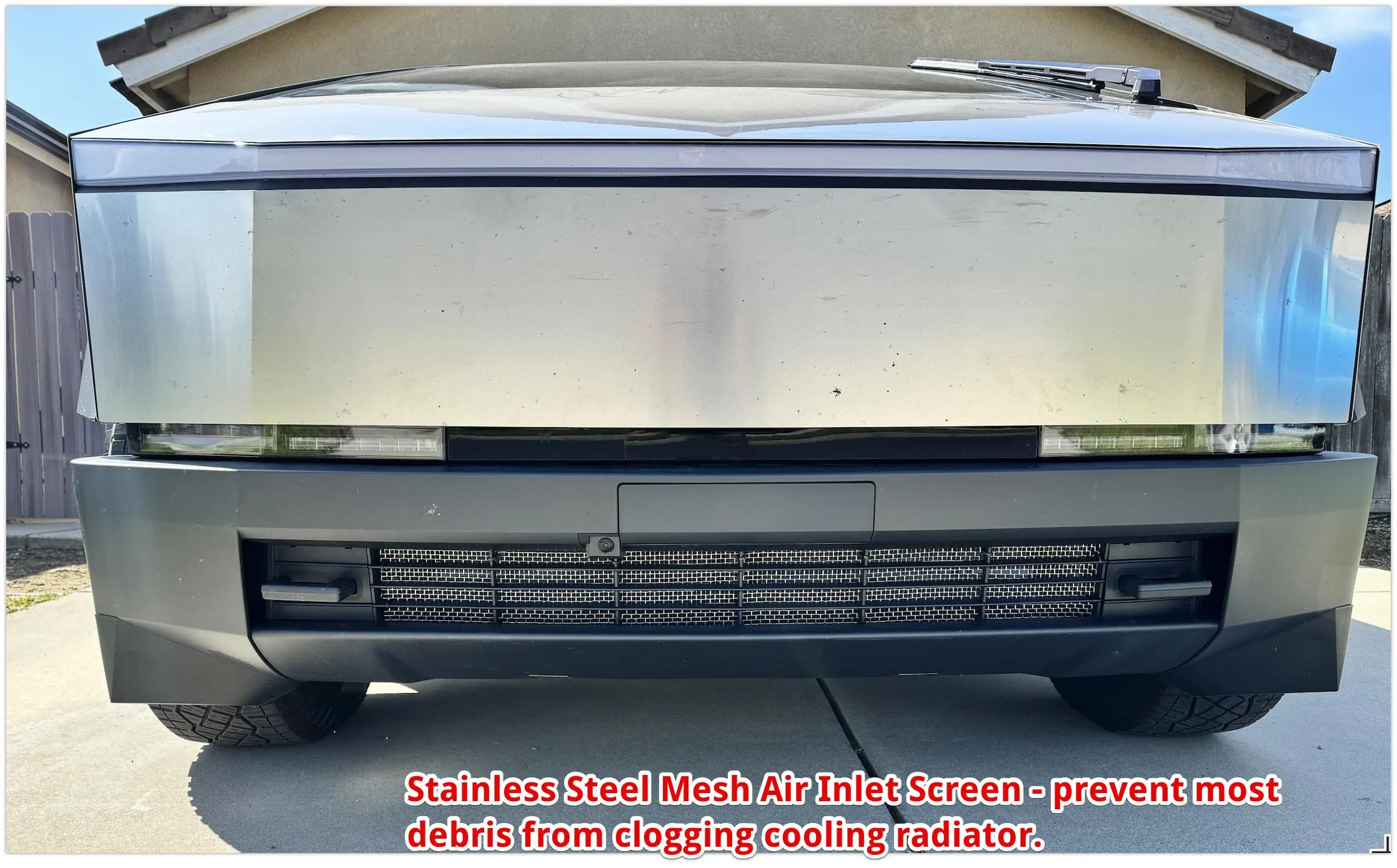

+ Stainless Steel Mesh inlet screen install. Prevent debris from clogging your Radiator efficiency

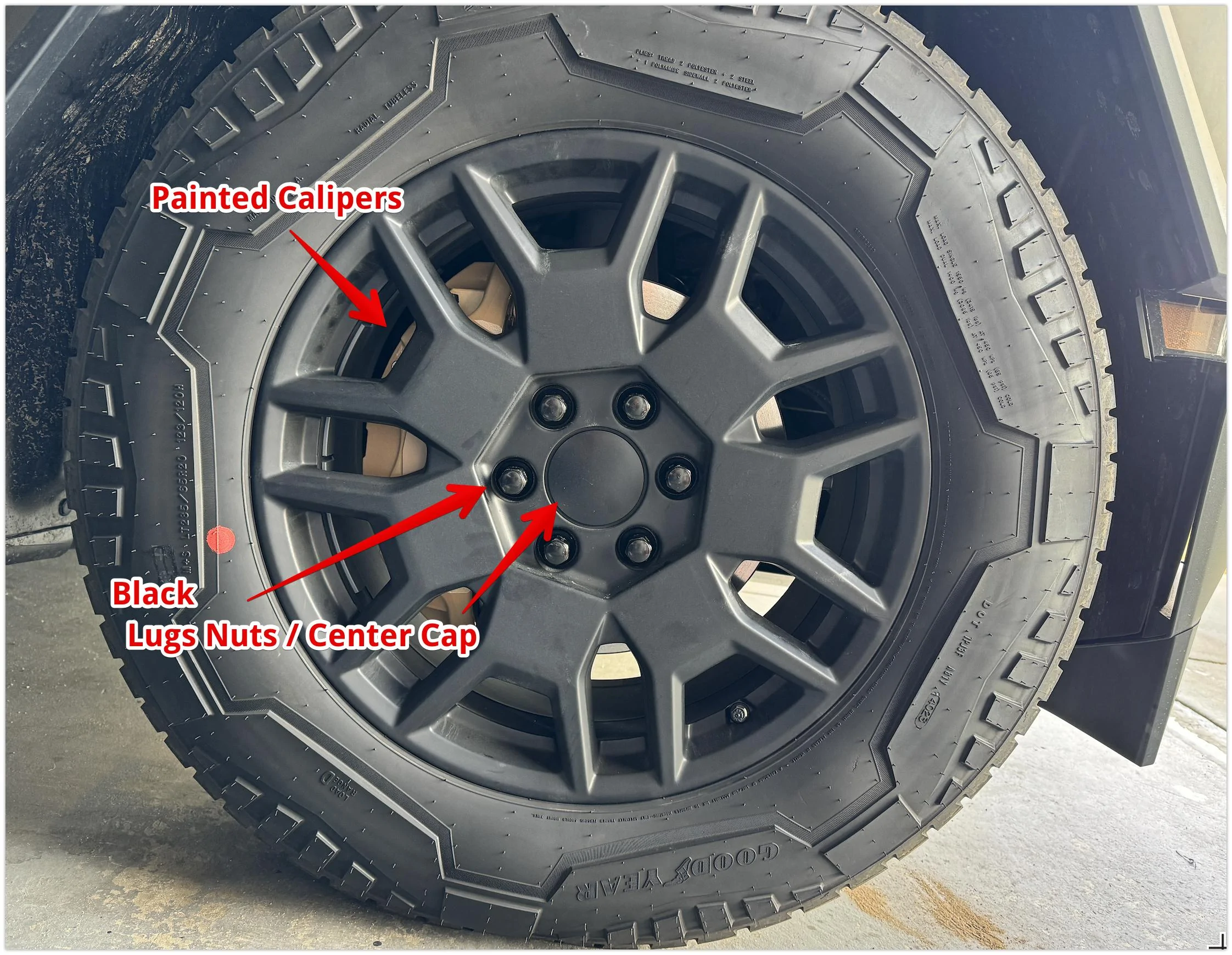

+ Painted Calipers, Black lug nuts, Black Center Cap.

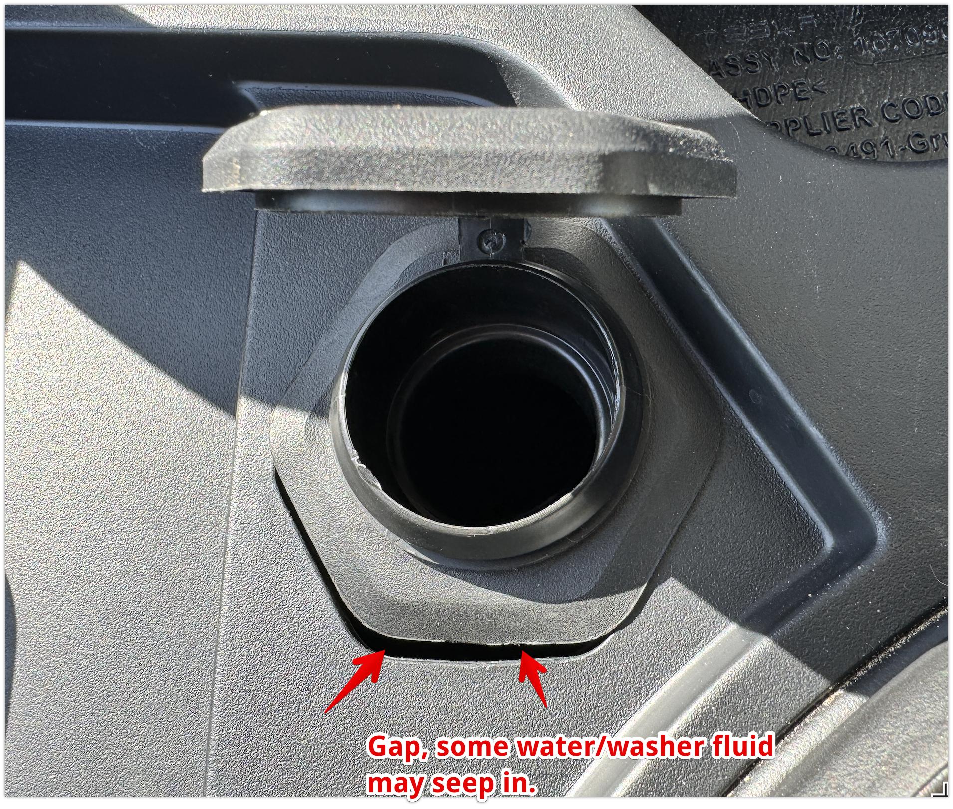

+ Washer Fluid gasket/fluid reservior alignment. Tried loosening all bolts for frunk tray. Still Gap.

When I removed my under-hood apron (between the windshield and frunk tub) I lifted up and forward, which is a no-no. This caused one of the fir-trees to slide off and drop behind the frunk tub. ?
I threaded my endoscope cam to look for it, but it was lodged where I just couldn't reach it. I started removing the tub, but just loosening it let the wayward part drop to just overtop the headlight.
Basically, the area under the frunk tub isn't an "interior" space that needs to be protected, so the washer fluid is no big deal. ?‍♂

Would love to have instructions on how you did the Mesh air inlet
Measure opening, obtain your desired sized stainless steel mesh ( i used 3/16 sized opening), remove frunk pan , remove all bumper hardware. Remove bumper fascia, Measure, and cut your mesh figure out how u want fasten in place. Reinstall . See service manual for removal and reinstall instructions.
I think itd be easier just to cut it to outside dimensions and zip tie it there. Plus itll look cool and be easier to dbug/rock/trash imo
