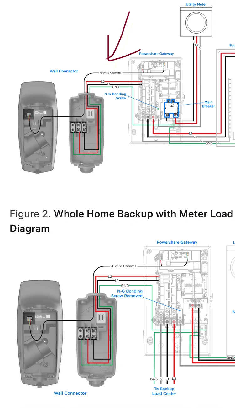

Have Tesla solar, PW3s and wall connectors. For V2H using the Cybertruck, do I need a universal wall connector or will my existing wall connectors work? Thought I read UWC has the ability to communicate up toward the electrical source enabling V2H.

For a system with Powerwalls, the guide calls out Gen 3 or Universal Wall Connector on the backed up side of your Gateway or Backup Switch, once the software is released.
Previously, things had called out any EVSE...
https://energylibrary.tesla.com/doc...UID-04DE7F20-2290-4489-A9A1-53F639BB85CB.html
