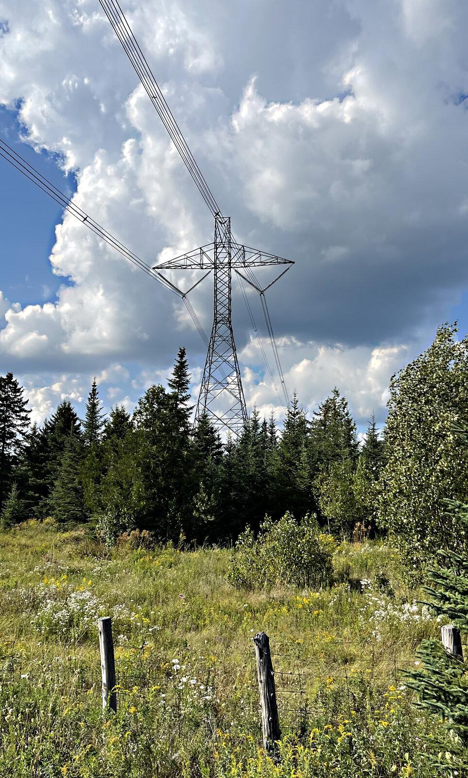

. (most power, most losses from resistance, right?)
Yes and the losses are proportional to the square of the current so the obvious approach to transmission is to get voltage up thereby reducing current. The reasonTesla and Westinghouse beat out Edison is that this is relatively easy to do with AC and, with the technology of the time, very difficult to do with DC. Power generated at about 4 kV can be transformed up by a factor of 177 reducing current by the same factor and loss by a factor of 31,217. Of course there is a spoiler in here and that is that all the current in a AC system is not active (delivering power). Some of it is reactive. This doesn't transfer any power to the load but does to the line conductors and transformer windings it flows through. Reactive current flows across the insulators one sees on power lines and from the conductors through the air beneath them to the ground. This is particularly problematical in buried systems as the conductors are often only inches away from the earth.
So why am I going on about this? Yesterday we were driving in the country and I spotted this out the window.
Tesla Cybertruck The curse of 'white oil': electric vehicles' dirty secret IMG_1646_
Did a double take, swerved and went back to take the picture. No, Mrs did not think I was nuts. She well knows I am. So what's wrong with this picture? Some of you may, from the drift above, already figured that out but I'll bet that very few of you have ever seen a pylon like this one before though you may have seen thousands of normal ones. What's wrong with this picture is that there are only two sets of conductors on it and all the towers you have probably seen have 3 (I had never seen something like this outside of a GE lab and that was over 50 years ago). This is a DC transmission line (Edison must be chuckling in his grave) which transmits 2000 MW at ± 450 kV from James Bay to Boston (with taps for Montreal)..
DC transmission has its own set of problems associated with voltage conversion, conversion from AC to DC and back and switching, of course, and DC lines are rare but reactive currents are eliminated.
