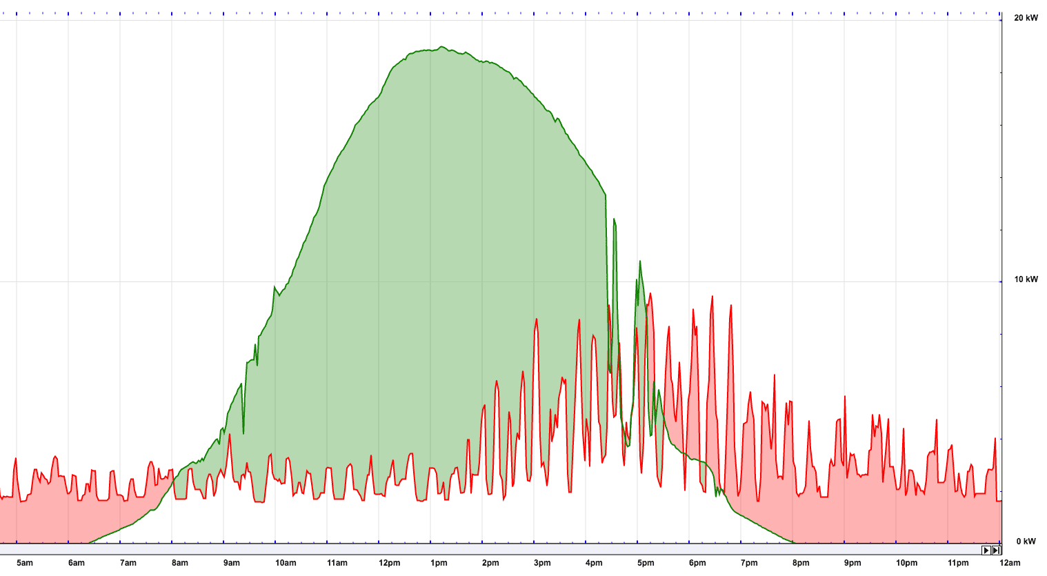

It is certainly going to be interesting to watch the evolution but don't expect things to happen to fast. Here's the situation with home rooftop solar:
What happens is the sun comes up in the morning and starts to produce electricity. By noon (apparent noon that is i.e. 13:00 daylight time) the house warms up and the A/Cs cut in. The sun then starts to go down but everything outside stays warm and so the A/C's continue to run into the evening - in fact until it cools off well into the evening. Thus the peak load occurs after the time of peak solar production. In the winter if one heats with electricity it is just the opposite. The heavy electric load arises before the sun can produce much. So the solar production needs to be "stored". A little math makes it clear that I can't afford the batteries (nor do I have a place to put them) necessary to shift the solar so I have to use the utility as a 'virtual' battery. What this means, in effect, is that the utility has to supply me in times of peak load just as they did before the solar was intstalled. What this means to the grid is that it has to continue to grow as the population and its demand for electricity grow but that they must manage "leveling" differently.
Where does the energy in that big green blob go? It actually goes to my immediate neighbors that don't have solar which means my neighbors aren't taking as much power from the utility as they used to which means the utilities baseline generation has excess capacity. So what do they do with that excess capacity? They store it or sell it. In Virginia that excess capacity is used to pump water from a low reservoir to a high one. At the time of peak demand (when the solar production - be it from customers' roofs or farms owned by the utility) is down the water is allowed to flow downhill to regenerate the solar energy stored earlier. In other places (Australia) the excess capacity is stored in battery farms. The essential point is that the utility must be able to send me power at the same level as it did before. Thus while the generation part of the grid will change because of solar the transmission infrastructure will not. It has to be able to send me as much power as it ever did. Also keep in mind that the sun sometimes goes in for days at a time and that it doesn't deliver as much energy in winter as it does in summer.
There is lots of talk about using renewables in mini-grids which could eliminate parts of the transmission infrastructure. In any case there are three main factors to consider in contemplating the influence of renewables on the future direction the grid, dispersed or localized, may take:
1)Storage
2)Storage
3)Storage
And, as not many regions are fortunate enough to have the geography for a pumped system that leaves batteries and that gets us right back to lithium which I think is going to reign for a long time. Fortunately there is plenty of it in sea water. The mines represent the low hanging fruit and mined lithium is this the least expensive.
I am still not sure why power lines have to go in the air. We manage to put other utilities in the ground (water, gas, sewage) and other countries have found a way to do it... (and I am aware of how grounding works)
Yes, storage will be important, but so will be adjusting power hungry industries and processes to when there is the most abundant energy.
The one I liked the most was smelting and melting of metals only when there is huge surplus of energy. The simplified example was if wind generation is up at the same time as solar, sure it could be stored, or, since power generation is much easier to predict than some realize, just setup to smelt aluminum, or make steel.
Some others have talked about making hydrogen for use as a fuel (for industrial furnaces, rockets, fuel cells). There is also the traditional pumped hydro (as you mentioned) or the new stacked/uphill weights. And of course, storage in batteries (as I hear Japan just bought a large Tesla grid tied storage along with the more famous one in Australia).
We have just in time manufacturing, were the parts arrive as you need them, what about just in time energy consumption, the process is in need of energy just as the energy production is going up and is available (solar, wind, tidal, etc)?
And, even with most residential roof top solar is over production because traditionally people were at work during peak production, it still takes some load off the grid, freeing up capacity for business/industrial/residences without solar (or lowering the baseload generation needs, as you point out).
And roof top solar on commercial and government buildings seems like a no brainer. Again, because peak output is during some use/occupancy. Yes, storage will still be needed, I do understand that.
I do expect it to happen fast, once people realize that it is faster, safer, efficient, and more economical.
This works as long as the rooftop solar production is very limited. In VA the utility had the state regulatory board limit total solar production to 1% of the load. That's been increased somewhat but without more storage management of this source of energy is going to be difficult.
