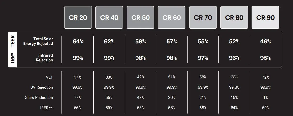

Thanks for that explanation. Is ceramic a risk?
Ceramic tint is UV reflective, so should be minimal risk. It does depend on brand and tint level. Each brand should have a chart similar to this. You're looking for the total solar energy rejected vs. the light allowed through the film. The difference is the energy absorbed by the film. Darker films will absorb a higher percentage of energy while reflection stays relatively constant.
Hence why you can do an extremely light side window tint and still get the thermal benefit for the cabin.
