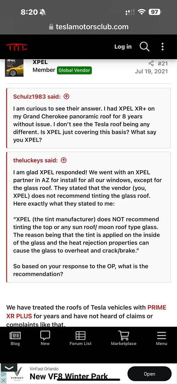

I would highly caution against this. It’s exactly what I did to my truck all around! Same tint paper The windshield included. The only problem is the roof is duel pane. The heat rejection goes right to the outer glass and it will crack and spread. I tinted in March right after getting the truck and it cracked in August. I have never heard of Tesla warranting something like this. See my thread on this exact issue. That roof glass repair is just over $2k. Mind you I live in sunny Ca. We had several very hot days of 100 degrees plus. It was only 81 degrees out when mine started to crack and while I was in the truck. Will not/should not crack inside as it was the outer glass. I had to have the tint removed then take it back to Tesla to have them have a “specialist” confirm it was not due to impact.
