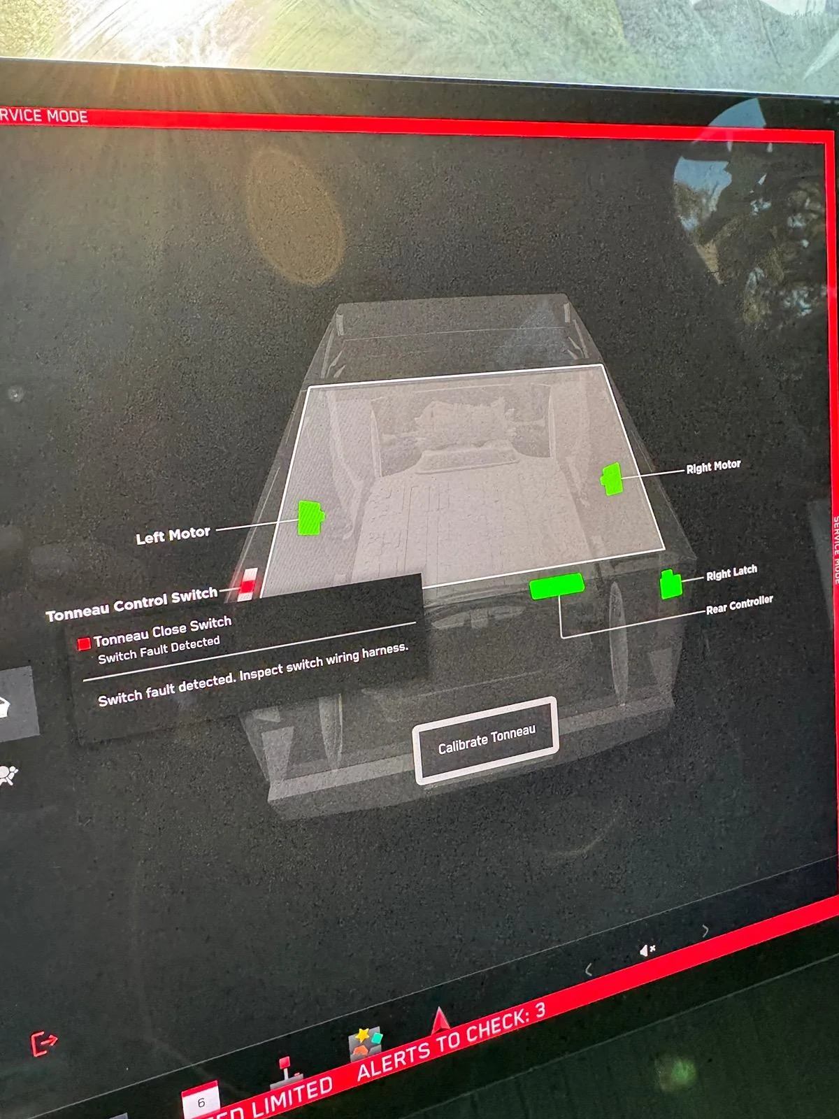

I had the same issue a couple days ago after picking up my CT. I noticed after a car-wash, the buttons quit responding and it showed a "fault" in service mode like this from above. After a few hours in the hot sun, I tried the buttons again and they worked fine so I am assuming the drying from the sun cured the fault. I'll open a service ticket for intermittent failure of buttons

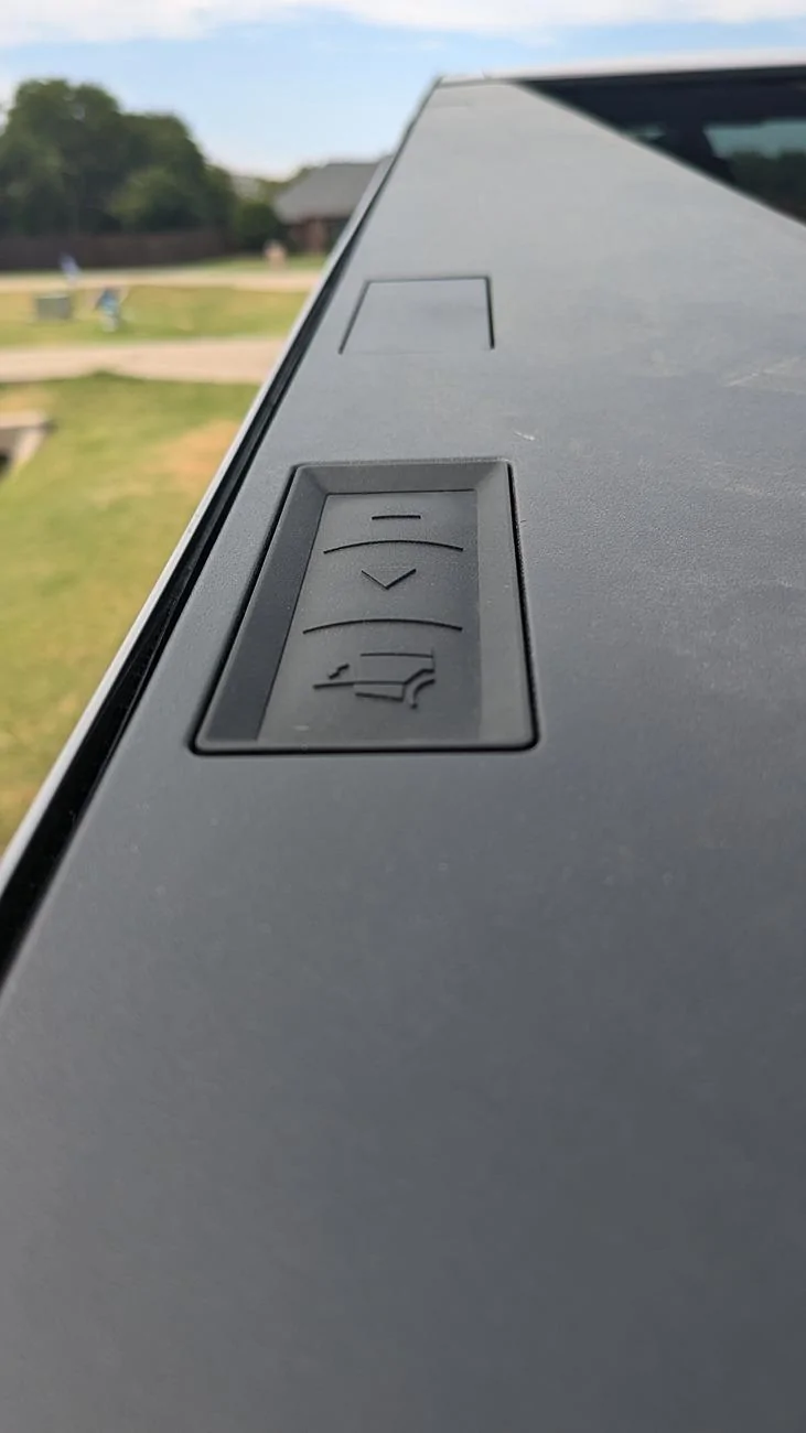

My buttons are still working, but here's what I had going on after a decent (not heavy) rain. The swelling went down and it's currently back to normal, but I can't see this being good/sustainable in the long run.

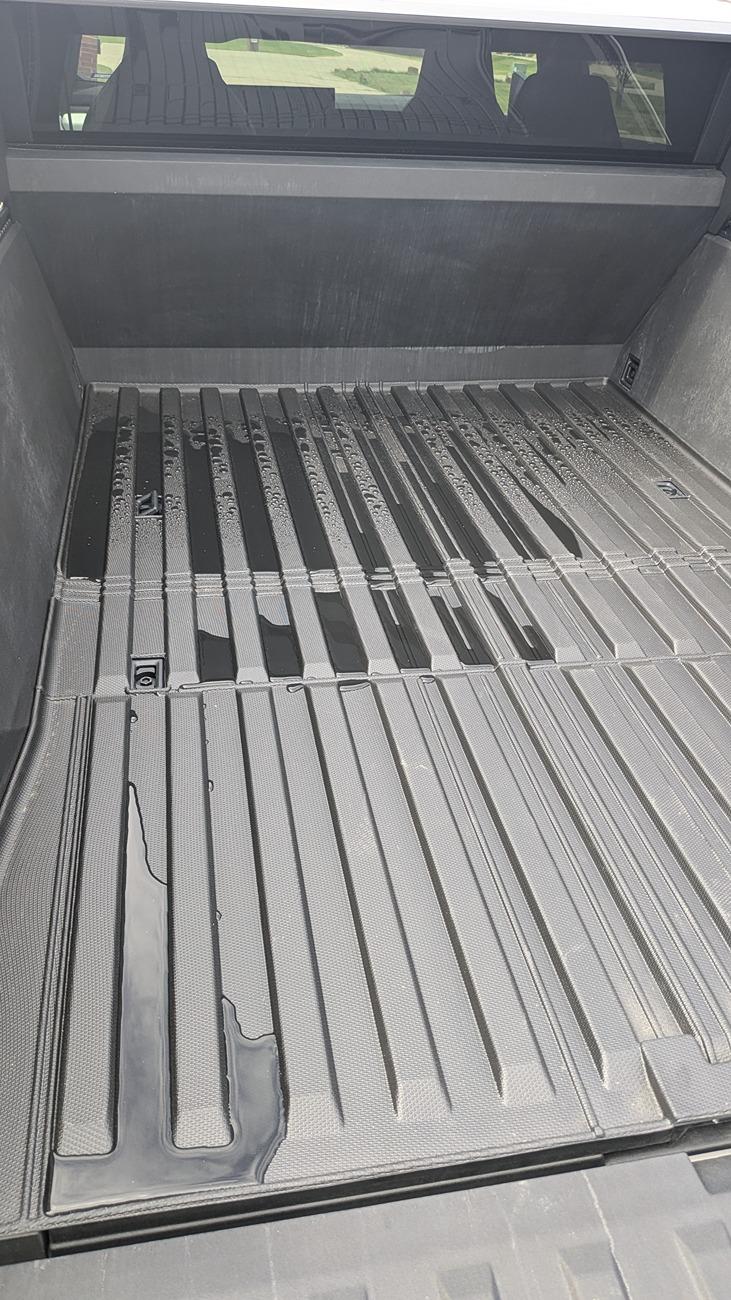

There's also a picture of the water that made it through at the top of the tonneau cover. More than preferable for a 15 minute rainfall.
