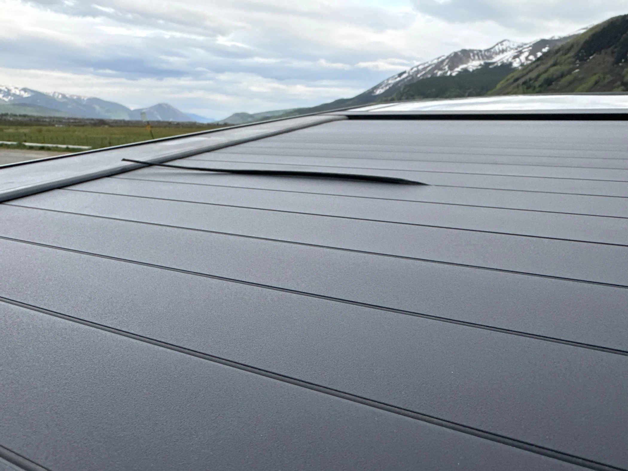

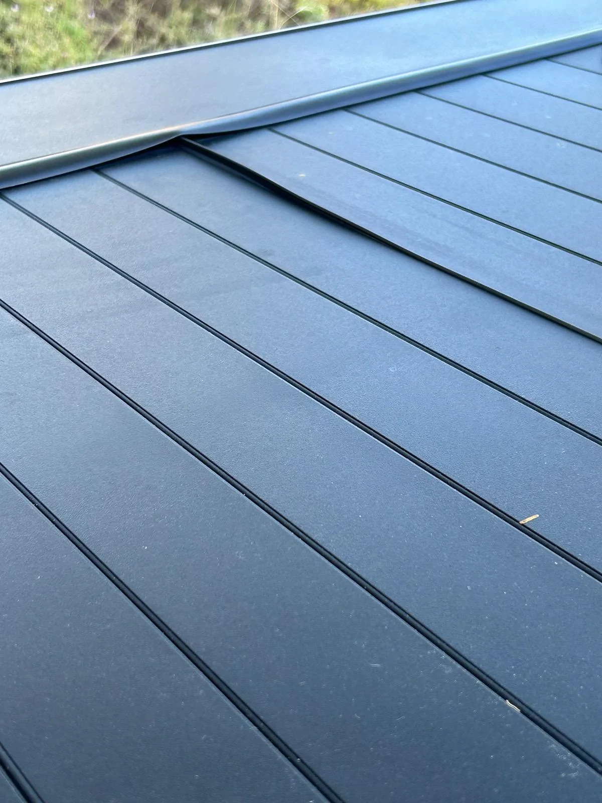

Update, part in transit still. Due to arrive next week so I got my truck back for now.
Ended up cutting off the seal as it was flopping around violently at highway speeds, and I didn't feel comfortable retracting tonneau, lest it gets caught and leads to a track alignment problem.

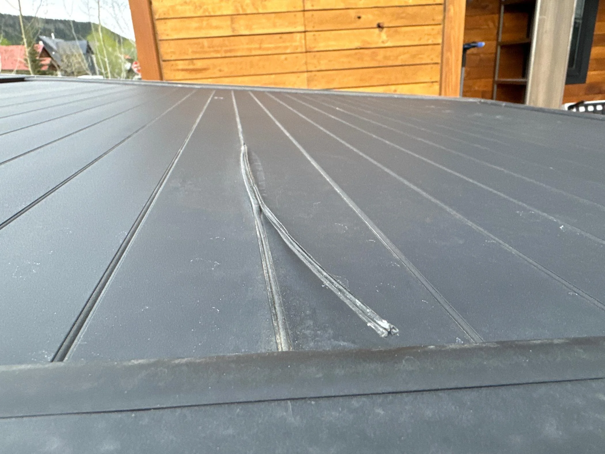

6400 vin
Counting slats from the tailgate the failed gasket is between #16 & 17
