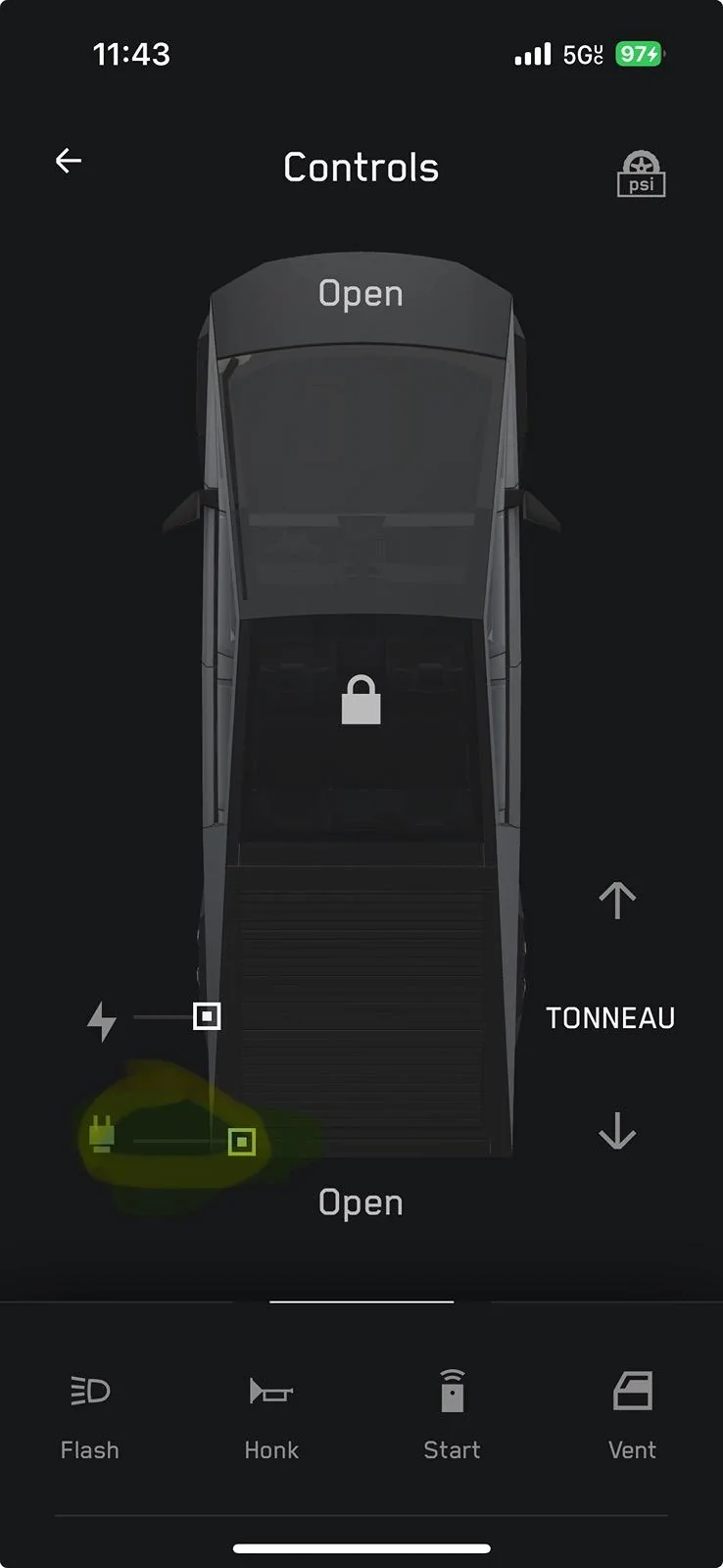

Went out to CT light mist. Was showing features and tonneau cover kept opening
it would stay shut when tail gait was down. Then it wouldn’t respond to close at all at one point
noticed in app on of the outlets was on, turned it off and everything worked fine
not sure I have an actual service issue yet unless it does it again. Highlighted outlet that was on in the screen capture attached.
There have been a couple other owners who posted about phantom openings of the cover, may want to get it checked out. Especially if you store things in it.
