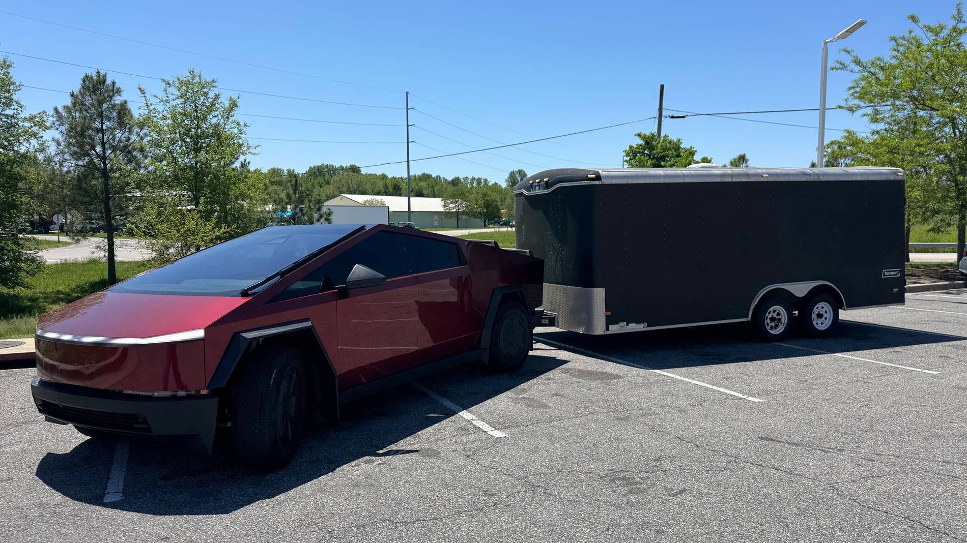

I have towed in two situations that are probably “worse” than your scenario - reported elsewhere on the forum. My box trailer is shorter than yours but has a flat front unlike your pointed front, so has more windage. I towed it three times so far over 150 miles each time, could get 130 miles with a load on (‘52 MG once, so total about 5,000 pounds, loaded with furniture to the top once - total about 7,000 pounds) if really careful to keep it at 55 - just under 800 kWh per mile. In one return trip with the trailer empty I was able to do the entire 150 miles on a single charge - about 2,000 pounds, but still a big empty box. That day I had a slight tailwind.

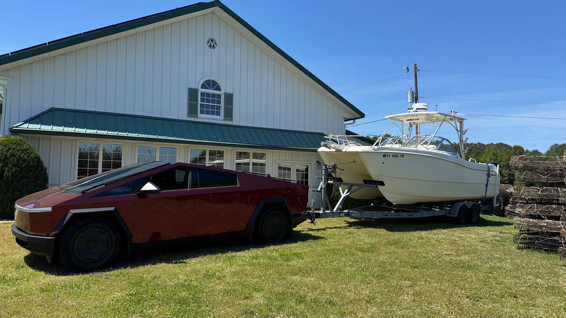

The other time was with my 9,700-lb boat that has a WAY worse front profile, essentially a 12-ft high parachute. That rig is 32’ long. Max range there was about 107 miles - about 1,100 kWh per mile. In both cases (box trailer or boat) my rule going forward is to charge every 80-90 miles, stay below 60, and watch the energy screen for the effect of headwinds. I’d prefer to have the aborted range extender, but can live with this. We shall see if I still have that opinion in November after trailering the boat 1,050 miles from Maryland to our place in Delray Beach.
