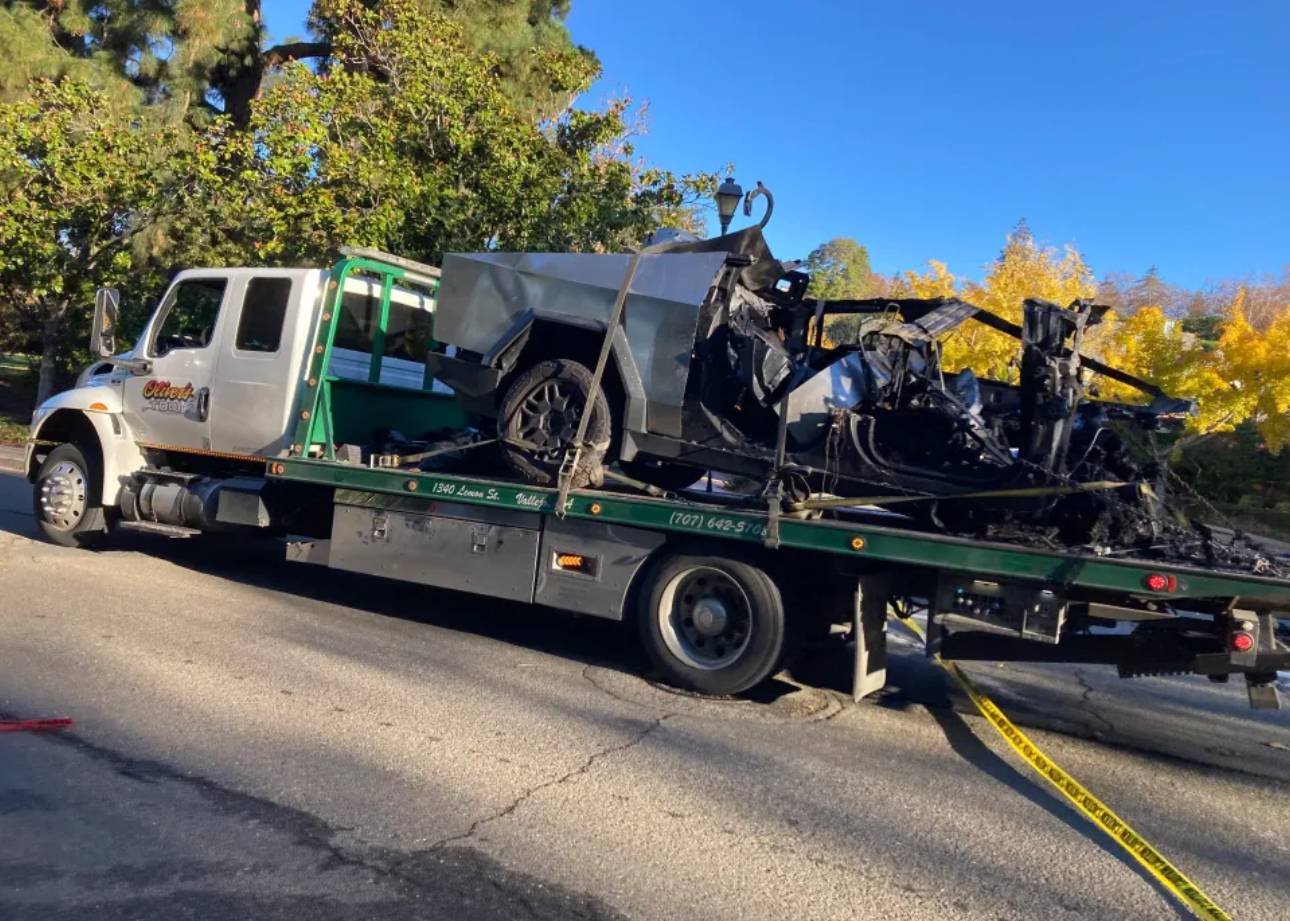

Not to redirect from the tragedy of three people dying in a wreck, but I'm curious about the fire. I was under the impression that, once on fire, EV batteries were nigh impossible to extinguish. If that's the case, I'd expect to see more damage to the tree and surrounding foliage, the tires, etc.
There's a few videos of the local news coverage on youtube. The positioning of the truck makes it look (to me) like they were going too fast and went wide around that curve. Glad the dude following them was able to pull someone out.
Isn't Tesla using some special foam to isolate the cells in case of a thermal runaway ?

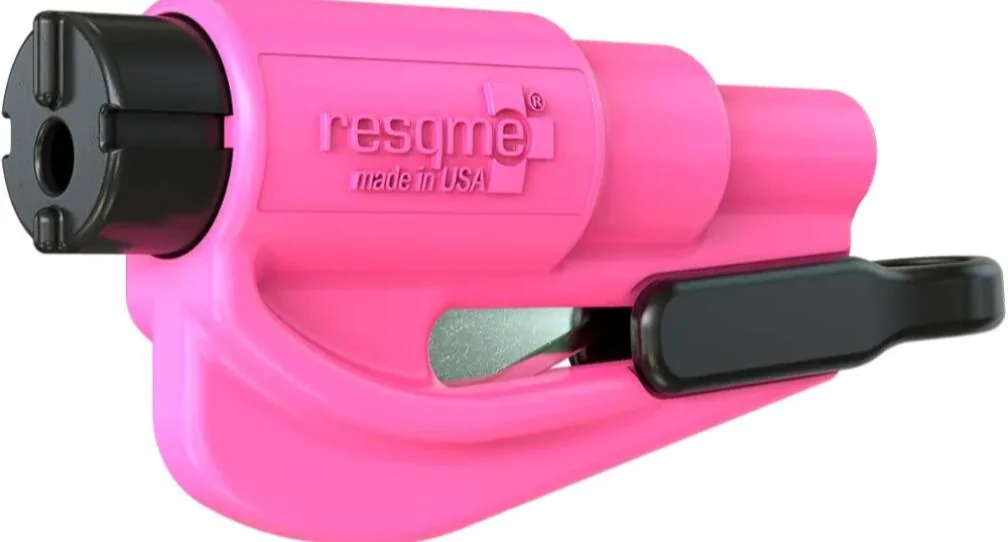

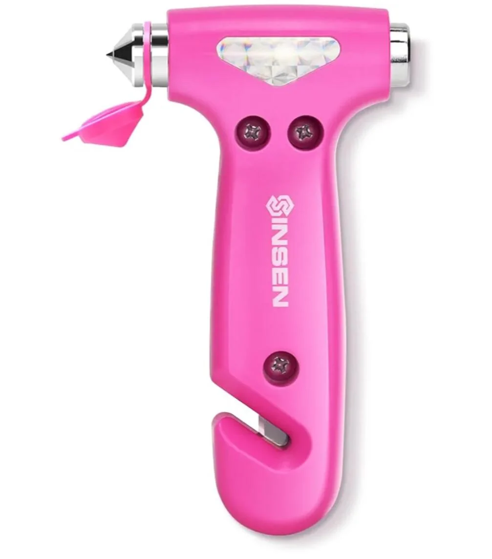

Standard window-breaking tools (ResQme, LifeHammer, etc) will work on tempered glass, but not on laminated glass. The ResQme and LifeHammer websites explicitly acknowledge this limitation.
Laminated glass used to only be used on windshields, but it is now often found on side and rear windows, particularly on more expensive vehicles (including the Cybertruck). Laminated glass doesn't shatter, even if it is completely punctured. You need to puncture it, then insert a saw in the hole and cut out a large hole with the saw. There are manual saws that can cut laminated glass, but they take some time to use. I asked a firefighter about this, and the only tool that he could suggest for fast exit through laminated glass was a battery-powered Sawzall with a laminated glass blade.
Another option: the Rhyno windshield cutter, a battery-powered handheld tool for windshields, should also work on laminated glass windows generally. Unfortunately it starts at $725. Marketed to first responders, not consumers.
