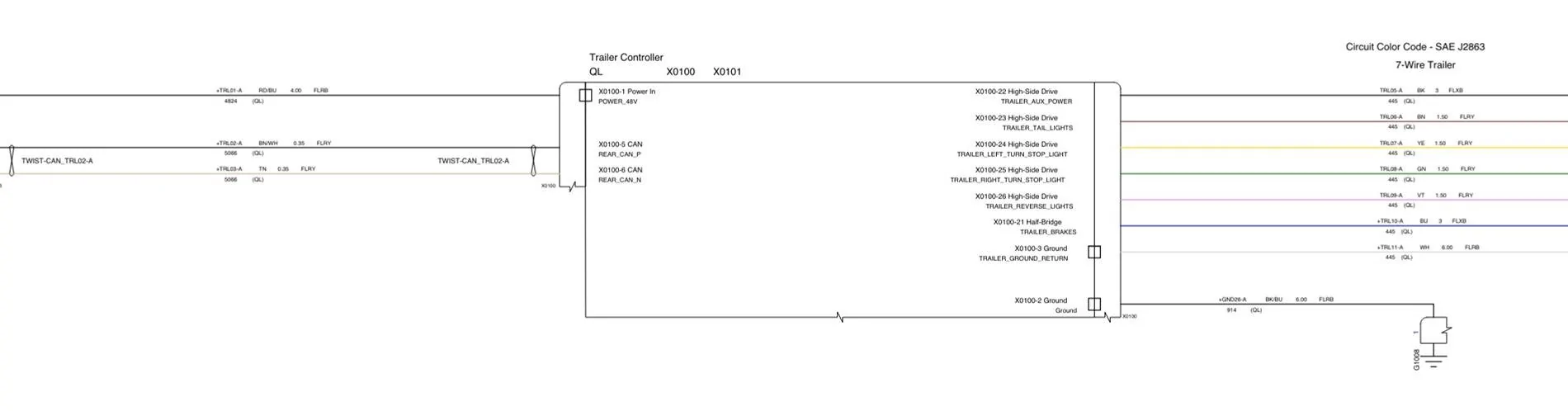

I mean it complained about lights that weren't needed in the current driving mode, but acted happy when in the mode that would jave used them.
Seems backwards.
Either always display red when reverse lights aren't detected or display red when in reverse. Instead, it displayed red when in drive.
Also makes me curious how it determines whether the 4 or 7 pin connector is being used. Guessing load on brake controller and/or aux 12V. If so, a 7 pin trailer with surge brakes and no battery wouldn't get a reverse lamp check.

Uh, I'm pretty sure that brake and backup lights are required period.
So much nicer to be told before you run someone over.
