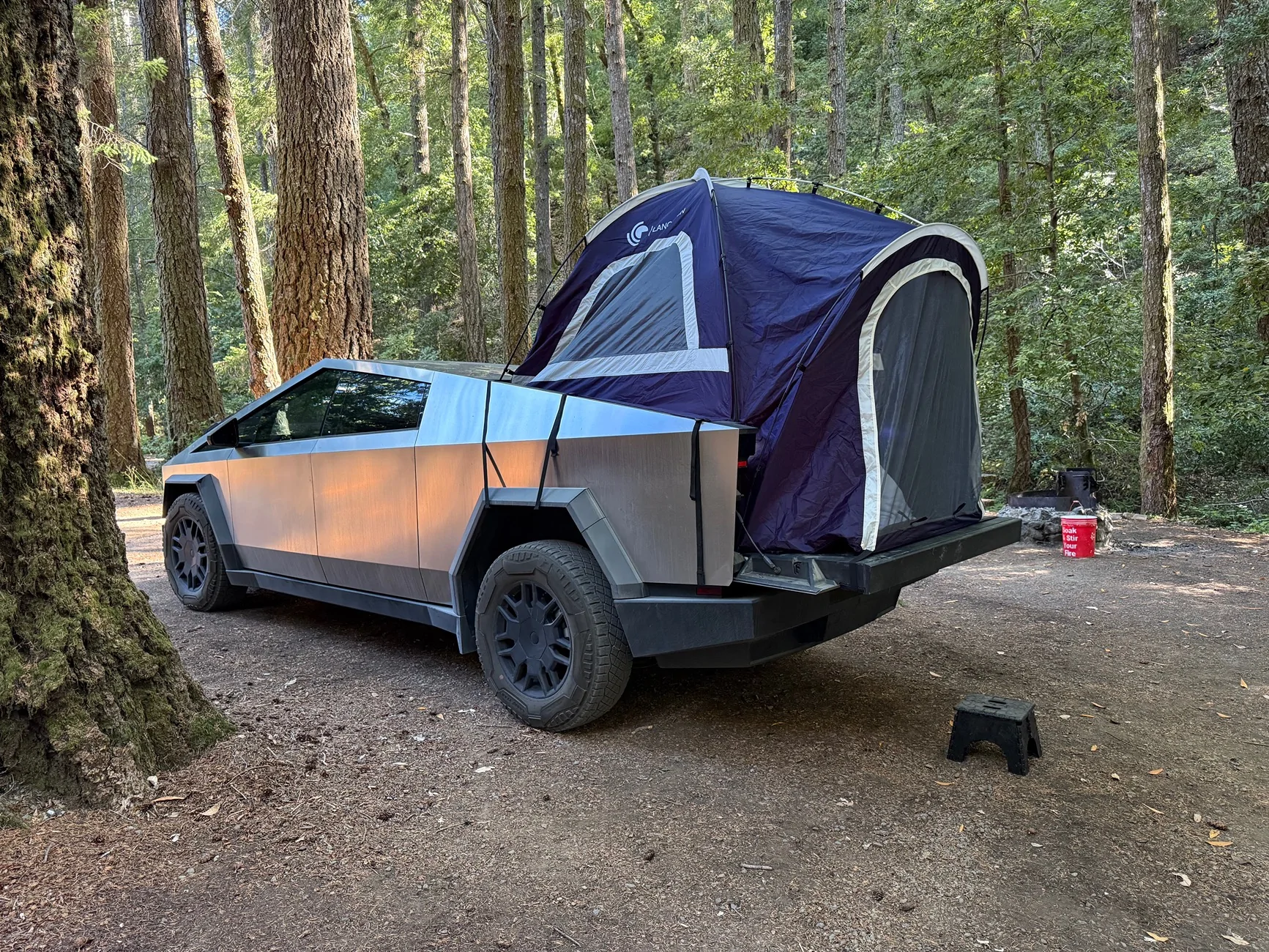

Below is the list of parts I used, I did have some of this stuff laying around, and there are probably some cheaper alternatives, especially for the 2080 extrusions, but I thought they gave it a nice look, and they line up and bolted well to the "shelf hangers" I used for the drop down.
With the below really not much modification needed. Really just two or three things:
1. You have to cut the 2080 to length which is a bit tricky as the bed is not square and the side has some flex to it, so to get a tight fit you have to cut just a bit long.
2. You have the bend the shelf hangers, I just placed the short end in a vice and bent the arm, eyeballing it.
3. Optional cut the u bolts to get maximum clearance under the tent.
I think the build is fairly straight forward, t track bolts go in the t tract, rails supports (shelf supports) attach to the t tract bolts. The 2080 then bolts to the shelf supports (holes line up). Place the tent on top, and use the u bolts secure. Just have to get skinny to get underneath to bolt it on. Probably take 2-3 hours. I am sure everyone on here will have even better ideas/improvements. I am interested to see what everyone does with it.

Tesla Cybertruck Truck bed tent solution w/ custom tent mount IMG_1556

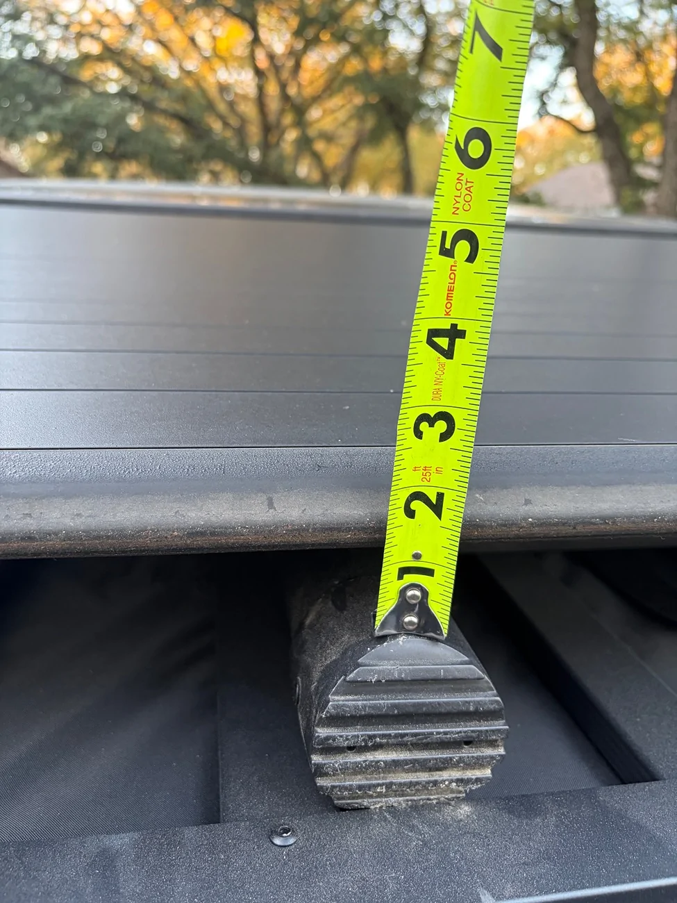

Thanks for posting the updated links. On the rail supports, if you went 6 inches instead of 8, do you see any snags or issues? Thinking of maximizing utility underneath for storage.
Also, did you look at any other tent options? Been browsing the internet for a few alternatives, although the one you posted is the best I can find so far. Especially for the price.
You might be able to get away with 6 inches but it would really be close to the cover, if I can tomorrow I’ll take a picture of the clearance. I did look at several tents, but this is the only one I pulled the trigger on. Seemed like the best fit.
Don’t think the 6inch drop would work maybe an inch clearance on the cover

Thanks for all the info and support on this install. I've been looking for an option similar to this for well over a year now. Love everything about it. Any chance you can throw some more photos up at some point? Interior shots, light on/off, and lastly a shot of the clearance under the unit? Just trying to gauge how much space is available for storage underneath.
, also forgot you do have to drill out the holes on the shelf supports a bit to fit on the t tract bolts
