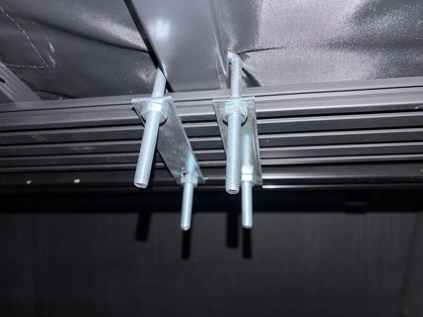

Hey, I just have one question left. Putting my cart together on Amazon (using your referral links) and cant seem to understand the ubolts??? Does it require the narrow and wide ubolts or just one kind? Also, how much could you trim off? I see a few different ones that come in different lengths from other sellers. Maybe something that would prevent me from having to cut them. Thanks

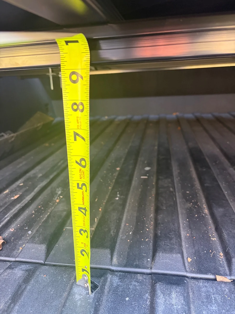

Her are a few more photos, with clearance, photo from inside looking out.
Tesla Cybertruck Truck bed tent solution w/ custom tent mount IMG_1586
I was trying to put together a list that would cover everything, the narrower bolts go across the frame on bottom of the tent and I used the wider plates from the wider u bolts to go across the mounts. For sure could just cut and drill some flat bar stock to do that part, just simpler to buy. I think the narrower should be about 75mm long to cover without having to cut, but I don’t have an exact measurement
