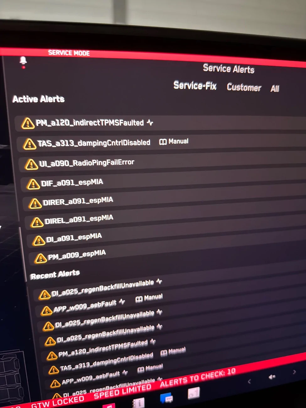

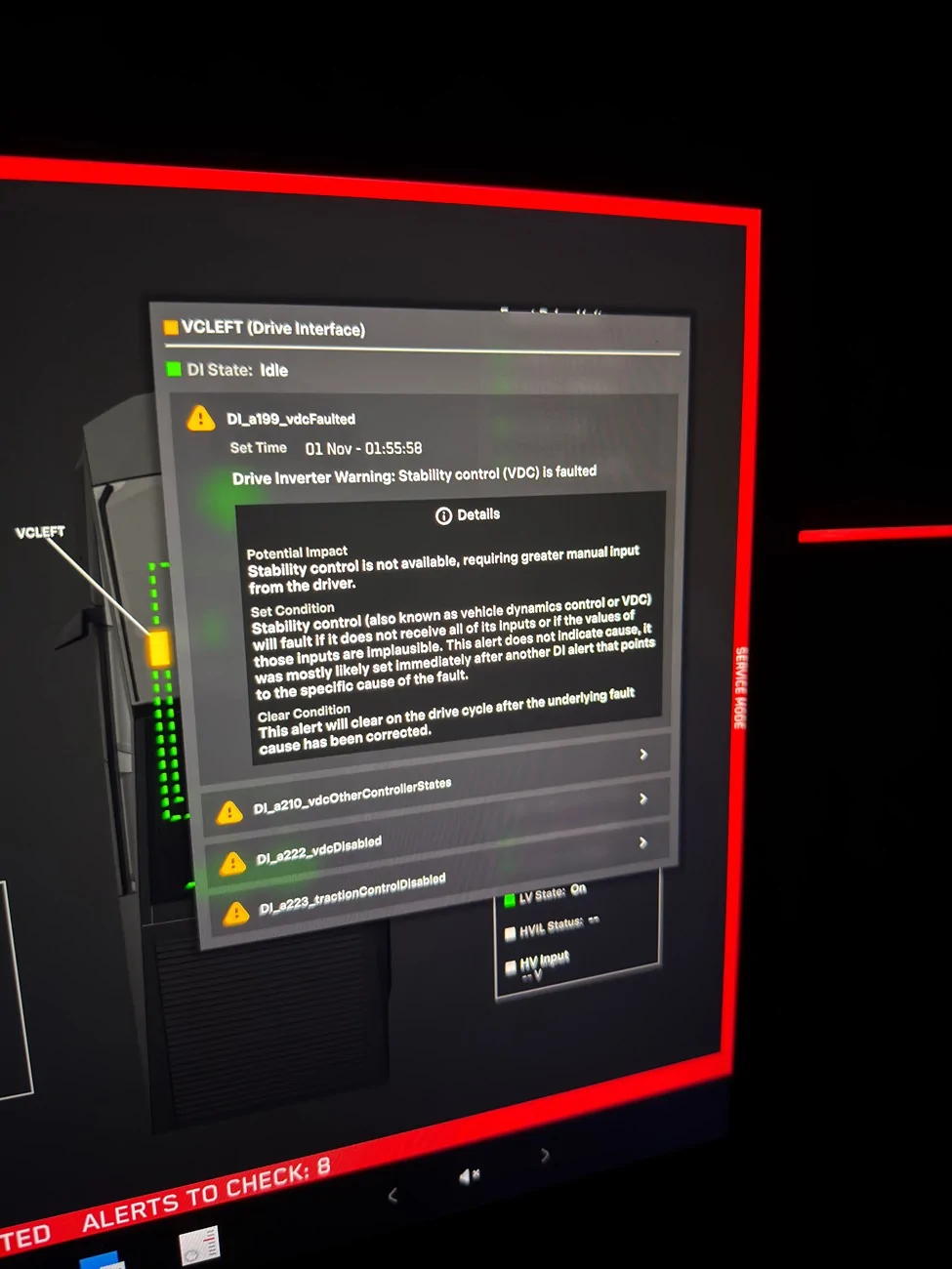

God wanted to punish me tonight, so he completely disabled all safety features and fsd on my truck. Anyone know what the issue is/how to fix it? I parked and came back to all these errors, I didn’t hit anything nor mod anything. Ignore the radiopingfailerror, that’s my fault

My best guess for this is that one of the etherloop endpoints (or wtv they’re called) lost connection for a second which led to those specific faults. This is great though as it shows how the truck can still perfectly operate with communication faults, a big thing that snark subs like cyberstuck shat on the truck for.

All the espMIA failures are from the Hydraulic Brake Unit/ ESP not responding. So likely either it died, or its power feed did.

Happened again smh, my theory is that the drive unit or whatever piece it tries to communicate with doesn’t wake up in time which makes it look like it’s offline to the system when it does an initial ping. This time I was able to fix it by hopping out of the truck and hopping back in, which I guess pings the failed parts again? It still said traction control and other stuff was failing until I put it into drive, where it acted normal again.

For the modding, I realized that I disassembled a diagnostic port on the truck while trying to pen test it. I also haven’t updated my gateway config to support my replacement radio (as you can see in the og screenshot under the radiopingfailure warning). Someone in an older thread of mine mentioned that doing that could fuck up the etherloop… YOLO. As for service, my center is very slow in my many experiences with them and I don’t want them to permanently mark that I’ve fucked around with my truck. I can undo all the mods, but i’d much rather not go through the whole process of uninstalling and reinstalling unless I really need to. I can deal with needing to hop in and out of my truck once every month.

You can try getting a sub to service mode + which is what the SC’s use for real time i/os and diagnostics. You gotta have a real good understanding of what you're looking at though or you will really mess up your vehicle
