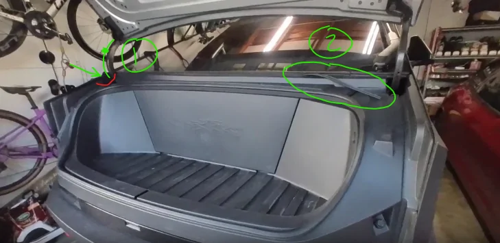

I have this problem too. I caught it on video.
1. At one point, the ribbed cable and clamp on the left arm was rubbing against the center plastic piece after I got it back from service. It didn't keep mine from opening, but I wonder if you were to try to peek inside when this problem occurs, is this part getting caught?
2. Rubber seal is obviously hanging, but I doubt that would keep the frunk from opening.

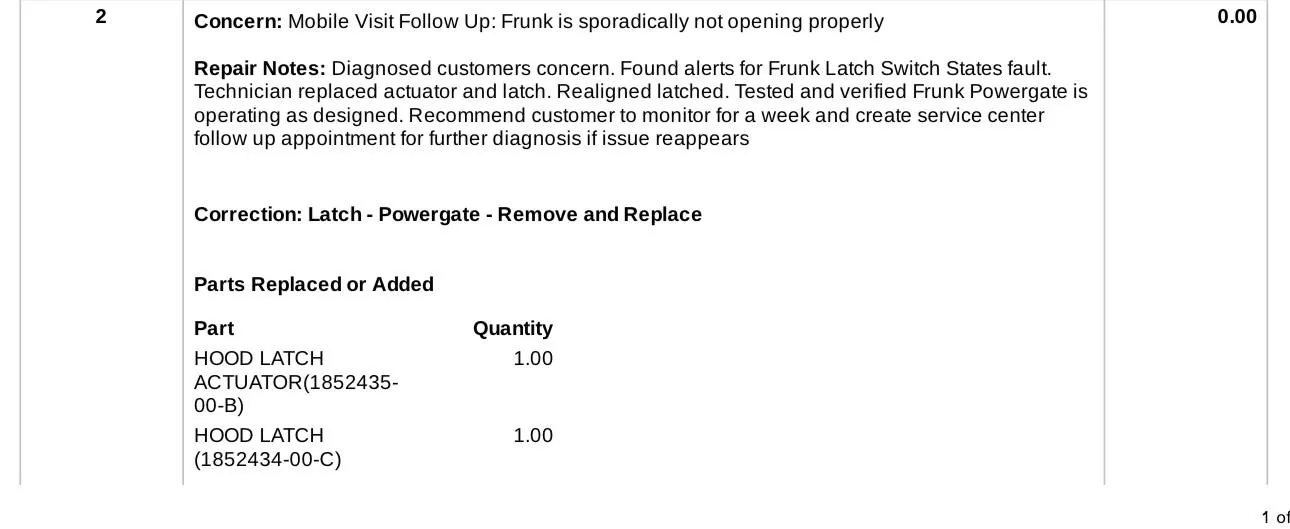

Mobile service came to fix my chair adjustment button.
I showed him the frunk being stuck video in the previous post. The tech agreed to replace frunk parts even though I couldn't replicate the issue to him in person.
this is the invoice for the replacement.
Opening frunk sounds totally different after the replacement. It sounds a lot softer now. It sounded like something got shot up very hard before.
