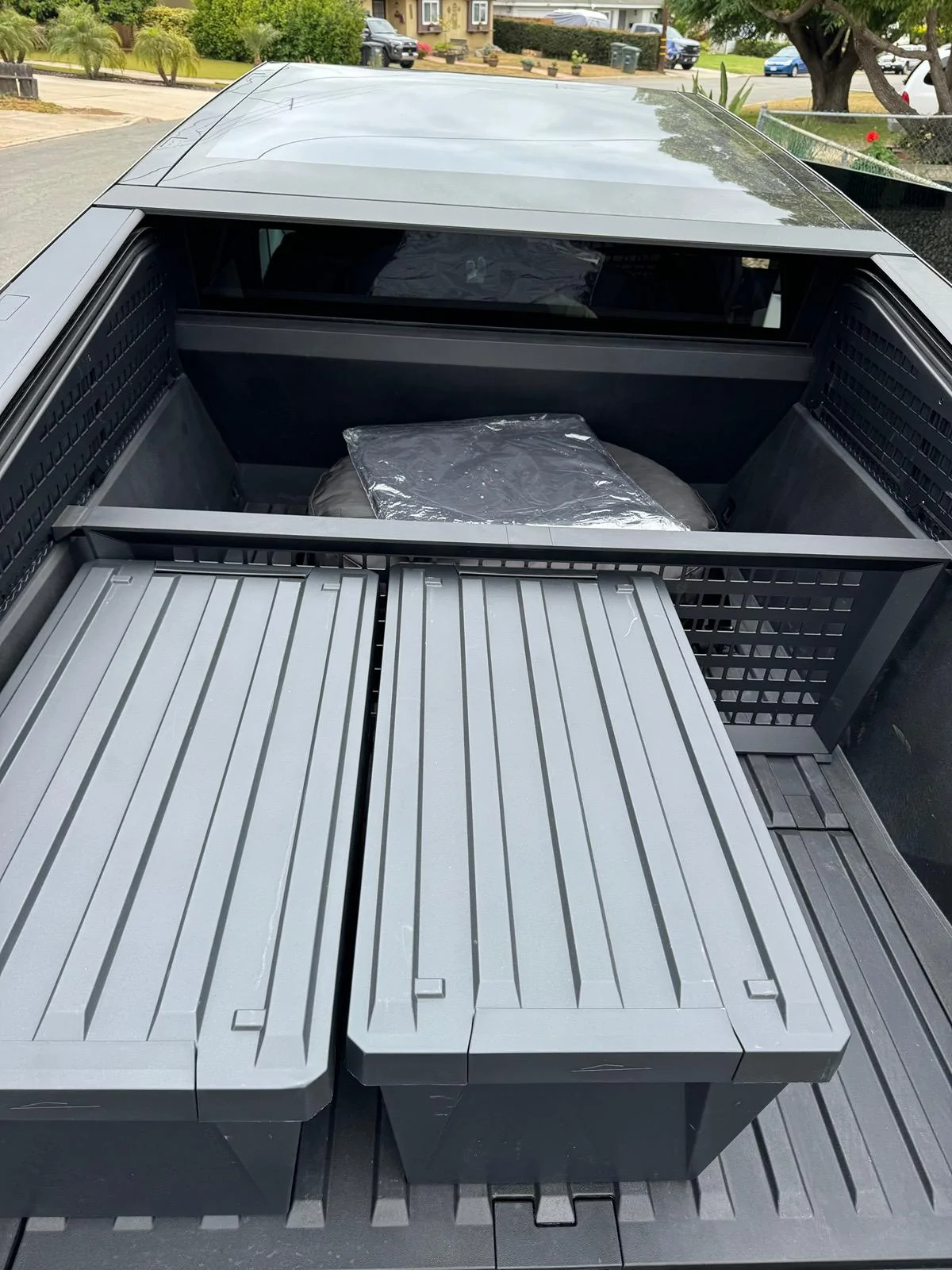

I would disagree with your assessment. I compete in powerlifting and have placed in nationals repeatedly. I'm also an older past full time mechanic - so semi decent with my hands.
I think if I'm having a hard time with it, the average dude probably will as well. Fits easily and as expected above the underbed storage. Past that line, easily or forcibly (without causing damage to the truck or the divider), it simply doesn't fit.
My appointment is 7/1. I'll keep you guys posted what the service center tech says. I would skip on buying this specific accessory for now until they can get it resolved.
>> How long did yours take to get? I ordered over two weeks ago and UPS still says “created label” and thats it. I know the Tesla Standard Time is in effect, but come on, give me my damn bins!
Took about two weeks. Said it was in stock, label was created and then on the UPS website --> delay status was given.
Well, probably I forced them to install them there and I am damaging something . I made sure they attached properly, I just needed to press one side down after attaching the other side to make it go into the rail.

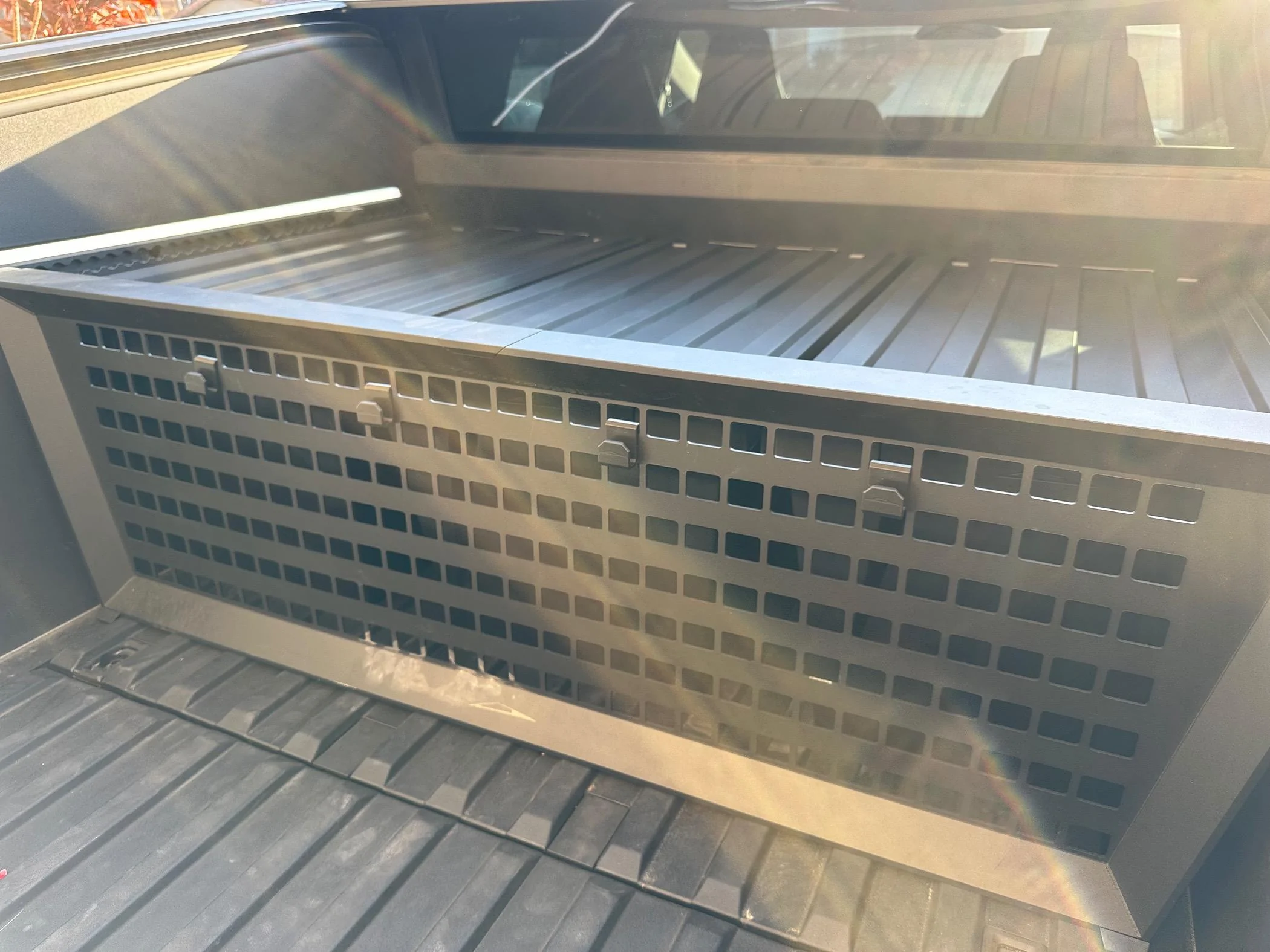

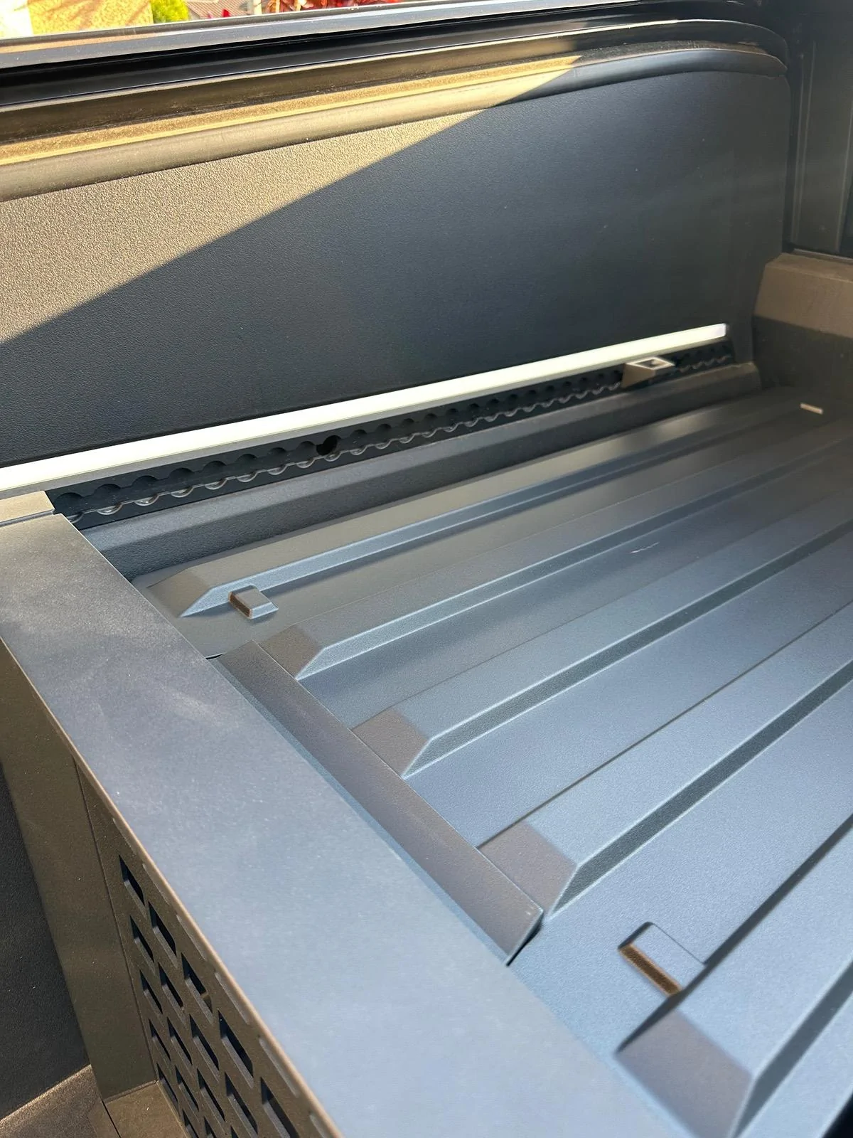

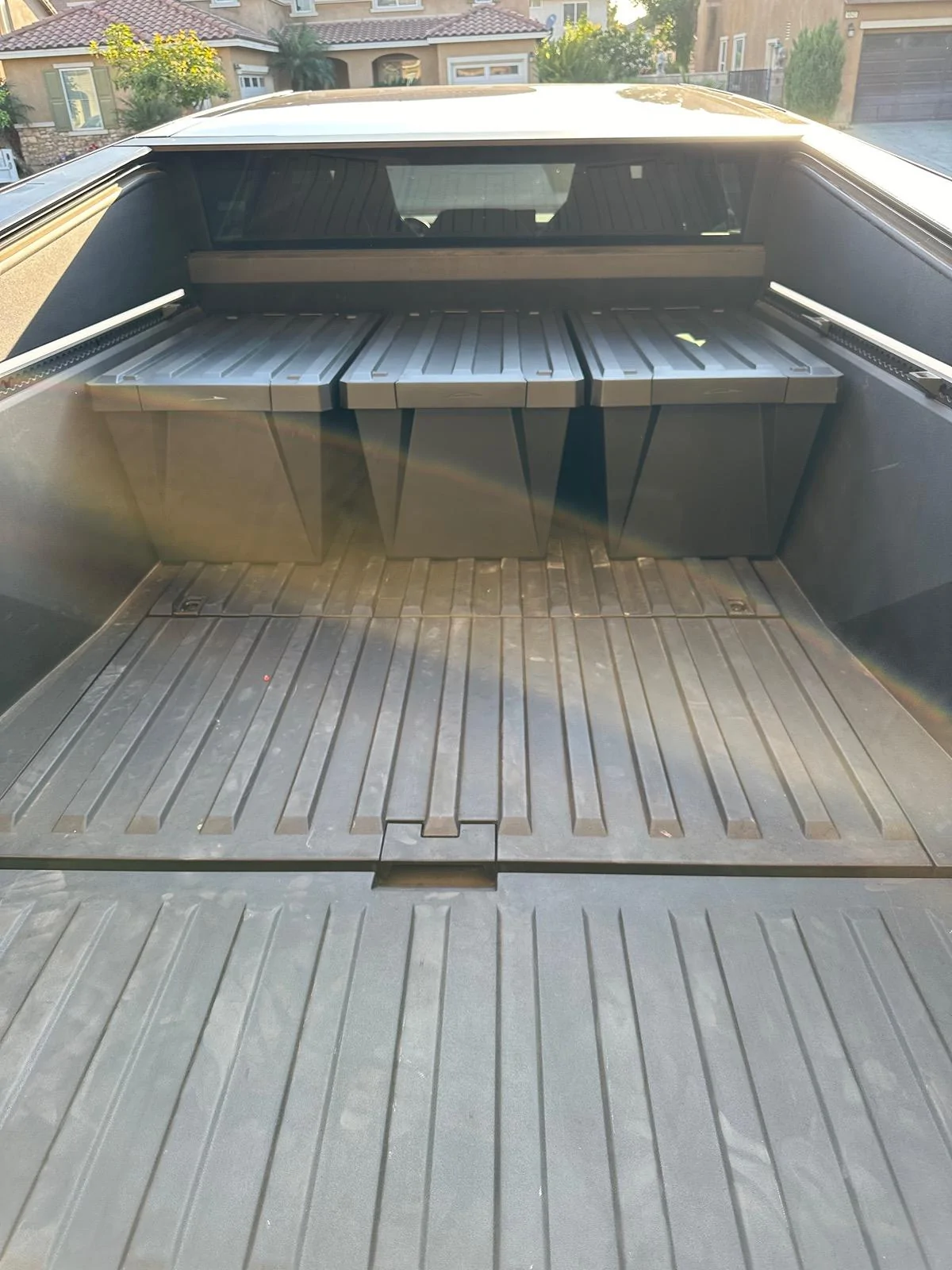

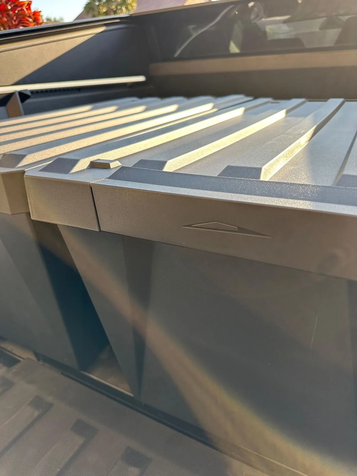

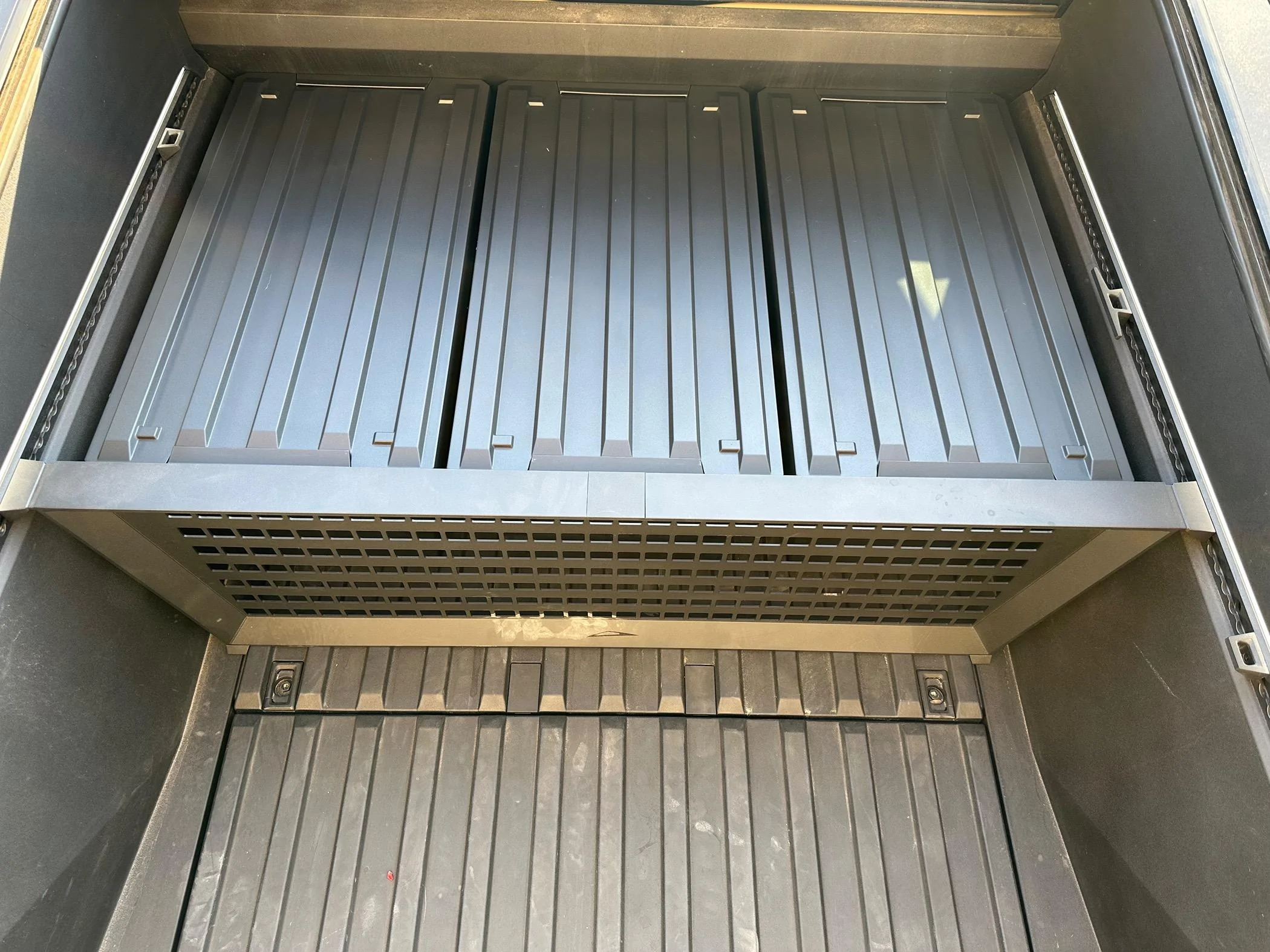

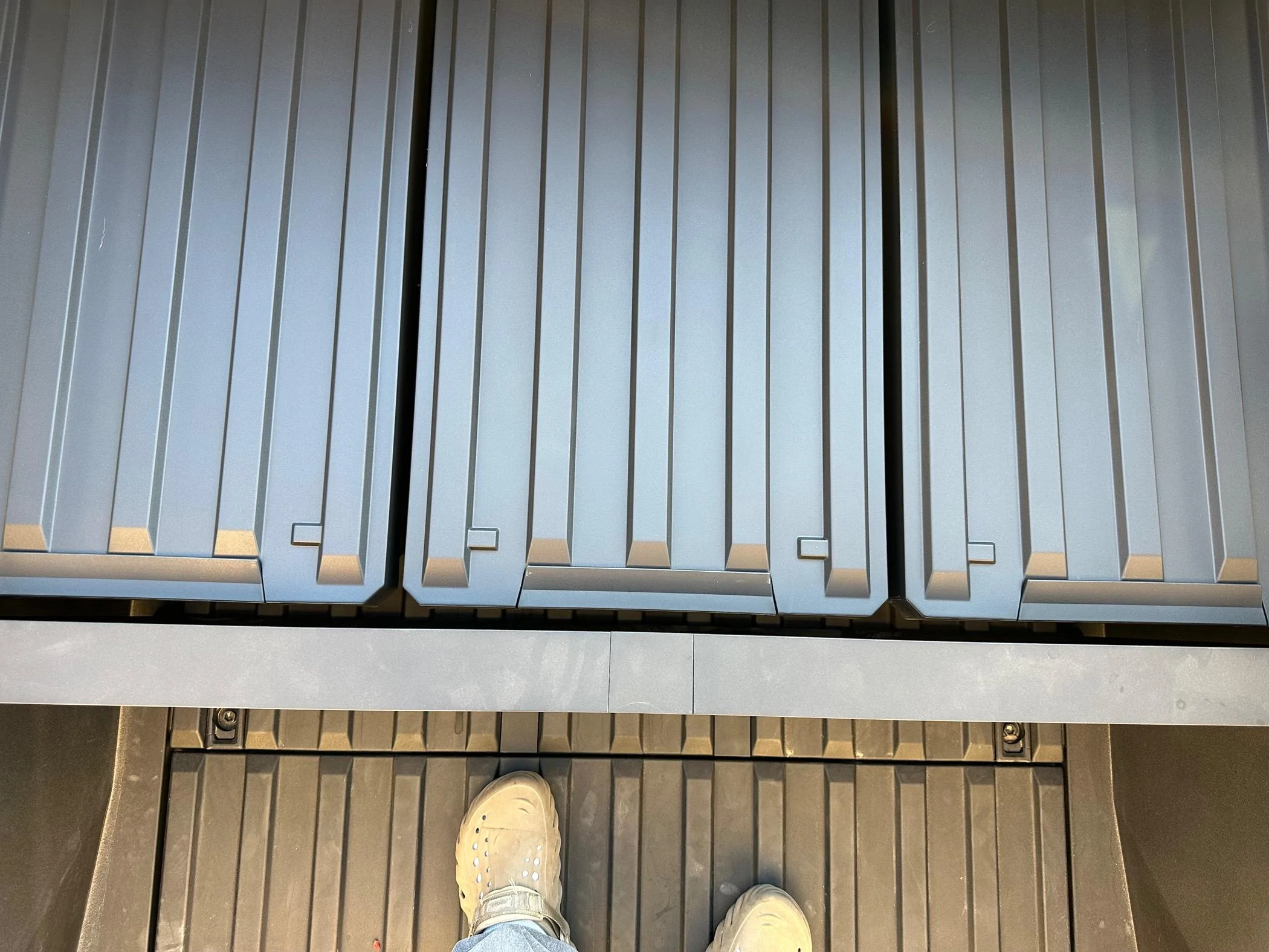

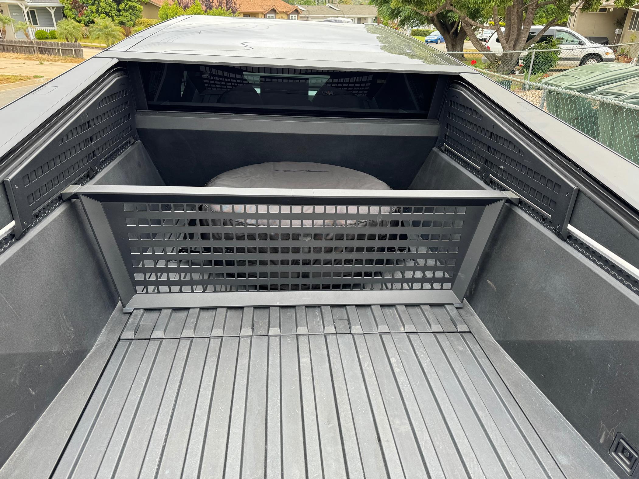

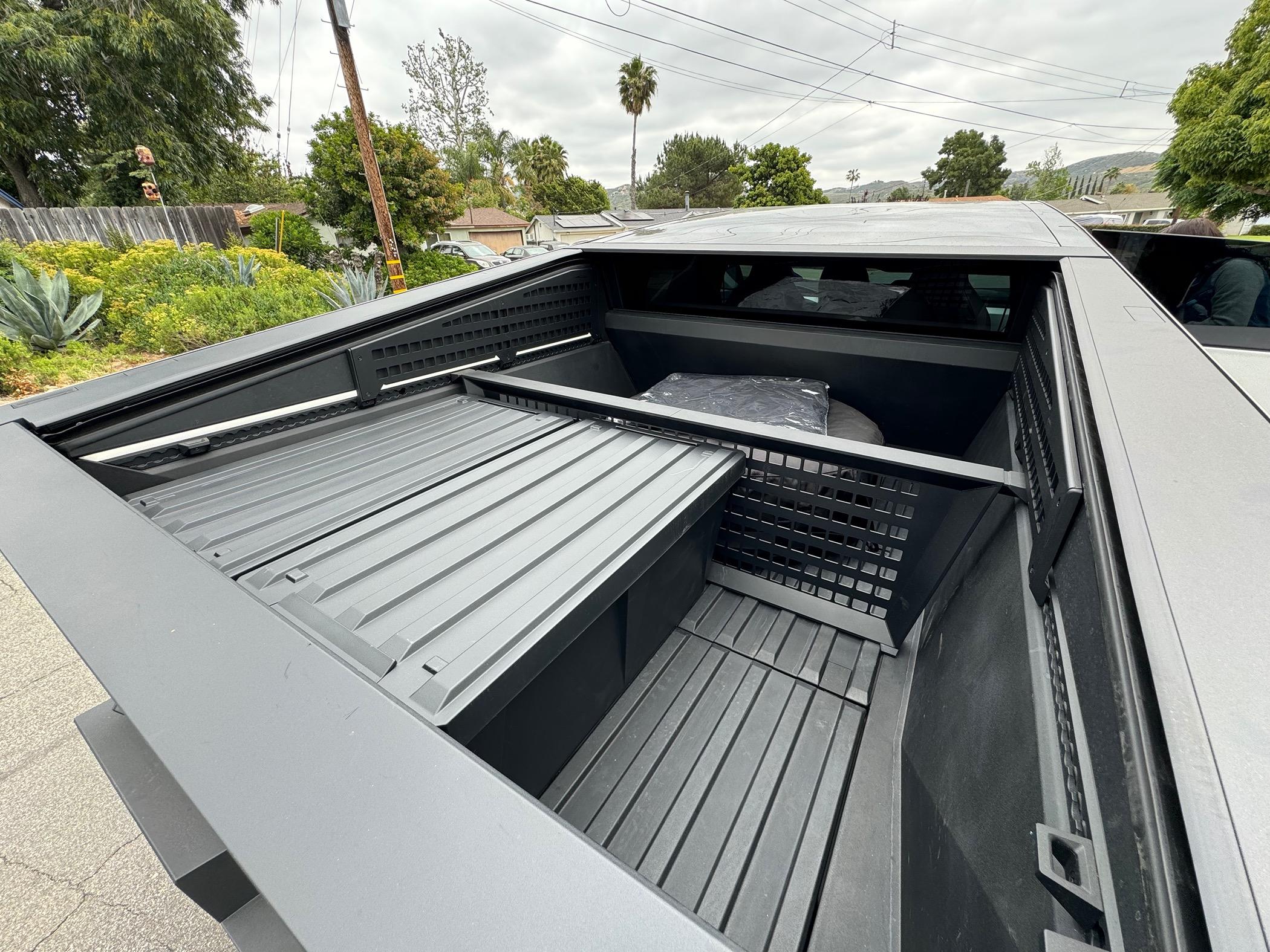

1. Came in a huge and heavy box
2. Feels like durable, strong, good quality

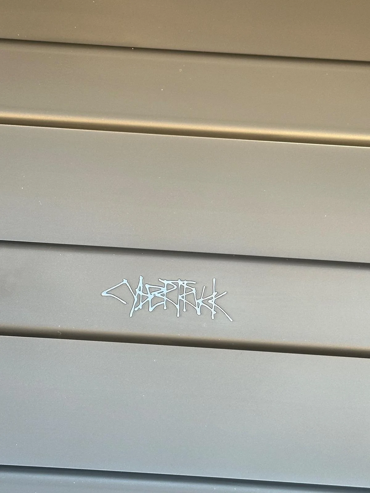

3. Nice little branding and details
4. Covers fit on snugly
5. Easily slides to the back of the bed
6. Vault divider keeps them in the back half with a tiny bit of room in between. (Wonder if they’ll slide a bit.)
7. Keeps the Cybertruck aesthetic and theme.
8. Still a bit overpriced
9. Can use L-track above.
10. Best packaging yet. Really kept everything from being scratched on delivery (even though it will be scratched in use)
Ask any questions you may have. This was easier than making awhile YouTube video and I know some of you wanna get straight to the point.

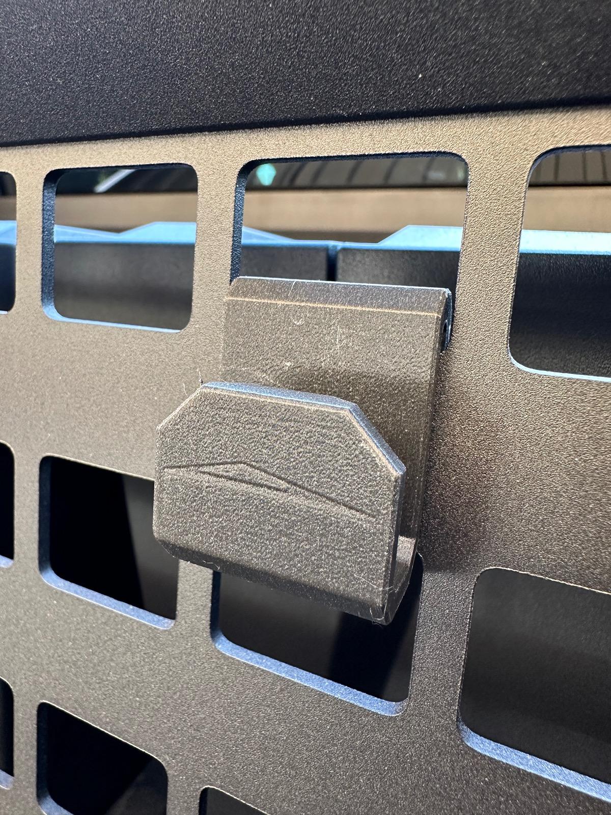

Bonus: added some TWraps MOLLE hooks to the cargo divider. Kinda like these.
Are they going to slide if I don't have the divider?
