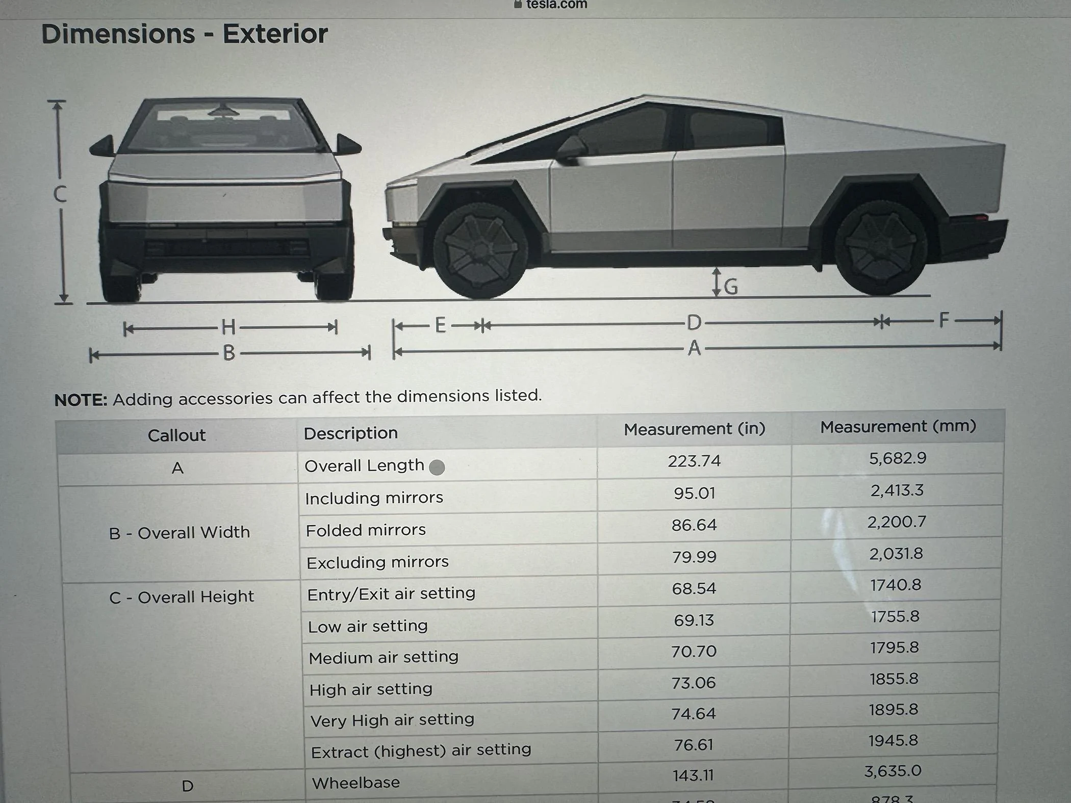

For the lucky ones already in possession of their Cybertruck, I'm trying to understand if I need to modify my garage storage prior delivery of my Cybertruck so that it can fit in my garage.
I have a wall mounted storage which sticks out 37 inches from the wall. It's about 4 ft high.
I'm wondering if I can park the truck all the way to the wall front first, or back first (in Low suspension mode or Entry mode).
See the attached diagram:
- dimension A is 37 inches from tip of front bumper and back bumper.
- I need to understand the measure of B and C. If B hits the windshield wiper, please add that to the measure.
Let me know when you measure it if you're in Entry mode or Low mode.
Really appreciate if you have a few minutes to spare to help me figure out placement of my Charging plugs, etc. THANK YOU!

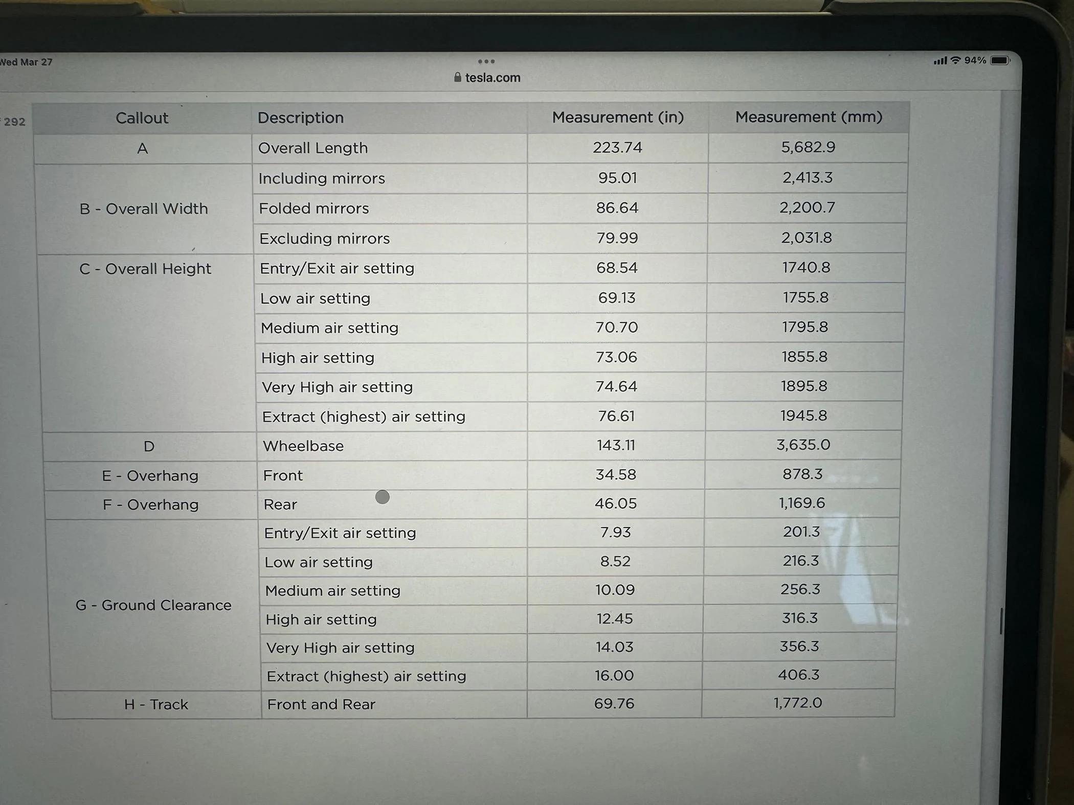

Thank you, but this doesn’t answer my question. I need the height at very specific points (37 inches from front and 37 inches from the back.)
i could try to figure this out using these side shots and extrapolate dimensions but I’m not sure how accurate the geometry of these views is.

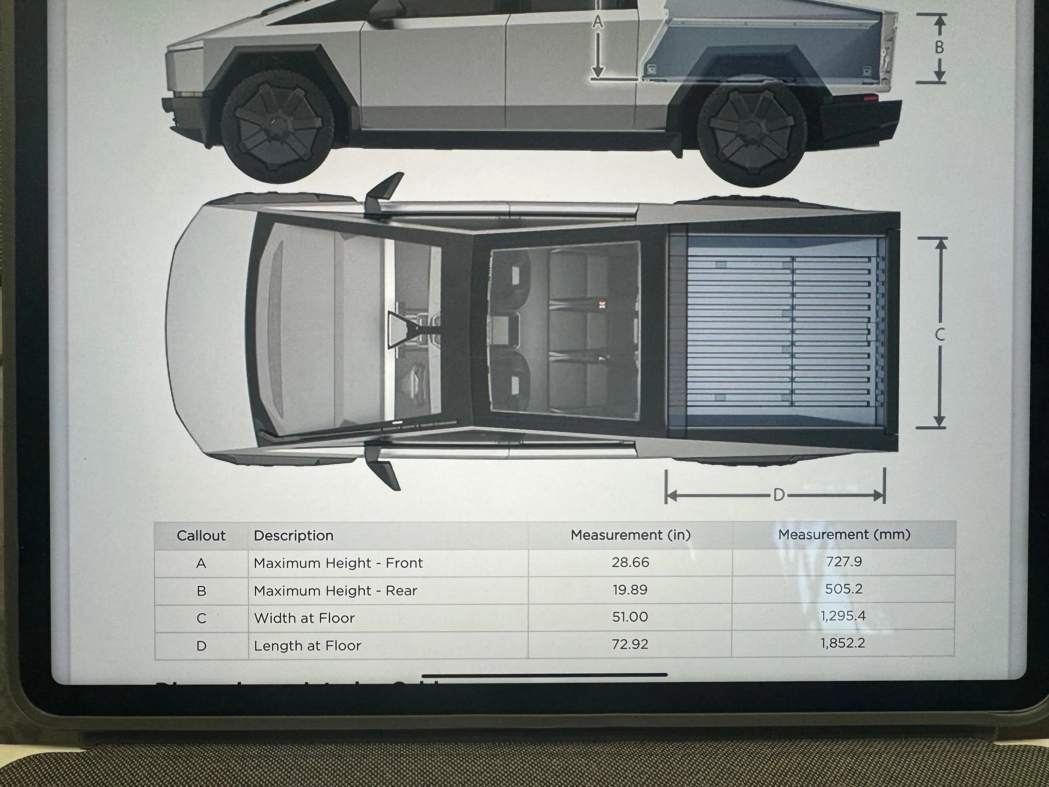

I wish they had more dimensions in their docs, like floor to top of tailgate, that’s missing. Floor to top of frunk, missing.
