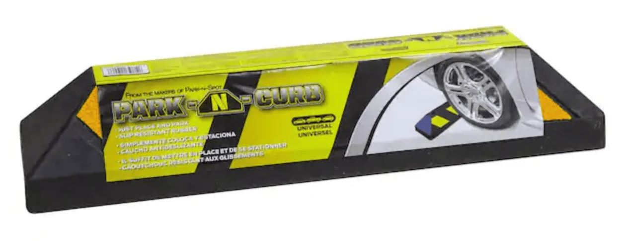

I found this type of device to be the most fool-proof method to park in the exact place that allows my garage door to close with a defined clearance:
Bolted to the garage floor with some substantial concrete anchors, with the vehicle eased up to kiss them, they will stop you at exactly the same distance every time.
Downsides:
That spot in the garage is then dedicated to the CT because of its short front overhang.
Tripping hazard when the vehicle is not there.
Installation really needs a hammer drill and good concrete screws.
