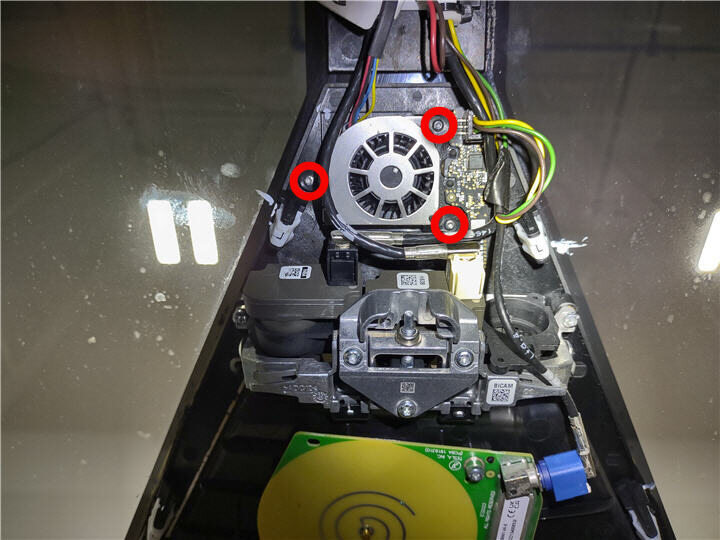

Interesting guess! (There's a fan there?) But it only happens at 72 to 80 MPH? And only intermittently? Not constant sound like a motor/

You said it happens when it gets hotter, so maybe the fan is failing at the higher temps? I've had fan bearings fail on PCs and appliances that sounded like this. I would post your video in the Tesla app and request service.
Yup. there's a fan.

There's even a Service Bulletin to cover a noisy fan condition:
https://service.tesla.com/docs/Serv...SB-24-10-006_Rework_Windshield_Camera_Fan.pdf
"Condition
On some Cybertruck vehicles, the windshield camera fan mounting bracket does not meet Tesla specifications and might cause the windshield camera fan to emit a buzzing or rattling noise.
Correction
Upon customer complaint, install shims on the windshield camera fan, and then test the fan. If the noise persists, replace the windshield camera fan."
If you want to replace the fan yourself, it's only forty bucks.
