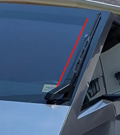

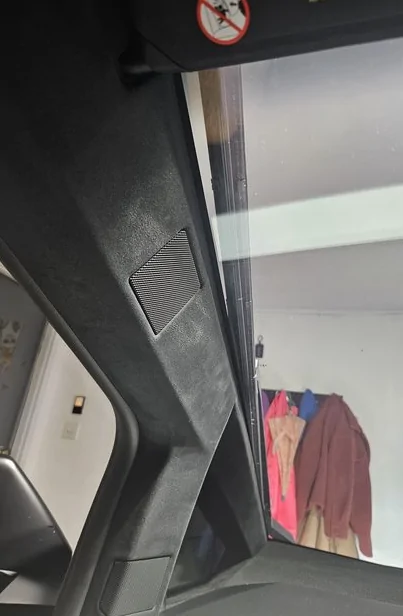

If I remember correctly, my FS 2024 wiper home position was that the wiper was not visible from the inside, like this:

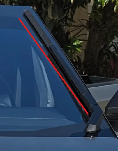

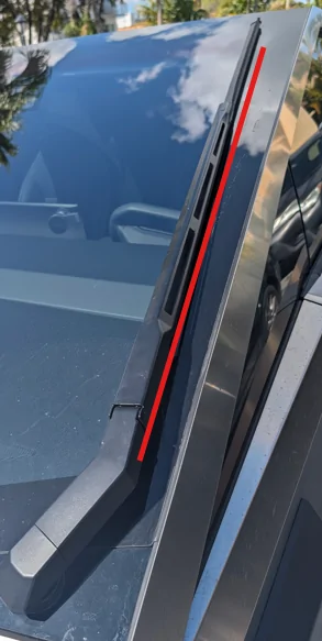

Even after the initial wiper motor recall was done, the wiper was still parked out of the view. My new, high 70K vin, always parks the wiper that it is visible from the inside:
like this user posted in an old thread (HERE)
What's your wiper home position? Visible from the inside or not?

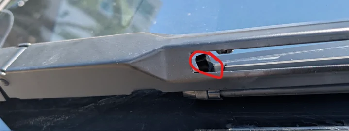

I think it should be possible to unscrew the arm from the motor shaft and re-attach offsetting enough so the wiper is out of the view but.... my FS had this horrible rattle while traveling at highway speeds generated by this nubbin at the bottom of the wiper:
the airflow would make it rattle, touching the wiper arm, but because of windshield sound isolation, speed, and wind, the rattle always appeared coming from right above drivers head, or the C pillar between the doors.
So, part of me wants move the wiper arm, but it doesnt really affect anything, just my mild OCD; the other part tells me not to touch it.
If your wiper arm park position is out of the view, do you get any rattles?

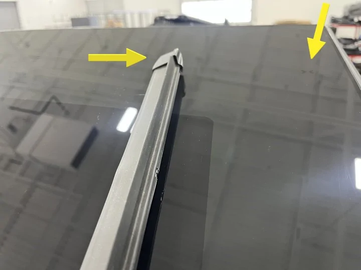

Service manual says there are alignment marks on the glass
https://service.tesla.com/docs/Cybe...UID-79B87D3B-A602-47F6-8682-B1F02F8637A4.html
Tesla Cybertruck Wiper home position - is the wiper visible from the inside? GUID-52BCF61C-6498-4F55-914A-044F2F8FC88D-online-en-US
Tesla Cybertruck Wiper home position - is the wiper visible from the inside? GUID-6B629C2A-6521-45ED-9EA7-349A918017E0-online-en-US

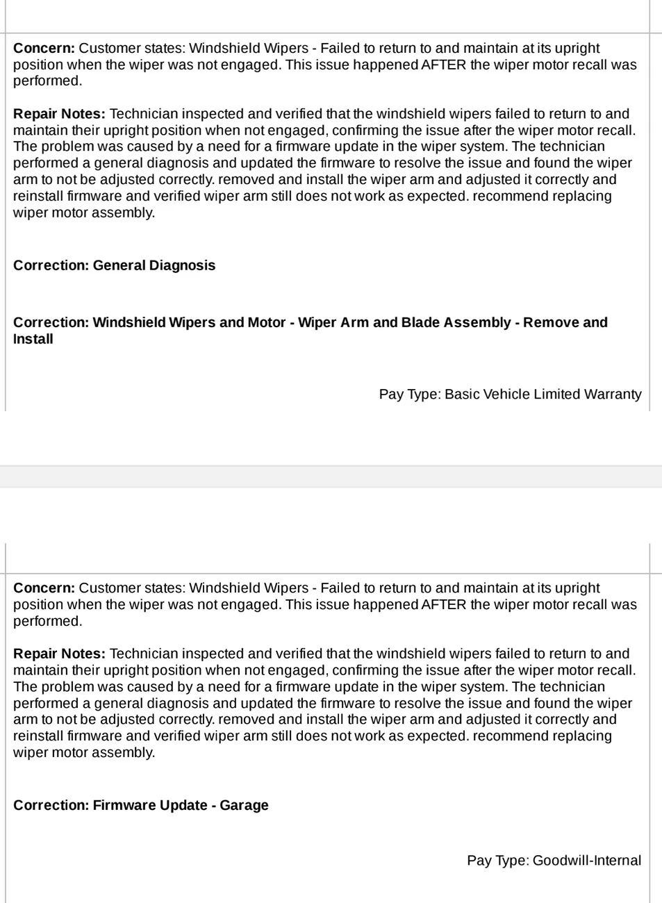

I concur, I had the same experience when they replaced my early 2024 FS AWD wiper motor as part of a recall. The wiper would pop into view when driving above 30mph, it looked awful.
I took it back and had the service center calibrate it properly, now it's perfect and stays out of view.
If you're having this issue, don't let them tell you it's "normal" - it absolutely is not and can be easily corrected.
