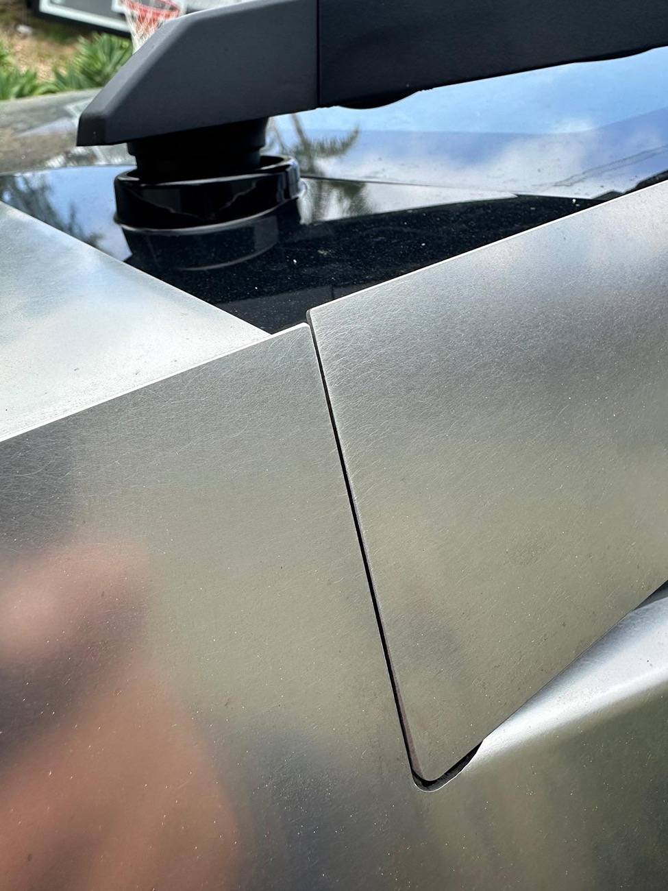

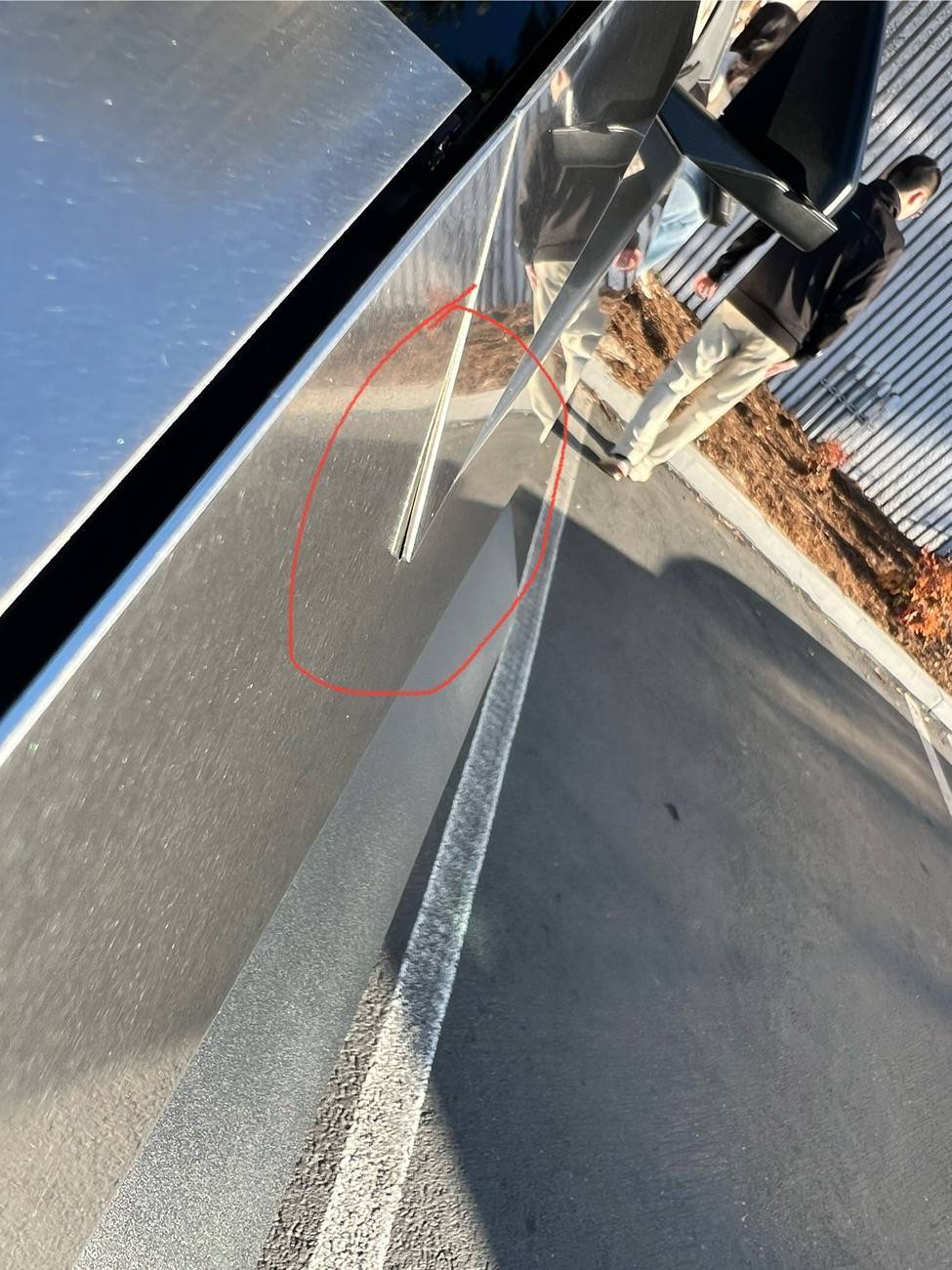

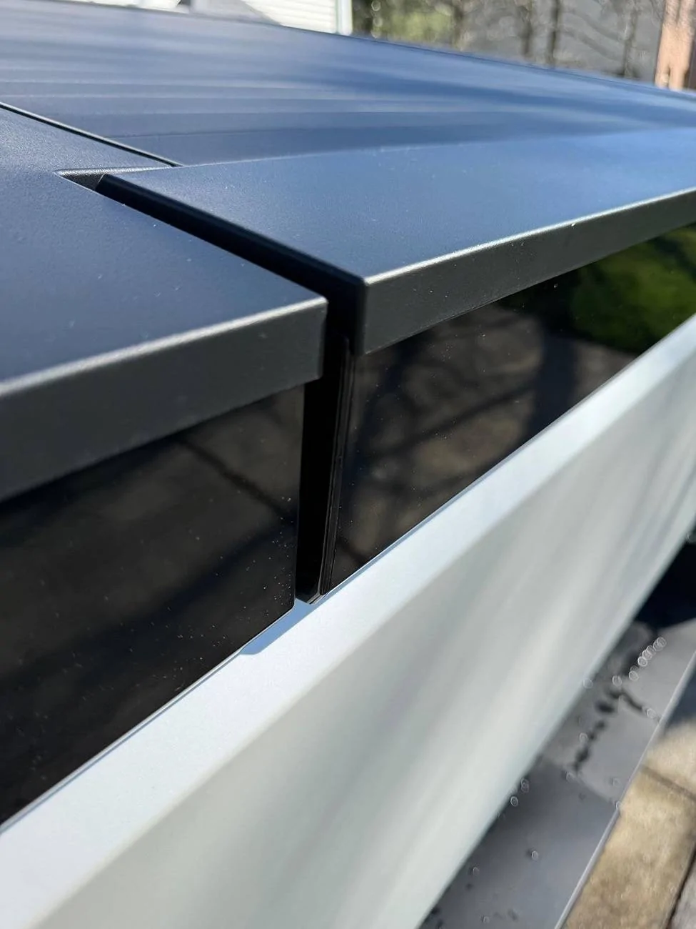

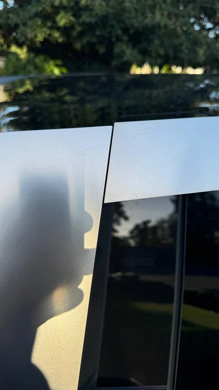

Biggest thing would be misaligned panels, especially with the recent Cantrail recall. Also, check for any lifting of the cantrail.
Tesla Cybertruck What to look for on delivery day? PICS IMG_1082
Tesla Cybertruck What to look for on delivery day? PICS IMG_1084
Tesla Cybertruck What to look for on delivery day? PICS IMG_1085
The trim at the top of the tailgate door may also be loose.
Tesla Cybertruck What to look for on delivery day? PICS IMG_1083
