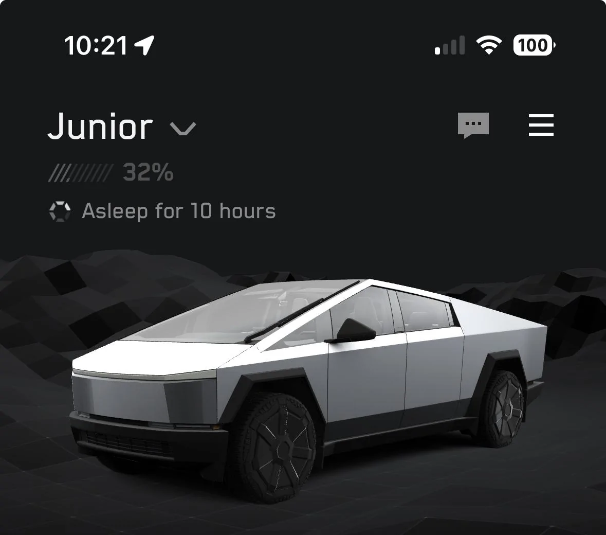

11 hours and only lost 1 mile with phone not connected and sentry mode off.

The battery phantom drain seems to stop if sentry mode is off and your phone is not connecting. When I checked it in the morning after 11 hours it went from 254 to 253 @80%. Once the phone connects to check this the battery drain seemed to start again. Need more research!

Sentry is major power suck.
But, as of about 48 hours ago, it seems like the truck goes to sleep when idle, app or not. (It wakes if you open the app of course, but then it goes back to sleep.)

I left for vacation on June 1st. I turned off sentry mode and disabled climate control. I then unplugged the charging cable. Each day I was gone I lost between 10-15 miles. Starting at 255 going down to 144. However 2 days ago I noticed that over a 24 hour period I only lost 1 mile. The same thing the next day (only 1 mile lost). I charged last night back to 255 and am doing the new software update right now. Hopefully the phantom drain is fixed!!
