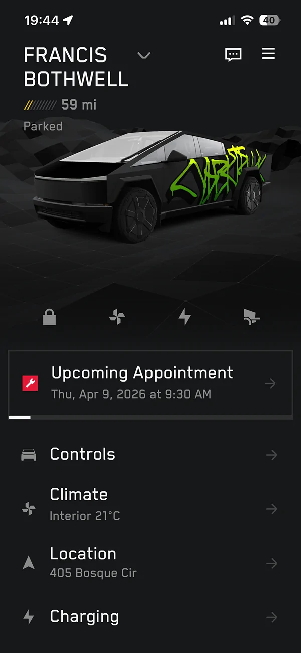

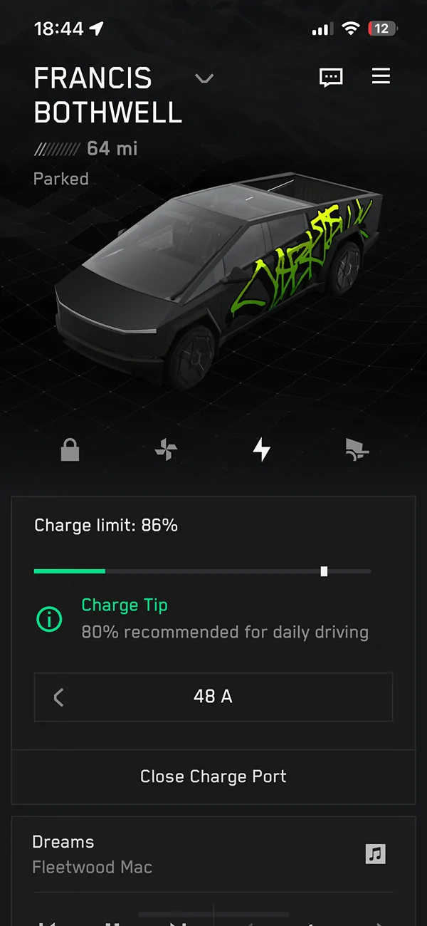

The Cybertruck ran the update yesterday and since then it seems like my mobile charger isn’t communicating with the car or Tesla app. My app no longer shows an option to start charging after I put the mobile charger in…even though the light is blue and the brick is green…anyone else having this? Tried dual scroll reset, tried a bunch of things.

On your 18:44 screen shot how did you get 48 Amp out of the Mobile Connector?

Yeah I’m not sure why it’s showing that specific number. Just realized also that the female tip of the charger in the charge port (upper left—pin deadfront) rotates now. So I guess the plastic has cracked or something because I don’t think it’s supposed to move. That might be preventing the handshake but I don’t know. Supercharger still works though.
