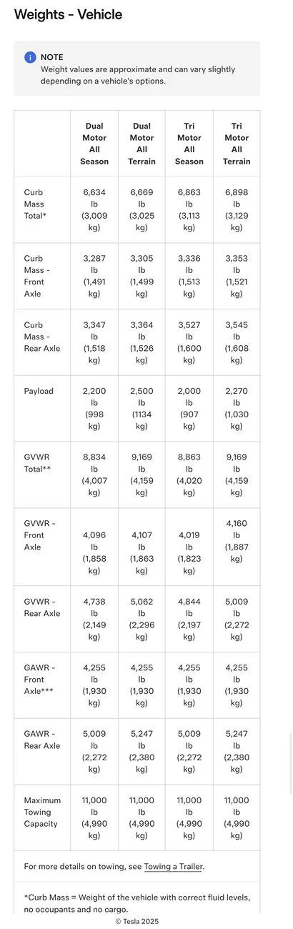

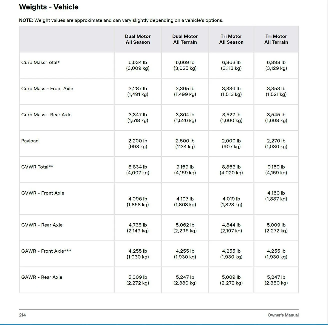

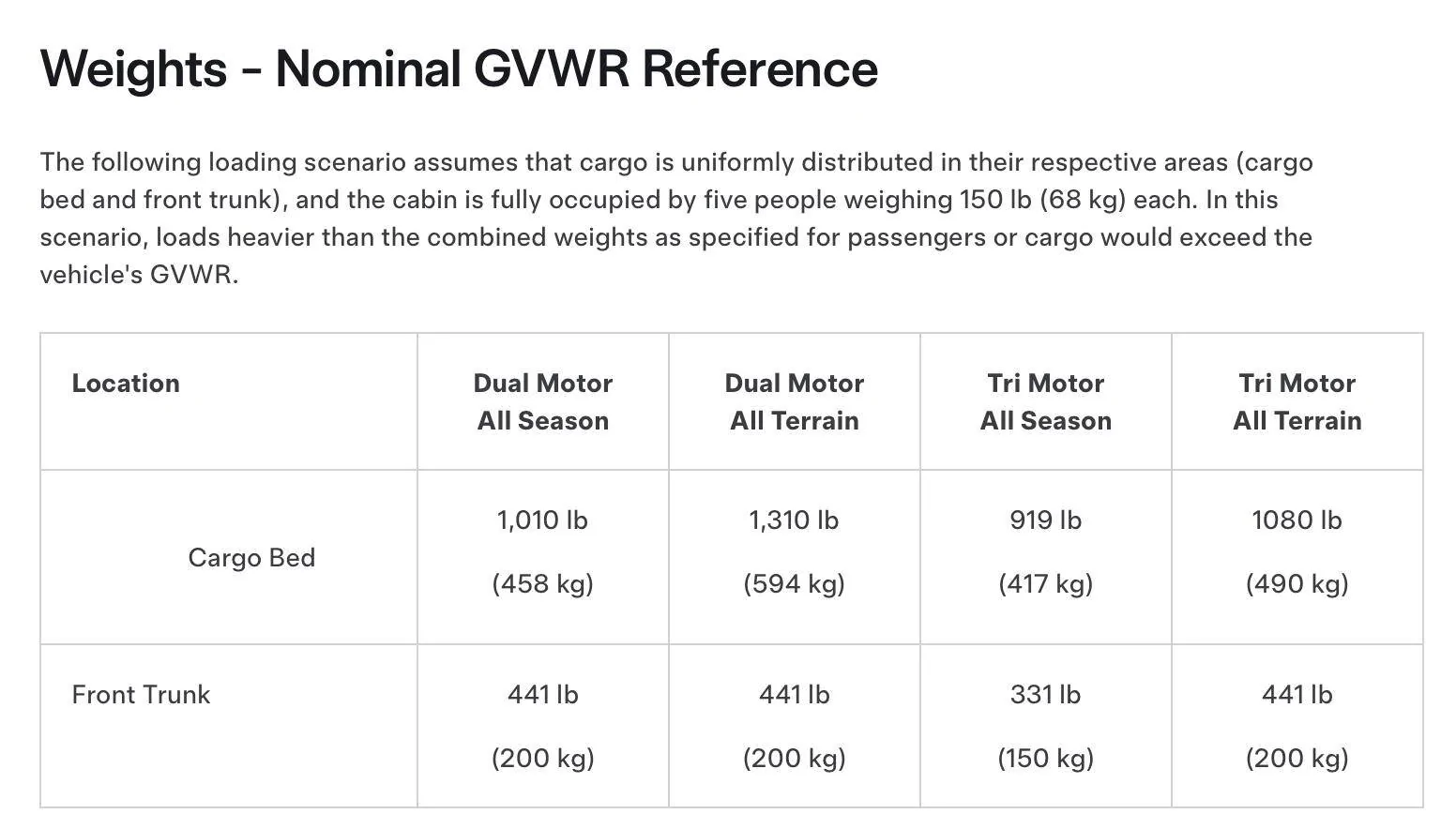

Here's the table of limits.
Stay under the GAWRs and GVWR.
Rear axle payload capacity for AWD with all terrain tires at 65psi is 1,883 pounds. Front axle: 950 pounds. Combined limit 2,500.
Mass behind rear axle loads it more than the mass itself due to unloading the front axle. Corollary, weight in frunk unloads rear axle (slightly, max of ~35 pounds at 441)
Mass in front of the rear axle loads each axle in proportion to the relative distances.
Hauling bulk goods in a trailer allows for much more per trip.
https://www.tesla.com/ownersmanual/cybertruck/en_us/GUID-12A976DD-EB60-431B-AFF1-5A37E95006DB.html
So I think what you’re saying is to move the gravel towards the cab end of the bed to more evenly distribute the weight and you can increase the load.
What I would like to know is under a stress test, what will break? What’s the risk?
