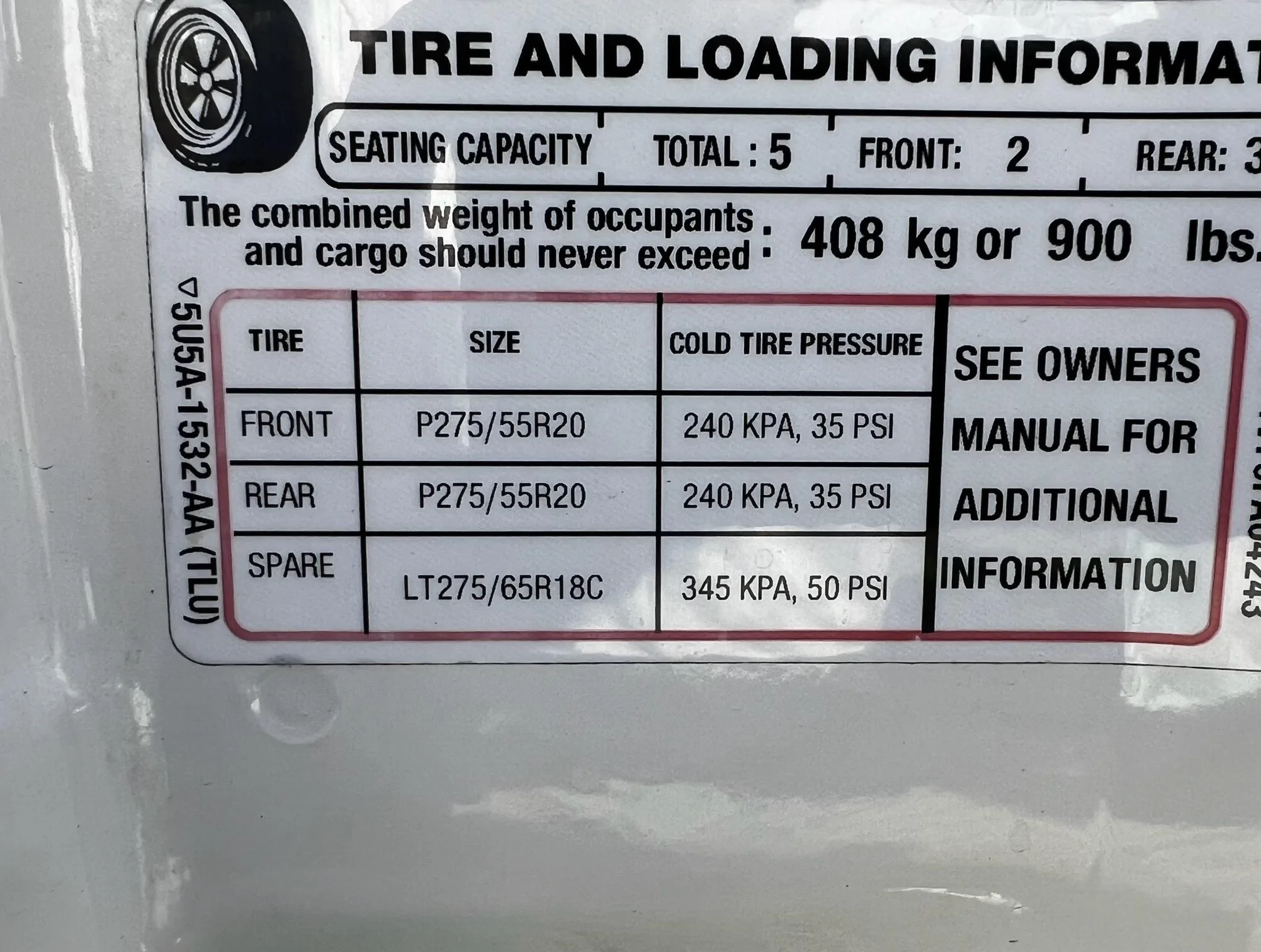

Your payload is your GVRW minus your GVW. My truck weights around 6300-6400lbs. It’s not the HD payload package truck but it does have the extra leaf in the rear from that package. Sticker says 900lbs payload and I have had over 3x that in the bed. Normally around 2500lbs most commonly though.
So your F150 *doesnt* have HDPP, but *does* have a headline gross payload of 3,300lbs?
But yea, the payload sticker reflects the available remaining net payload of your specific vehicle after deducting:
(a) any options added to your truck, as compared to the base vehicle platform available, and
(b) all fluids, including radiator, a full tank of gas, etc., and
(c) for some manufacturers (Ford for one), a 150lb driver-occupant
From that low net payload posture, if you want to tow something you then look to the relevant towing net payload - subtracting the theoretical 10% trailer tongue weight max transferred to the vehicle weight. And THEN recognize that after tongue weight net number might only work, technically, with the right type of hitch that works to distribute the 10% to the ~entire truck as opposed to only loading the rear axle.
So yeah, a Platinum trim will almost always have the worst possible net payload, esp for towinf Especially if equipped with the 36gal extended range fuel tank (~230lbs alone). Especially if equipped with eg the 22” wheel/tire (for both weight and load reasons).
It’s for these reasons that people who seek to configure 1/2 trucks to use as duty vehicles, are not looking to higher trims (least of all Platinums), but instead low trims like XLt and work trucks, and 18” rims not 20”/22” rims, etc.
Ford doesn’t even offer HDPP in higher trims (see earlier comment about OEMs increasingly neutering 1/2 ton lineup duty, and segmenting towards 3/4 ton as their ‘real’ duty offering).
And as someone mentioned earlier, will be interesting to see the various Cybertruck net payload after configured / wet numbers.
Some of that is what is shown in OP’s chart. CT Premium wheels weigh more than the base wheels, etc.
And of course, particularly heavy CT options like the Range Extender and forthcoming wireless charging offering can work to really slaughter the true net payload. Add a spare tire, molly panels, lightbar, etc., and …
