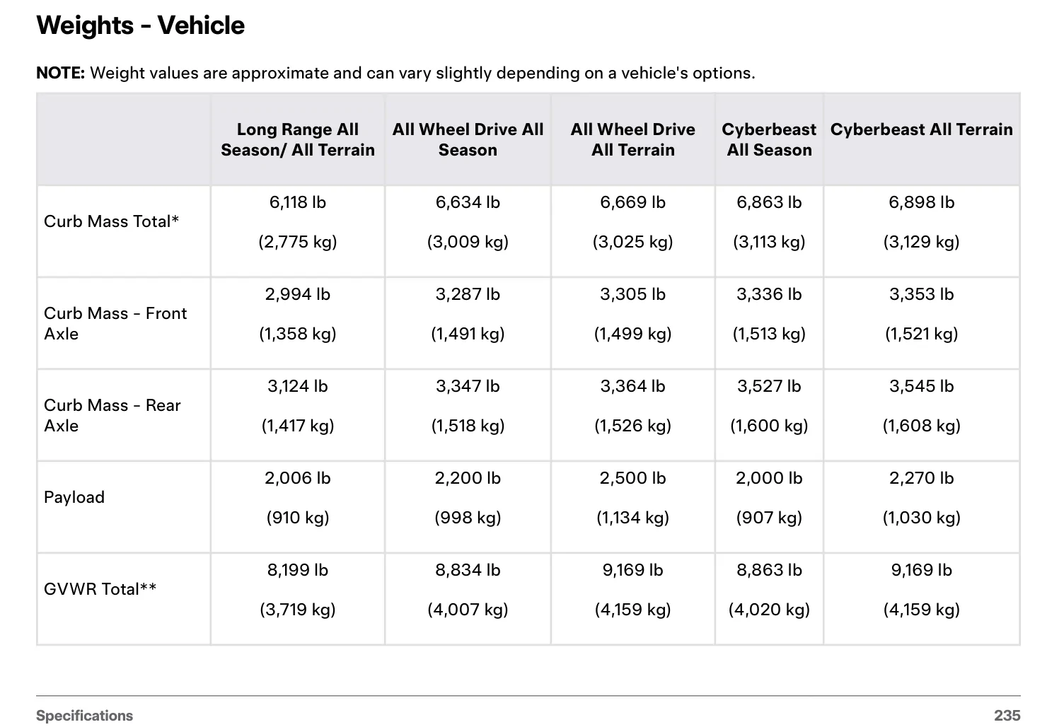

I believe the 18" inch steelies and tires is similar or same weight to the Cyberwheels and tires.
Below are the vehicle weight in old user manual that listed RWD specifications:

Not sure the weight of the 18" wheels itself, but based on the table. AWD All season tires which is the core wheels compared to all terrains which come with Cyberwheels is 17-18 lbs difference at front/rear axles, therefore calculates to 8.5-9lbs difference each wheel/tire.
When RWD was available, the option wheels were the Cyberwheels with All terrains. Table shows same curb weight for the Long range RWD with either All seasons (standard 18") or All terrains (Cyberwheels).
According to tirerack they list weight as:
Goodyear Wrangler Territory HT 285/70/18 = 40lbs
Pirelli Scorpion ATR 285/65/20 = 45lbs
Goodyear Wrangler Territory RT 285/65/20 = 55lbs
Steel wheels are pretty heavy so very possible its 15lbs heavier than alloy, thus Tesla listed the same spec.

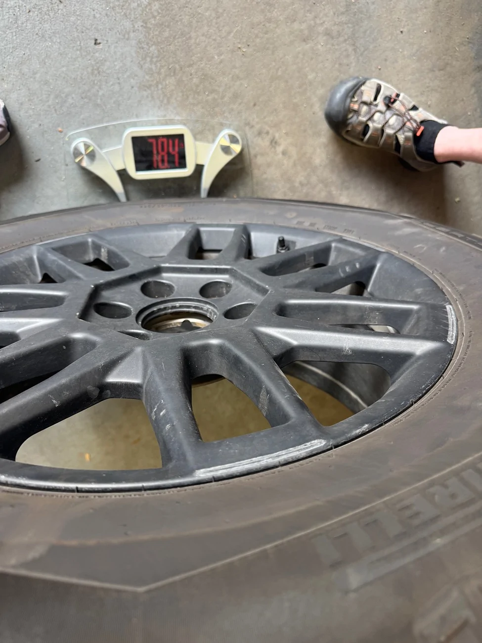

Here is the stock 20” core wheel and tire on the scale. Showing 78.4 lbs. now there are some variations from wheel to wheel but this gives us an idea. Now we need someone with the 18” set up do the same

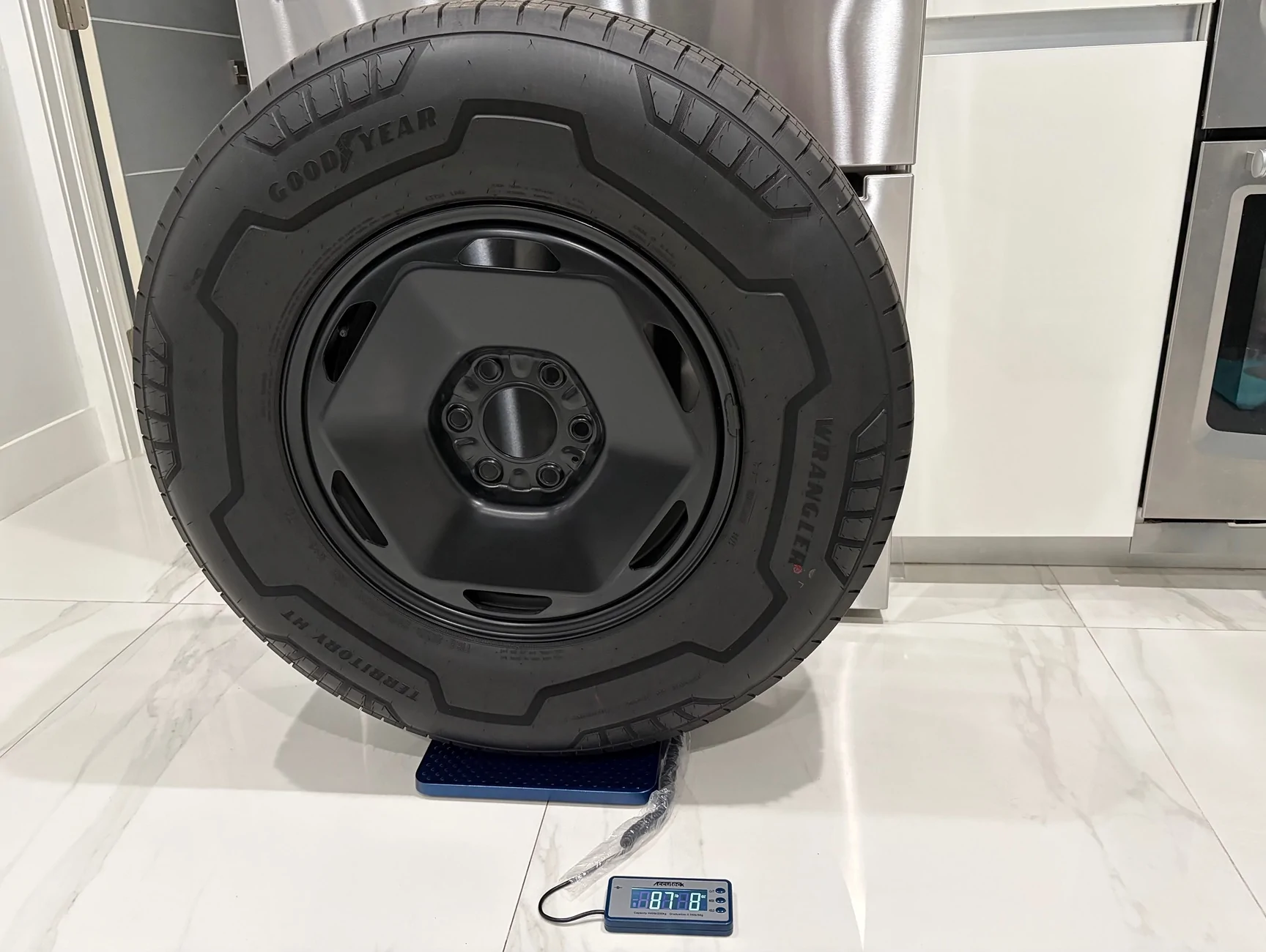

Happy to oblige!
