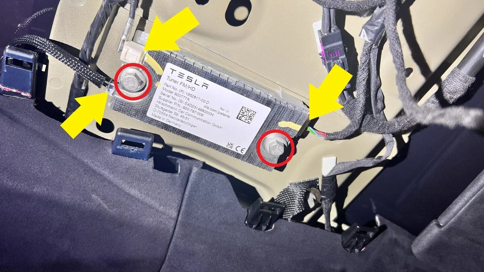

I'm confused. There is a radio in the CT? I know there is a built in app for tuning in FM stations virtually over the Internet but I thought we don't have an actual FM (or AM) radio. We do?
10,253
33,952
The FM tuner is part number 1852817-00-E, under the front header trim (driver-side, I believe):
Tesla Cybertruck 2026 AWD CT w/Poor FM Radio Reception GUID-565541E7-64A1-433A-B4BB-F0994AD13E9C-online-en-US
I'm not sure where the antenna is, because the R&R procedure in the Service Manual is "under development". :LOL:
