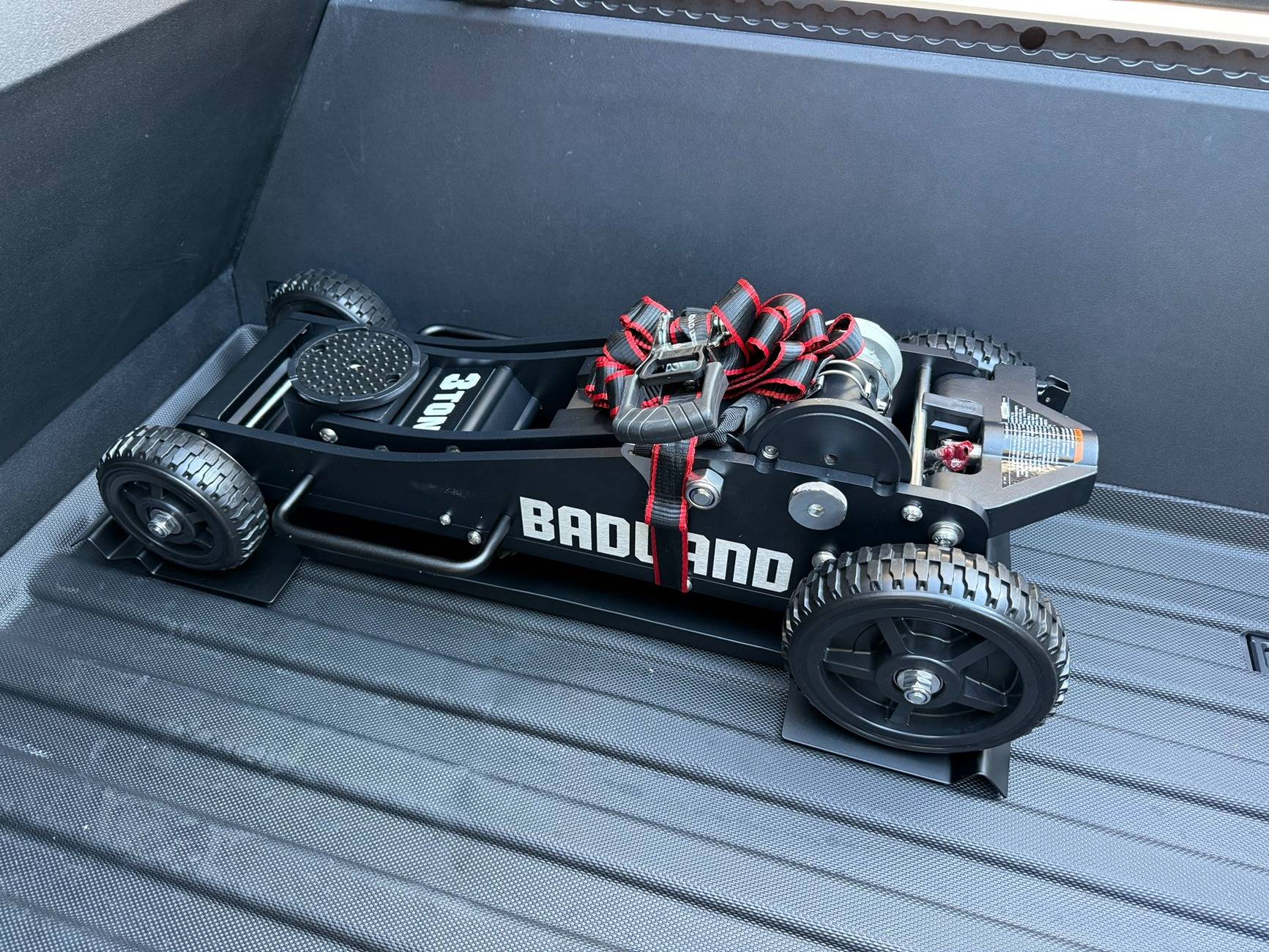

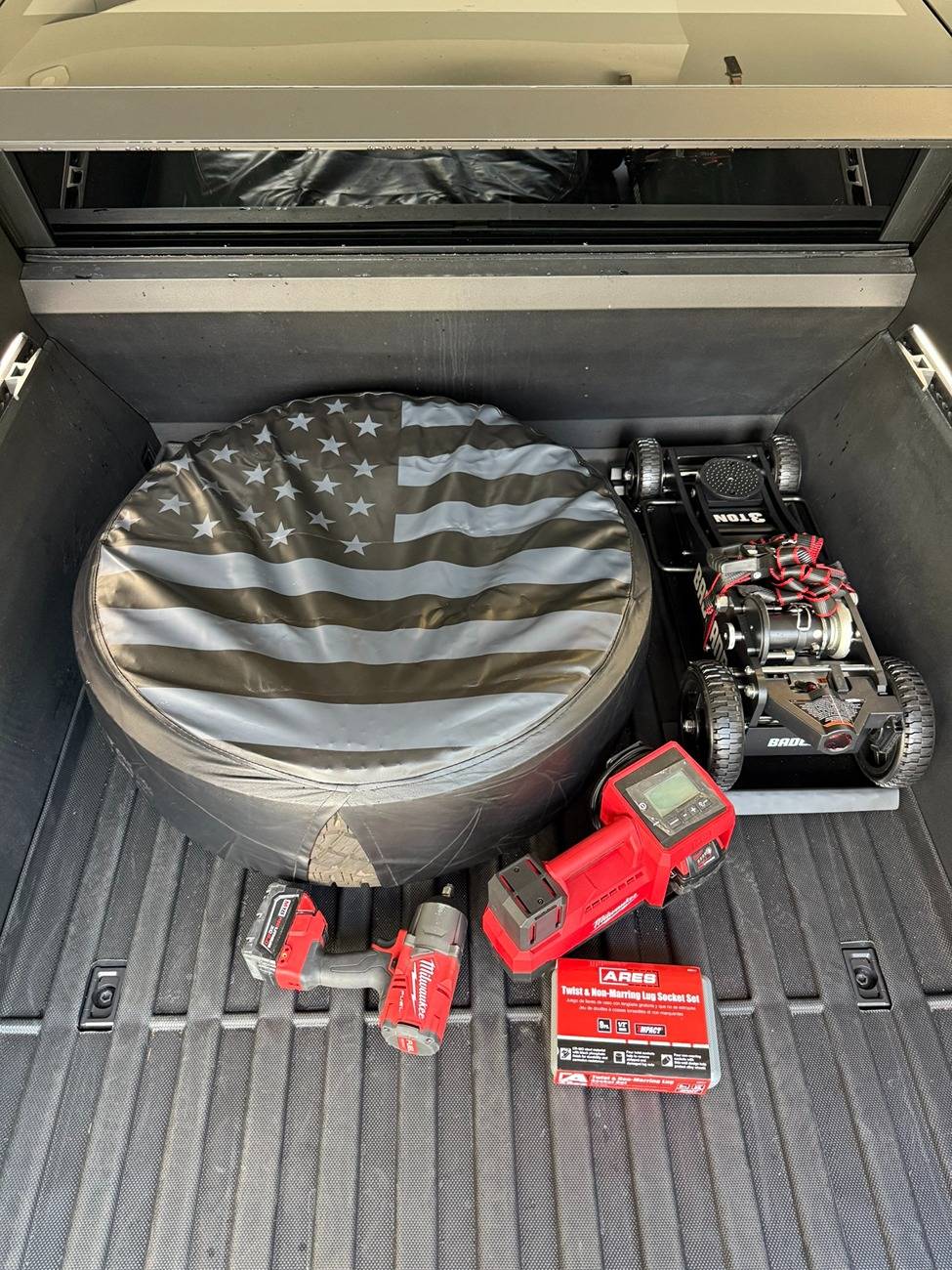

The tools, I already had.
1: Brand new Cybertruck wheel, tire, and TPS - Facebook Market $500
2: Badland offroad jack - Harbor Freight Black Friday Sale $250 (I made the mount plate for it, got it powder coated and I laser etched)
3: used Milwaukee impact (tool only)- Facebook market $140
4: new Milwaukee tire inflator (tool only) - Facebook market $120
5: flip up bed tie down (2 pieces) - Amazon $27
6: Ares lug nut socket kit - Amazon $35
7: spare tire cover - Amazon $17

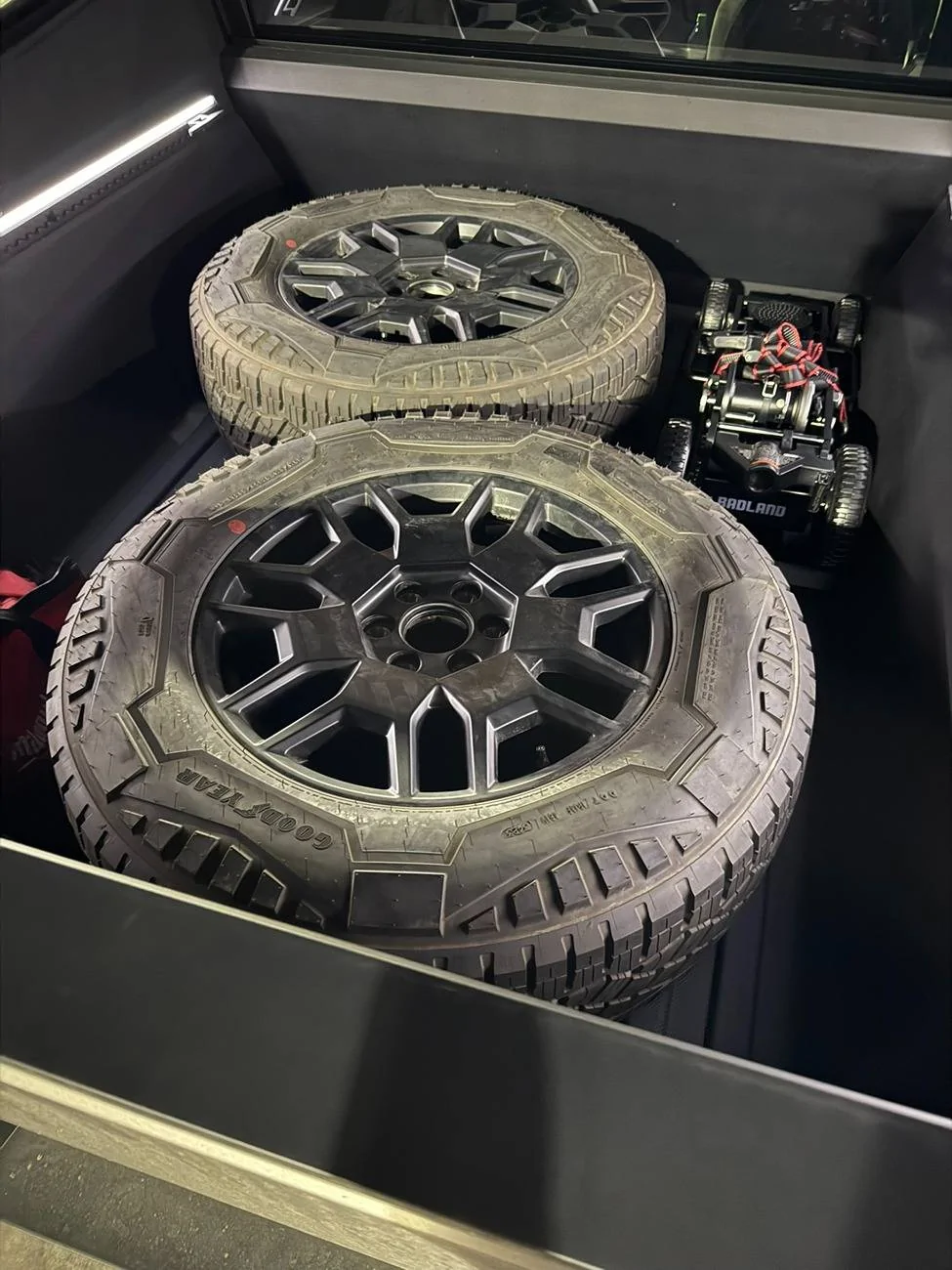

This setup is going to be used primarily for road trips. Prices will vary, but saving at least $200 from the Tesla kit. I like my setup better. The second spare belongs to a friend. We got a deal for two and I was picking it up.

Great setup with upgrades and ways to save some money! Did you use a metal brake for your mounting plate and what did you use to “soften” the corners and notching out for the d-ring mount?
Does your bed mat seem to keep everything in place or is the tie-down strapped to the d-ring? I could see incorporating a bracket to bolt into the d-ring mount if there was a concern that would allow the d-ring to be mounted over.

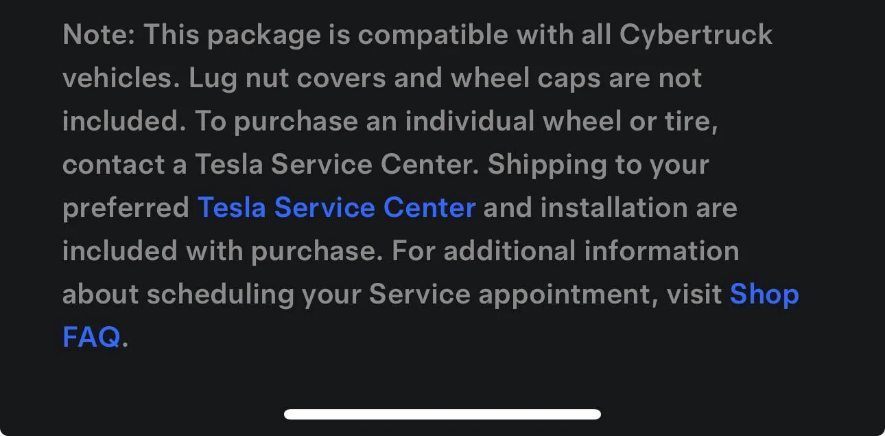

I’ll probably get a set of winter wheels/tires next year and use one from the other set to take along for certain trips. Even though I don’t expect to buy a dedicated spare, outside of FB Marketplace, eBay, etc, I’m curious Tesla will sell a spare tire/wheel outside of their “kit”. I saw this statement on the winter wheels/tires package.

I thought about aluminum, but of course, it had to be stainless. This is 0.050" thick, so it was a pain to bend. I just strapped the jack down. The tools went into the lower bed compartment. I do need to strap down the spare. It didn't hit anything, but under hard acceleration ?, it does move around a little.

Curious if you tried the impact on your lug nuts yet. My DeWalt impact couldn’t break the torque so I bought a breaker bar.

I haven't tried it on the truck, but works fine on a Model 3. Tesla's torque specs is definitely more than a typical car. About 80ftlbs versus 130ftlbs

Just read the manual. It's 151ftlbs for the Cybertruck, so it shouldn't be a problem for the Milwaukee

yeah, the instant torque of the Tesla motors I’ve read is what requires wheels with more torque than most other vehicles.
