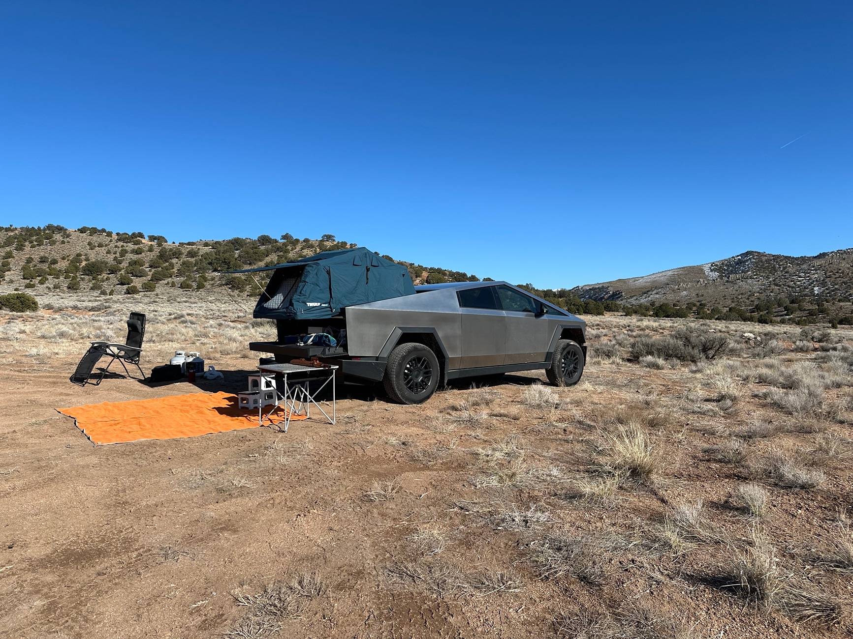

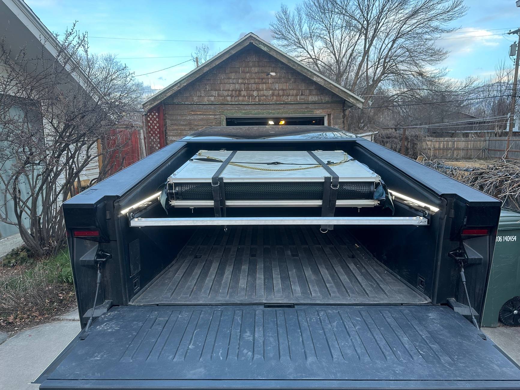

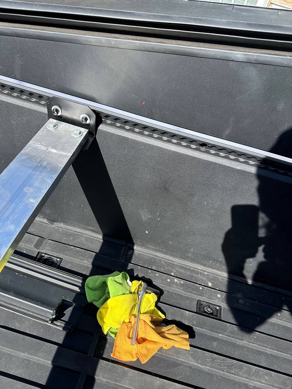

How is the blue tent attached? crossbars on the L track?
Yes. Used rectangular tubing and some angle irons. It is a Thule Low-pro 2. That is the only RTT that will fit. I got it to clear the tonneau and open and close without removing the aeroflap. Fits like a glove. Slick. clears the bed by 14.5“. I’m proud of how it turned out. Literally takes about 1 minute to fold it up and secure.
...It folds up slightly trapezoid or do you have to stowed at a tilt? I'm amazed at how well it's fitting.
