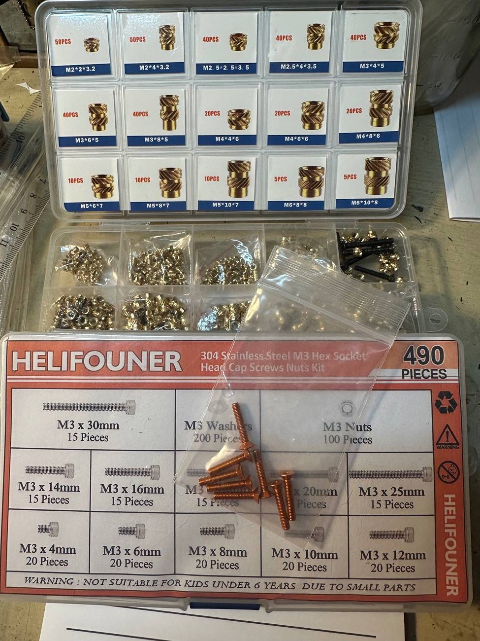

I can't upload files.. maybe DM me and I can send someone the files to post sorry ..
you might need to adjust the size of the holders to your like and fit of your choice of cleaners.. I have them set for P&S / Chemical Guys you will have to resize them for say Gtechiq bottles..
I found the best way to mount them was to drill the mount and cup in place to insure proper alignment . Use your soldering iron Inset a threaded insert into the back of the cup and use a 14mm long screw through the printed mount to hold the cup to the Factory Telsa Gear Locker divider.
