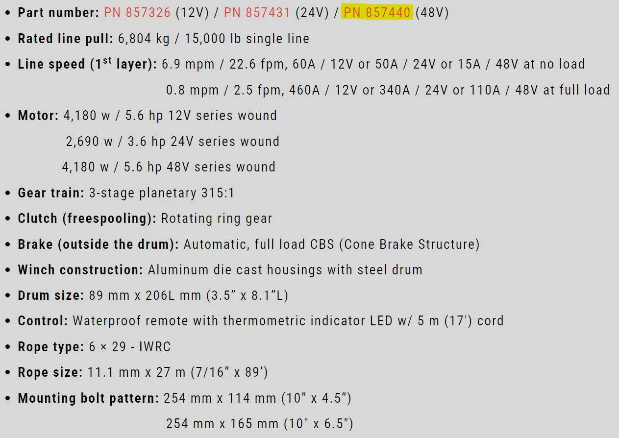

Taiwanese, actually. They may actually have 48v winches available like their site says [part number 857440], but I'm sure very few people inquire about it and there is a bit of a language barrier. I doubt they would go through the trouble to list a part number if they didn't actually make it. I certainly don't know because I haven't looked that far into it. Just a quick search.
Both Warn and Superlift do outsource their manufacturing to China, however, so the point is a bit moot there. In any case, hopefully some of the big names will start manufacturing them soon.
The difference is performance, quality and support. Plenty of alibaba sources for things, but that doesn't make them equal to other products. This is my point. We are high confidence in what we sell - we've tested, proven, and 100% stand behind it and support it. Warn is an OEM-grade winch. Superwinch is a value option, but still product and brand that we can stand behind and get support from Superwich on.
There is no good point in trying to source a 48v winch for Cybertruck because the Cybertruck 48 aux circuit will not handle the spike loads and duty cycle from a 48v winch; we have tested and proven this. So if we decided to run a 48v winch, it won't be plug and play - we'd end up replicating our T Sportline auxiliary power system and simply setting it for 48v instead of 12v -- the exact same system solution - very easy for us; if someone wants a high load 48v auxiliary power option, we can do that today.
The root problem is Tesla uses a dc converter for 48v (it is not a 48v battery); it simply isn't spec'd to handle spike loads nor can it handle sustained high wattage run times - plus it's only a 400w max power feed, that will never run a winch. The 48v winch screen shot you show is 4180w, ten times the load a Cybertruck can support.
you seemed to have missed the part of my post where I said:
And there are plenty of 48v accessory batteries and charge controllers available on the market that could be tapped directly into the frunk accessory port. The 48v accessory rail can be used to charge/maintain the 48v accessory battery.
I already knew that the 400 watt limit on the accessory rail couldn't support the surge required to run a winch.
Maybe the most popular manufacturers would be open to pioneering 48v winches, but I doubt many people have reached out to them asking for it. That's my whole point here. Running at higher voltage means lower mass and lower amounts of copper since you don't have to crank the amperage up to absurd levels.
