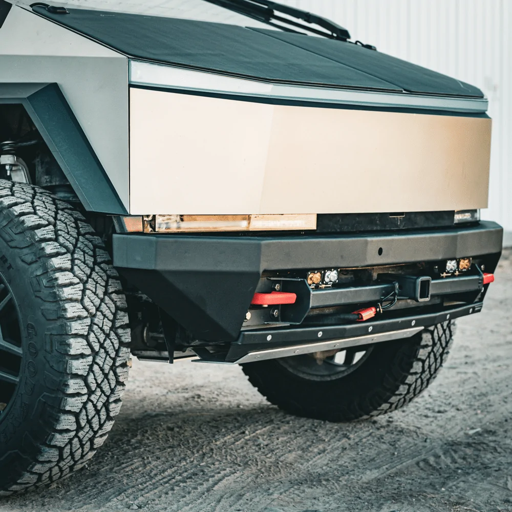

Great solution if you can find a 12,000lb winch for the truck that will run off the trucks energy, but our experience is that a winch draws much more pawer faster than the truck can drop through the back.
So, where are you getting the 12v power for your 12,000lb winch?
That is likely to be well over 100A, which is only 1200 watts.
If you can find a 240v AC motor for the winch, you can get over 10x that power.

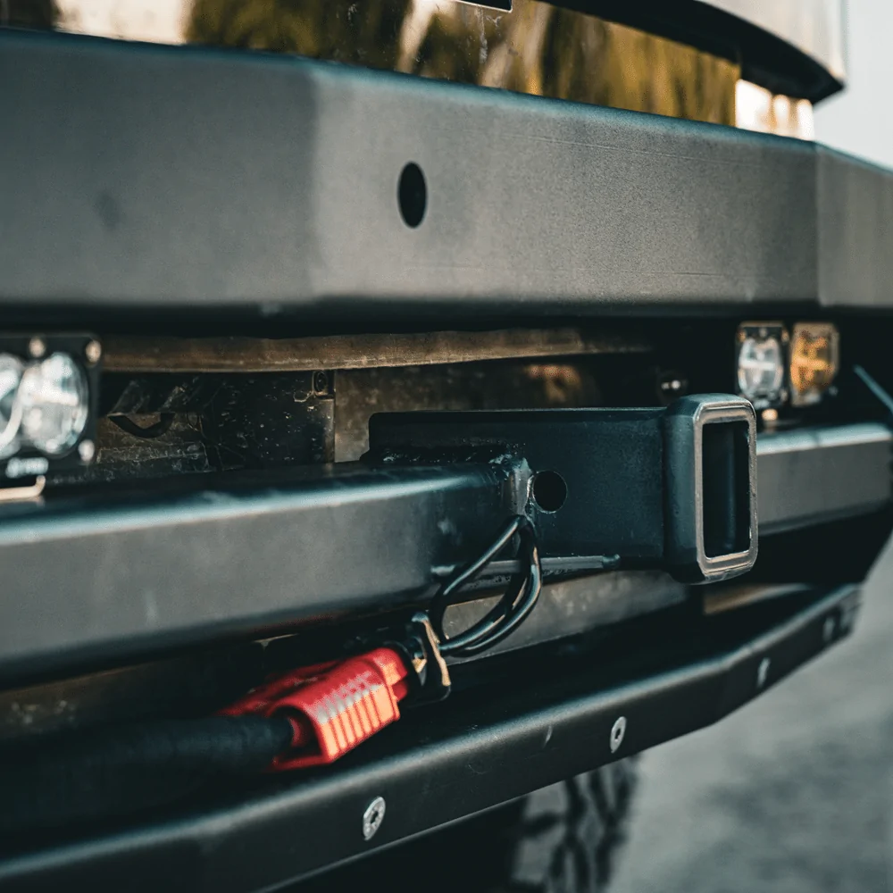

We used a H9-AGM mounted in the Frunk with a anderson plug hidden in the bumper

I take it there is also a battery charger? (where does it get it's power?)
We ran a line from the rear to the front and on the Rubicon rig we charged off the solar hood, it never needed the vehicle power. We charge $1000 to put it together as kit with mounting brackets.
The guys at Tesla, who gave us this idea, just had the battery loose in the frunk and had a battery tender type deal in the bed if they needed to charge it on the trail.

This seems like a great way to load any number of things on the front. You could have a bull bar, winches, plow, removable light bar, or whatever.
Is there any information on the amount of vertical load that these points can take? I'm sure the horizontal load is commensurate with the weight of the truck, similar to the rear point.
