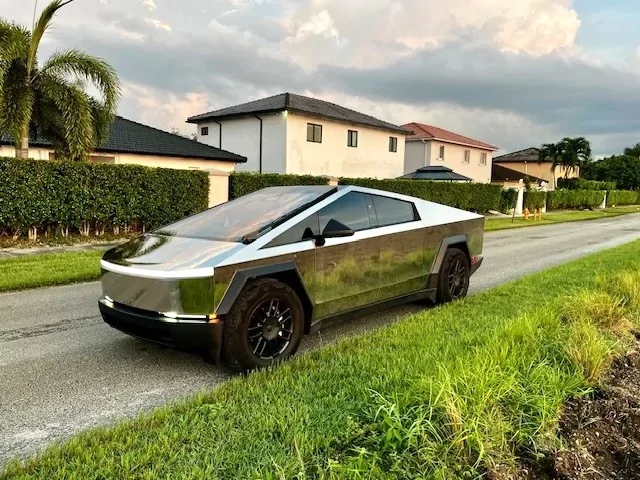

I used Renegade products and Dewalt grinder. The project took about 3 days to complete. Very messy metal particles get all over you in the process. Need respirator and mask, gloves.
Tesla Cybertruck My Cybertruck DIY Polishing Results After 3 Days Cyber Polishing (2) copy
Did you really use a grinder? I hope not.
Use a random orbit sander with a 5 mm orbit and non-woven abrasive pads (if you want to match the factory finish). I haven't noticed any metal particles (but I use a vacuum connected to the sander).
It comes out looking better than right from the factory!
I’m guessing he did since there were metal particles getting all over him. Normal amounts of depreciation weren’t enough for this guy!
I mean if you’re polishing into a mirror I don’t think the random orbit sander matters does it? Your not trying to get any specific grain in there

OP did you use anything to “seal” the finish? I’ve read up on diy and people always mention sealing it when done

Looks like he's polishing it not just buffing out scratches in the normal stainless finish. So he's likely using a Dewalt angle grinder with various discs and pads with varying grits and the polishing compounds from Renagade.
Tesla Cybertruck My Cybertruck DIY Polishing Results After 3 Days {filename}
Good job...that took some effort..
I think this may have been addressed in other similar threads that I haven’t located, but I'm curious; are there any laws or issues with reflection and/or glare associated with potentially blinding other drivers on the road? Also, after polishing does it seem to be more resistant to fingerprints? It would be really cool if it was much more resilient to abrasion marks from being off road going through brush etc. Have you heard of anything related to this after polishing?
To answer the first part of your question, no. The panels all point away from direct line of site. Top half panels point up and bottom half panels point reflections down
