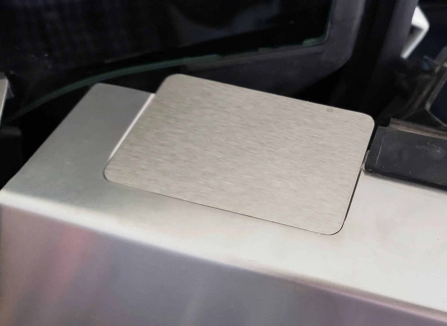

There are after market products that address the problem of covering the hole in the door when the mirror is removed. I chose a DIY approach which I hope will be interesting to others. It started when I discovered that the shape and size of the hole is nearly that of a standard credit card. I looked on Amazon and found a pack of 8 stainless steel card blanks that I hoped would fit the hole with just one straight cut. Turns out they fit more perfectly than I imagined. The link is here. The project boiled down to making a support for the SS card, cut to size, and glued in place.

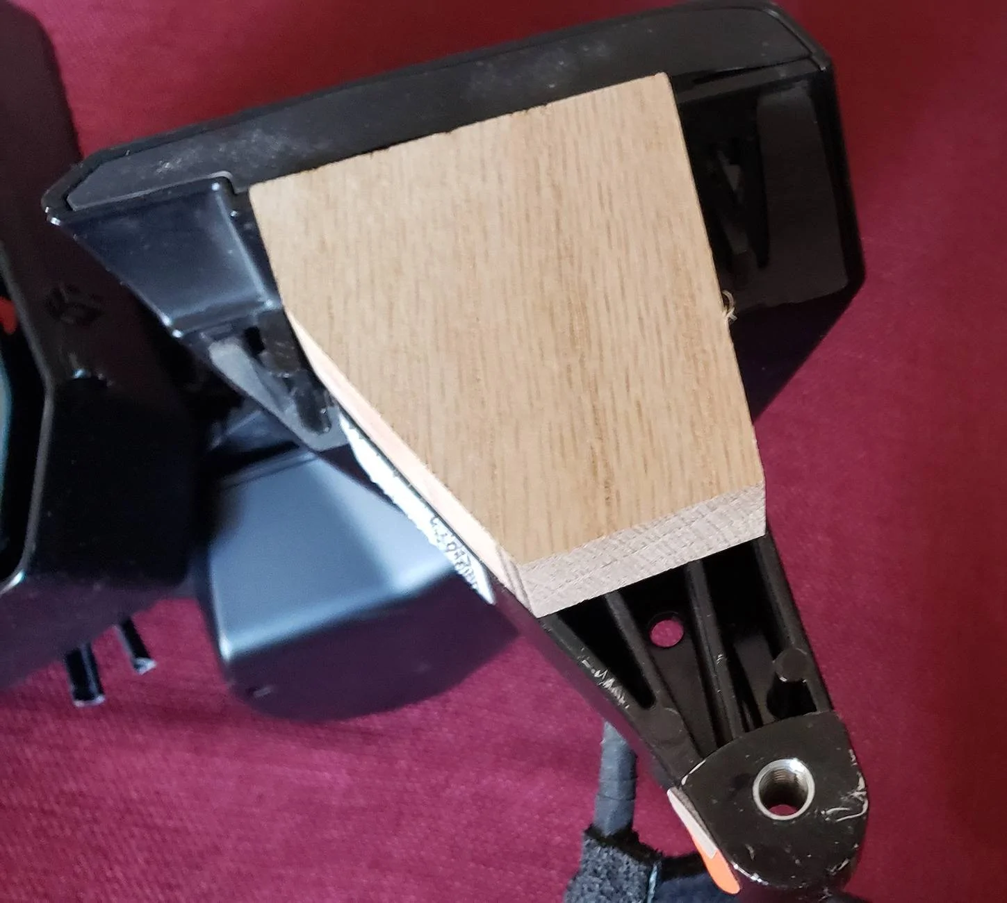

I made the support from pieces of 3/4" oak board I had lying around. I measured the angle of the top section of the door at 10 degrees and cut oak support blocks to that angle on a miter saw.
I used the mirror as a template to mark the next two cuts.

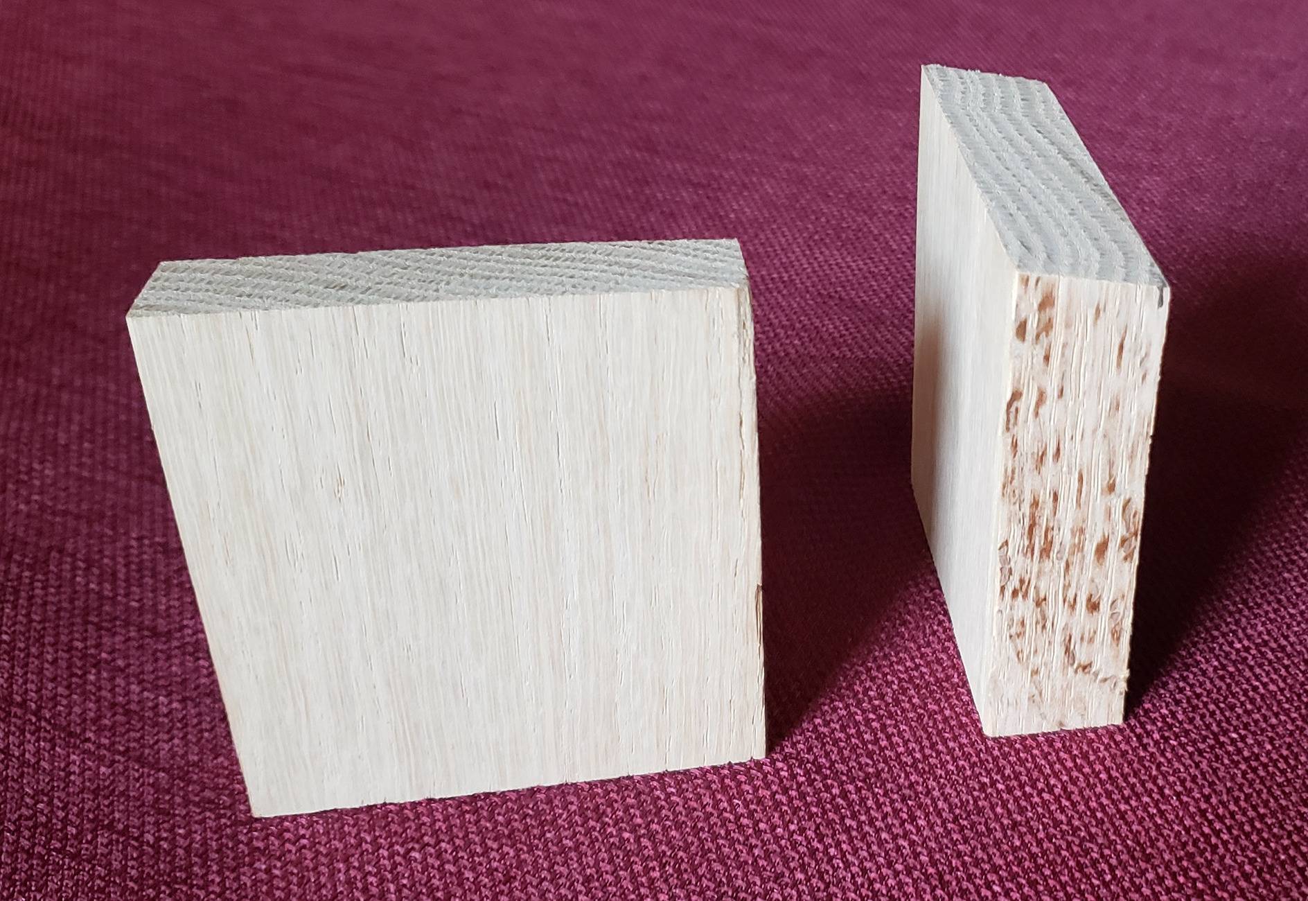

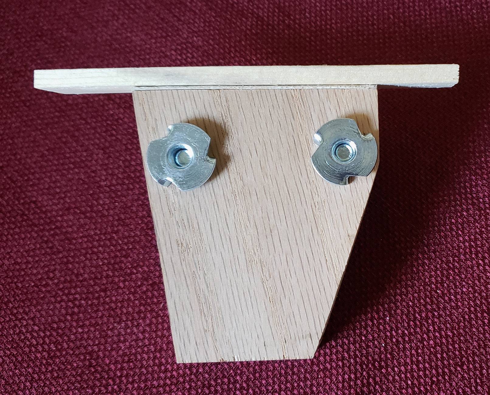

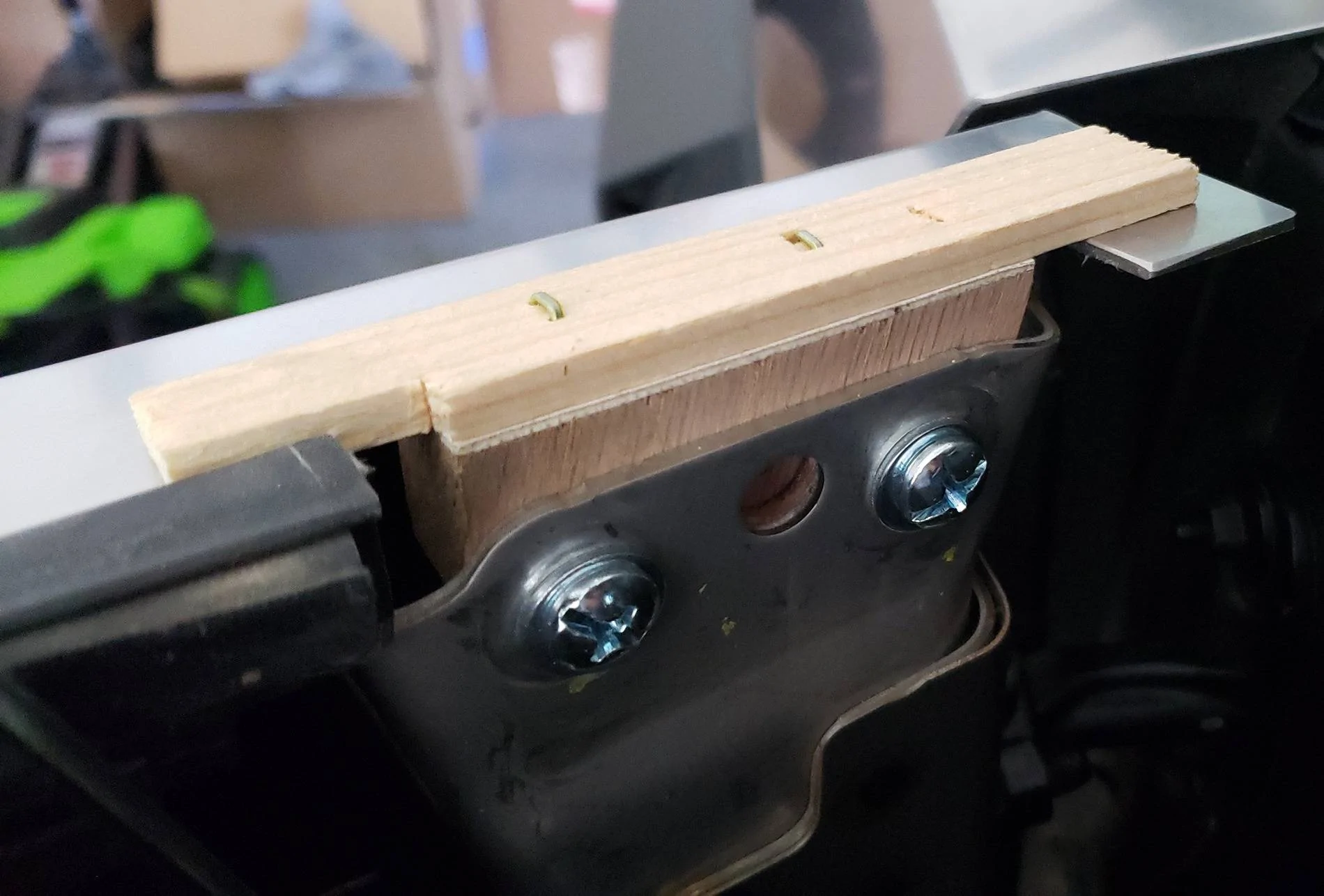

I put several layers of artist tape on the top of the block to match the thickness of the SS card, then stapled a piece of wood across the top to hold the block in place to mark the bolt holes. I drilled two 9/32" holes and hammered in 1/4" pronged T-nuts.

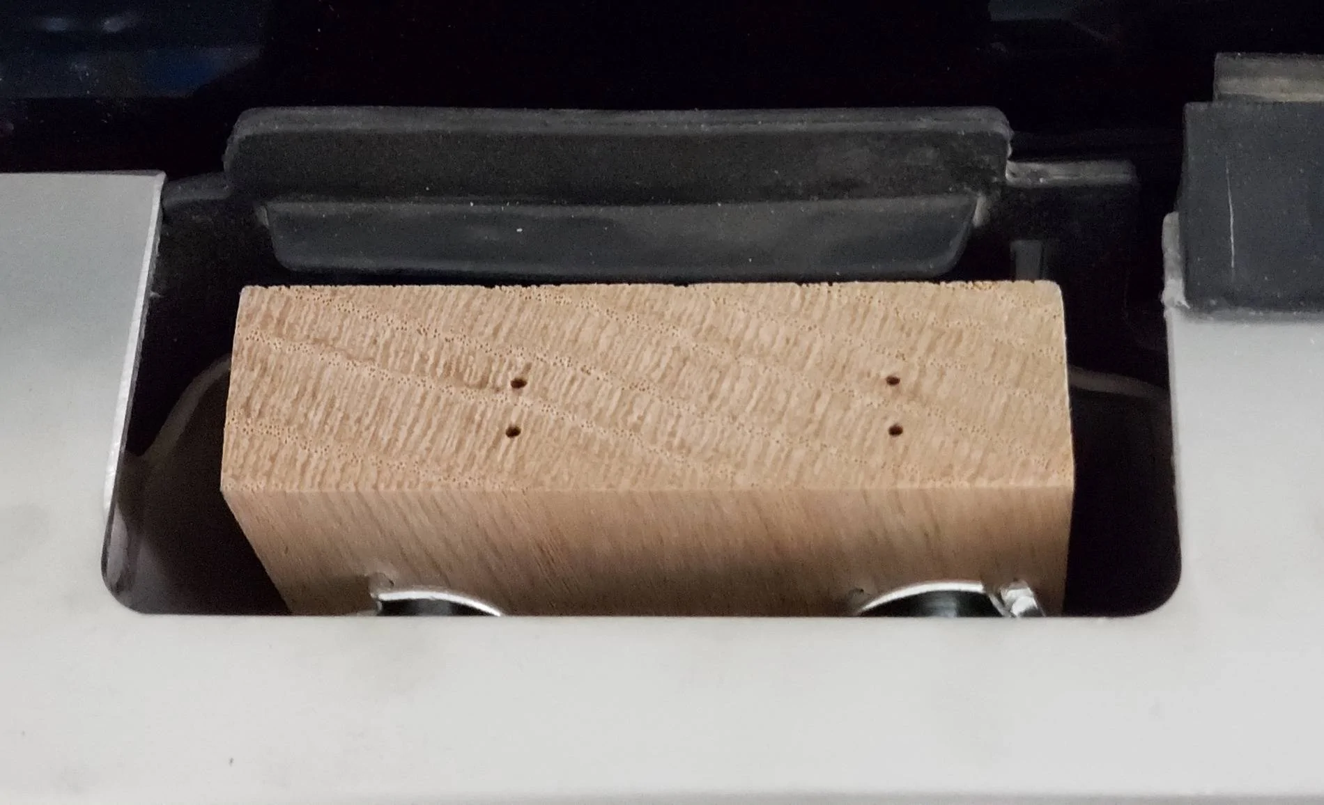

This was then bolted into the Cybertruck door. Note the recess drilled into the wood to make room for the rubber cover's attachment plug.
I then removed the wood strip, staples and tape. What remains is a solid, flat surface to which the SS insert can be glued.

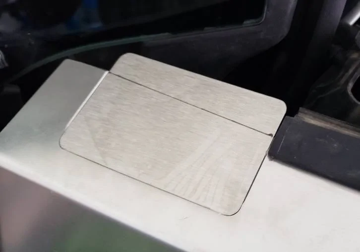

As you can see, the SS card fits the hole in the door almost perfectly.
I only have to cut off the excess material along a straight line to align with the edge of the door.

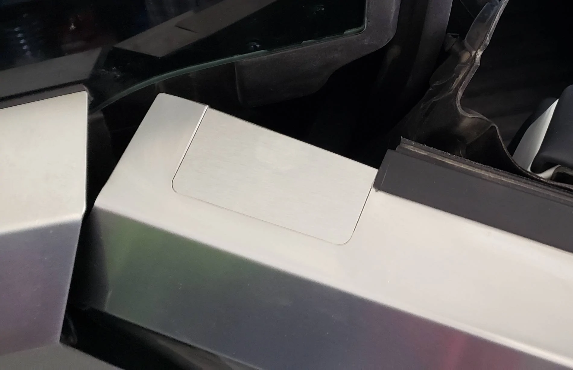

I used a grinder to cut a groove along the line until I could bend and break off the excess, then touched up the cut to remove the sharp edges.
I then used some Gorilla Glue to glue the SS piece to the wooden block. The block can be adjusted a little to get a flush surface.
The SS card is finished with a course brushed surface so it doesn't blend in with CT's surface perfectly, but I don't find it objectionable.

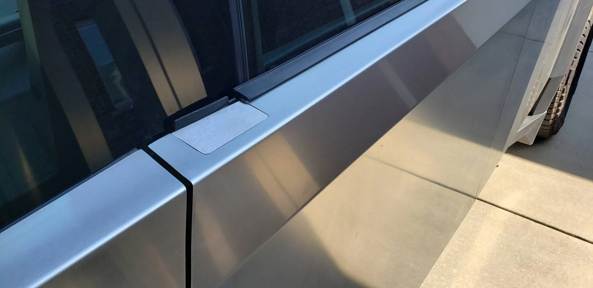

I will do the passenger side the same way.

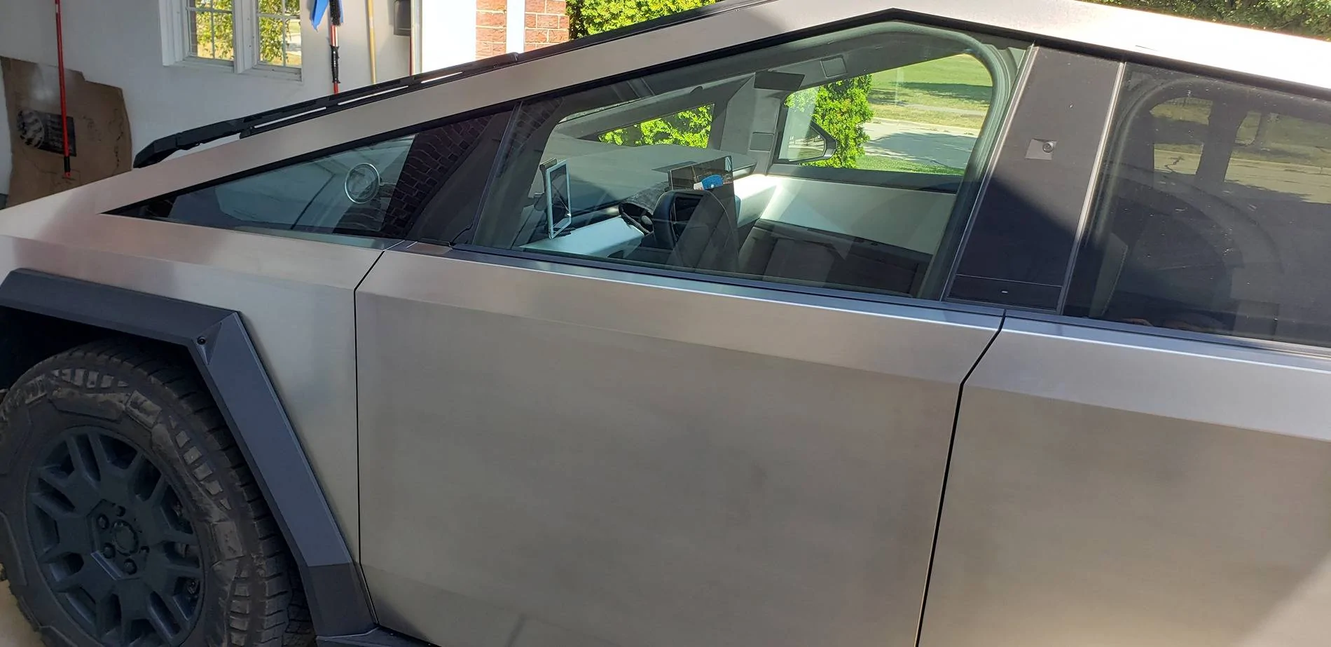

Here's a view from a distance. Not bad. Some rubber trim would make it even better.

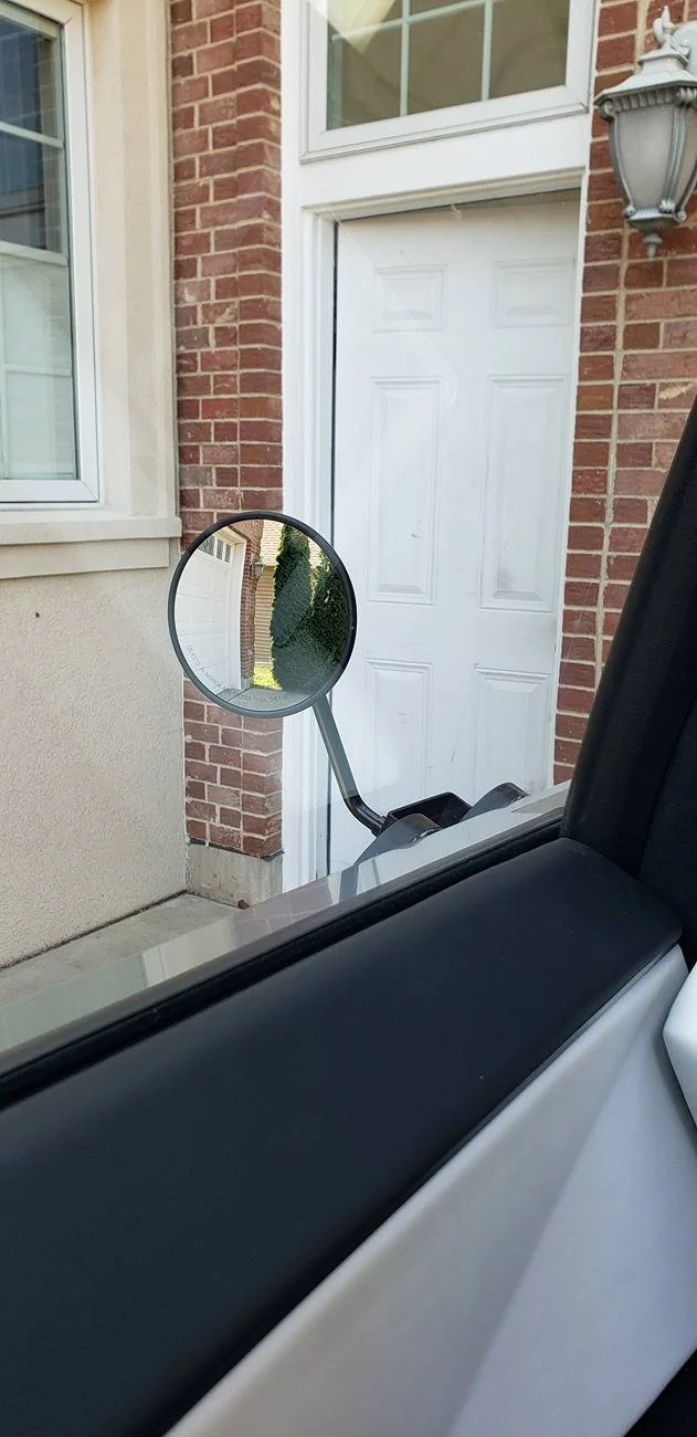

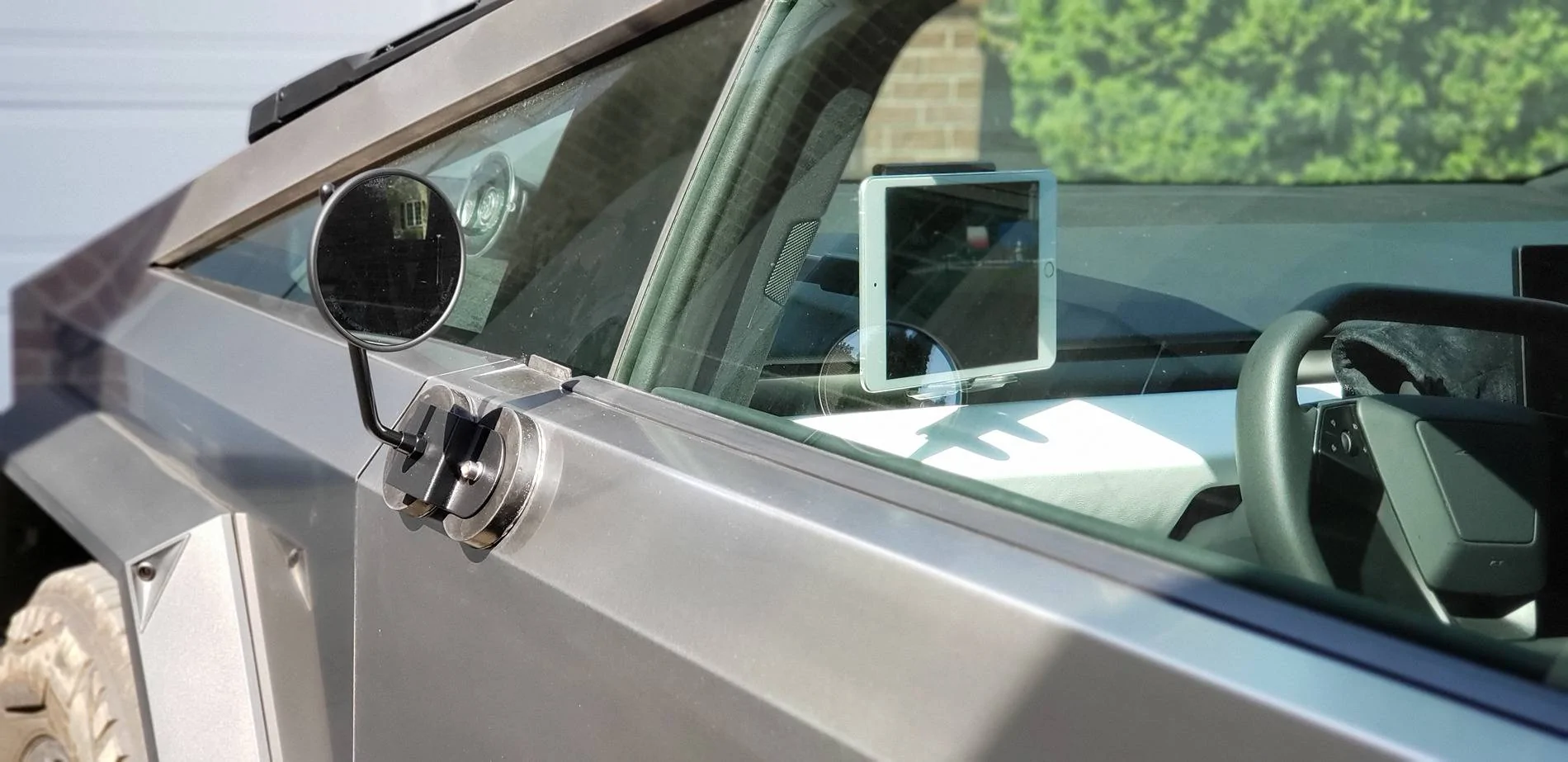

When I'm required by law to have a side mirror, I'll slap this ugly accessory on the door to avoid being cited for an equipment violation. It's a 3 1/2" motorcycle mirror attached to the truck with a strong magnet. Tesla's SS is magnetic, but not exceptionally so. I haven't tested it yet at speed on a rough road. The mirror is large enough to meet Canada rules when I take my dream adventure trip to Alaska. Needless to say I won't be using this mirror all that much. I called it my "compliance mirror".
And here's what it looks like while driving. It actually works. I'll mount these mirrors when someone else is driving, like if I bring the truck in for a service appointment and a Tesla tech needs to do a test drive. Mounting the mirrors would be the safe thing to do.
